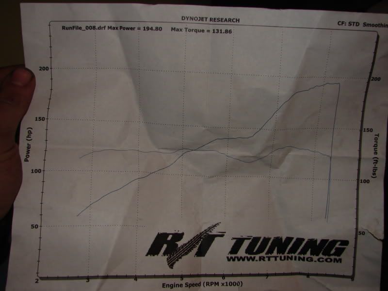

I finally got my car tuned and have to say I am disappointed with the results. I feel like alot of other similar builds resulted better than I did.
194.8 WHP 131.86 tq redline is at 8400 vtec is at 6500
Basic run down:
82mm GSR block
12:5 comp.
Ported and Polished GSR head
Valves/Springs/Retainers
Blox stage 2 cams
Fully bolted minus a throttle body.
2.5 Exhaust w/ Hytech replica headers.
Hondata s100
Comments/Thoughts?

Thats really good i think for NA. especially with no building on the bottom end

What kind of dyno was it?

I only used the stock rods because the cams didnt get good reviews on power past 8500, so I didnt plan on revving it to the moon. Taking it to 9k would barely put me a the 200 whp mark based on what the sheet looks like. Although it wouldn't surprise me if others bull**** their dyno results.
The dyno was a dyno jet.

Every dyno, tuner, day, is different so you have to take that into factor. How much more did you think it was going to make?

So you used cams that didnt get a good review for high revving,with a high revving motor?

No what I should have said was the power band on the cams wasn't at motorcycle revving limits.
Similar builds that I basically coppied off of made a minimum 200 whp. Im not trying to bitch about anything, I guess its more of a me wanting to make sure this is normal.

Like i said, every motor is different, every dyno is different, every tuner is different, the correction factor could be different, air could be different. If you were supposed to make 250whp and only made 190 i'd be concerned but if you made 190 and were expecting 200whp then that could be based off the things i just mentioned.
Have any videos of the dyno runs?

Every dyno reads differently. The only way to know whether you got real gains or not is to get a base dyno before the mods or tune.
Exactly^
What correction factors were used on the sheet?

And if it makes you feel any better people on my Evo forum have based dyno'd 50 WHP less than what others have because some dyno's read very low.
Don't get too caught up on the numbers. The most important thing is your butt dyno and how the car feels.

He is right,you cant compare dyno sheets based on so many variables that can change.

Only number that matters is what it does at the track. If you like the car be happy with it.

Go to the track and see what you trap.
You do know you can make a "300whp" car read over "500whp" if you calibrate the dyno wrong haha
As long as you enjoy driving you car, who cares if you cant beat a C6 in a straight line haha

All of what was said is comepletely true. The car still rips and is a thrill to drive. Vince at R/T did a great job, and was pretty damn informative. Feburary when the track open I will see what she runs and go from there. Maybe Ill change out cams and build a B20 bottom end after I get bored of it.

almost 200whp from a b18 w/ bolt ons and some head work? I'd be pretty damn happy with that.

Exactly,there was no bottom end workk and you limited the revs. so how much were you expecting

I have different pistons 12:5 comp. Its not a completely stock bottom end. Its bored to 82mm too.

thats really good. when i first got my hatchback over in cali, the first time i dyno'd it, all i had done to it was a intake manifold, header, exhaust, chipped p28 and mild port polish, and it hit 171whp.
after i had more head work done, crower 402, 11.5:1 pistons, apex vtec controller, and larger injectors, i hit 184whp.
so, if i had 12.5:1 like your, i'd be just barly over 200who myself.
