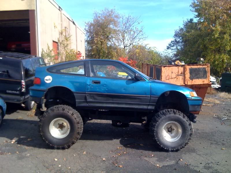

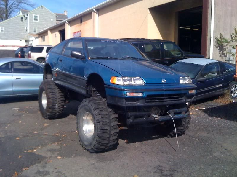

This insane 4.3L Vortech powered CRX on 36" Boggers was dropped off this weekend for some custom header fabrication. The CRX was built on 2 Samurai frames and has plenty of room for a V8 (future swap). Best part is, the owner uses it for some die hard off roading. We're doing some one off headers for the V6 as well as some other small things. Enjoy!
-Chris

The thing is insane! Locked front and rear diffs w/ dual reduction transfer case setup. This thing will crawl over other cars at idle!!!
I'll get more pics tomorrow. In regards to the two frames, he used 2 Samurai frames and sectioned them in order to get the correct length to accommodate the length of the CRX. Go figure, a CRX is actually longer than something! The sectioned frame was cut and welded in a "Z" as to add to it's strength. It may not look good, but it was put together right.

Let see it is two 88 sammy frames z together and wraped and it has a sammy gastank and front rear
but thats it oyea and the calamini 6 inch lift chevy v6 4.3 with a holly 650 on a custon intake
custom body lift fullsize blazer trans and transfer case stock with a tracker rear and gears in the front stock
housing with a kit from tough trail and 35 inch super swampers let not for get a 1991 crx
all custom gauges and working speedo aftermarket fuse box marine style wired the whole thing my self useing
stock crx column and rear harness custom heater box custom firewall you name it custom shifters fit in stock spots
ebake is 4x4 shifter and now my boys up by the navy base are making me some killer headers and exhaust and exhaust snorkel
there work is out of this world chris is the man i only let the best do it or i just try it my self so if you see me in the mud move aside i dont stop
for stuck people haha love it always thought of this for ever friends thought i was nuts know they know i nuts
