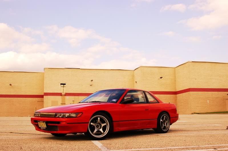

Hello all
We are tearing this car apart for a full re-build and hope to have it done by end of winter time
First we are stipping the car, caging and bracing it..
Then glass goes back in and it gets painted and the kit put on.
The set up we are going to run goes as follows
Sr20det 2.2 bottom end
Sr20 VVL fwd head built
custom intake mani with Q45
top mount t3 manifold
Mid mount intercooler
tial bov
tial wastegate
1000cc injectors
top feed rail
fuel system
Z32 trans and twin disk clutch
oil and ps coolers
custom crash bar
cooling system
oil catch can with custom -an lines from valve cover
haltech or aem ems.
Suspension is finished
Full SPL arms
Modded front control arms and knuckles
Tein S14 inner tie rods with spacer
SPL outer tierod ends
ES bushings eveywhere
ES rack bushings
Nismo front brace
Kazama tension rods
Solid Alum subframe bushings
Tanabe rear sway bar
Z32 brakes
ABS booster
17/16 bmc
AP brake lines
K-Sport e-brake with custom install kit
Ichiba 5 lug hubs
Enkei rp1-silver
front 17x9 22
rear 18.9.5 18
Ichiba front and rear wheel spacers
Tanable 7 coilovers
8 Point custom rollcage
The rest we will update on
Pics of strip down and part out of old parts
Paint and cage prep.
Im using the head form this VVL and putting it on my sr20 block
these 2 pics are a mock up of the vvl head on sr block..I will be building both and putting a z32 trans on it..
update: painted interior and engine bay

Man, I love those wheels on that car. Now I know what mine would look like.

thanks..which ones...weapons or rpf's....rear is 18x9.5 15 and from is 17x9 22

The ENKEI's. I do heart them.
Put them on this:

yes i got the last U.S stock of the rear size in the rpf-1s and waited months for them..but the fronts are always in stock...most ppl run the 17x9's all around
