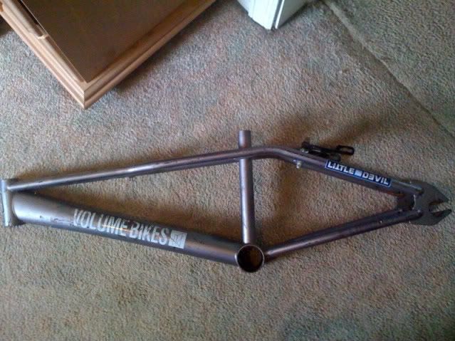

here's the frame i have lying around...i have no idea where it came from haha. i believe it's a haro?
how could i figure out if this is a decent frame or not for what i'd be using it for?

I'd have to advise against Dan's packages, they're junk. I used to work for a few bike shops and you'll end up re-buying everything. Since we already know what type of riding you're into, just be aware that most flatlanders have specific set-ups that are just used for flatland tricks. Their frames are bent differently, and will not hold up to the abuse of street riding (grinds, hops, gaps) because of their configuration. However, with how popular that really technical riding has become, alot more companies have started making their frames so that you could scuff more easily, or clear your feet for a foot-jam-tailwhip and things like that. If you want to buy a complete, look at FIT's line, they make awesome gear for a decent price. Or, if you want to put your own together, I've worked in a few bike shops, you're more than welcome to run your ideas past me and I'd be more than happy to help you assemble it when the time comes.

I'm going to tell you that you may want to get a new frame. the frame you got there is out of date, heavy, brakes are in a bad location and american bottom brackets aren't the best bet for you. I would say buy a complete bike from FIT which is good or another company. But you should look into getting a 20 or 20.75 top tube, it would make it easier to learn flatland. Also try and pick up a fork that can run front brakes, helps with nose tricks. If you need any help ask me I have been riding street forever.
