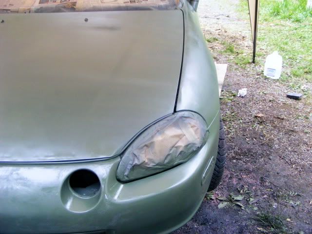

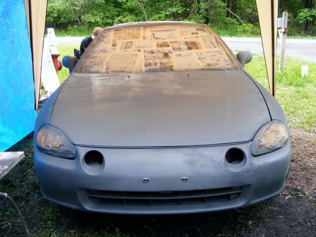

How to: Spray paint repaint
Now, before you start to massively flame away at me, let me start with, I was tired of a 3 color car. So i repainted the DD/Project with Krylon Indoor/Outdoor spray paint and Krylon Indoor/Outdoor primer.
In detail here are the items and steps you will need to take to paint your car on a shoe string budget (i spent a total of 185.00 dollars)

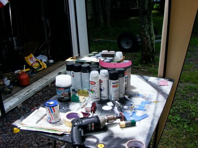

First, the supplies (Note: Your car may be more or less paint depending on size):
1.) For my car (1997 honda del sol) I used 8 cans of flat paint (olive green)
2.) 8 cans of primer
3.) 8 cans of Flat clear
4.) massive amounts of varying sand paper from 60 to 1000 grit. (for paint removal on small areas and later on wet sanding)
5.) Orbital sander (for the larger areas)
6.) Masking tape 2-3 rolls
7.) News print/masking paper
8.) Buffing compound and wheel
Now, as for the steps.

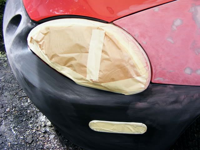

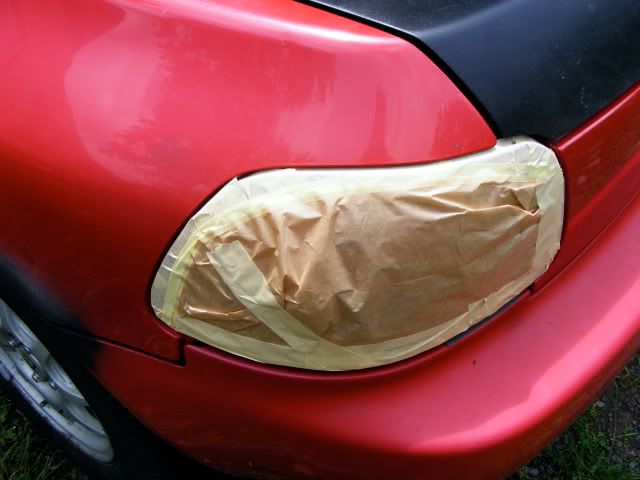

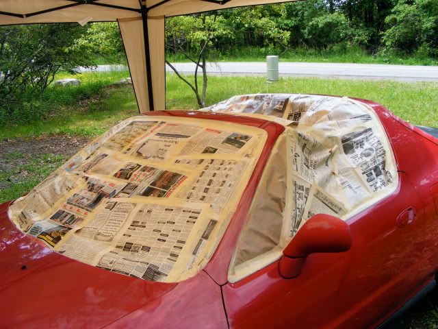

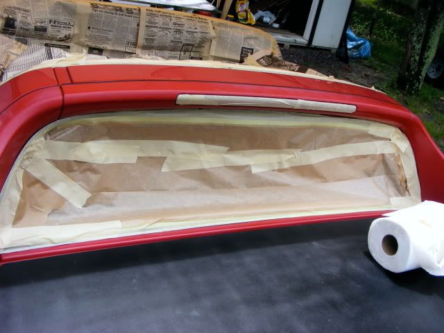

First, you are going to want to do a majority of the sanding first, as to not rip the tape you will hvae on the areas you dont want the color to get on. Use the orbital sander and the rougher grit sand paper here. Get rid of all of the clear, you can go to the primer if you so desired, but you are going to put a few layers down yourself.

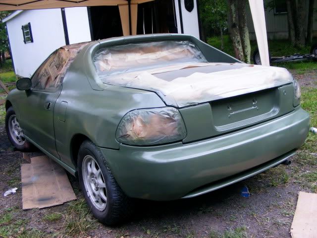

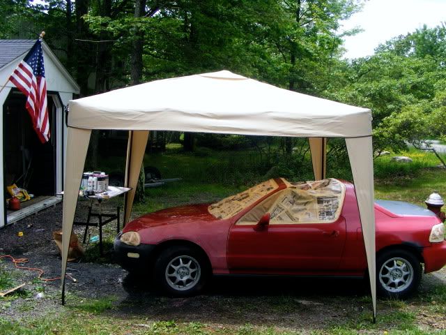

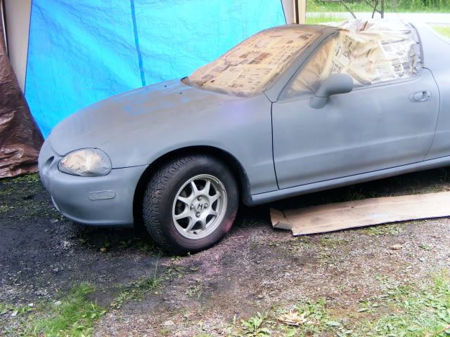

Second, you are going to want to get this under/ in a paint booth. I made one out of a pop up canopy and some tarps. it worked well, just make sure you have ventilation and a respirator. After you get it into a clean environment, you are going to want to clean the car completely. I used de-natured alcohol. Make sure the car is dried and you have all suplies ready for the next step before proceeding.

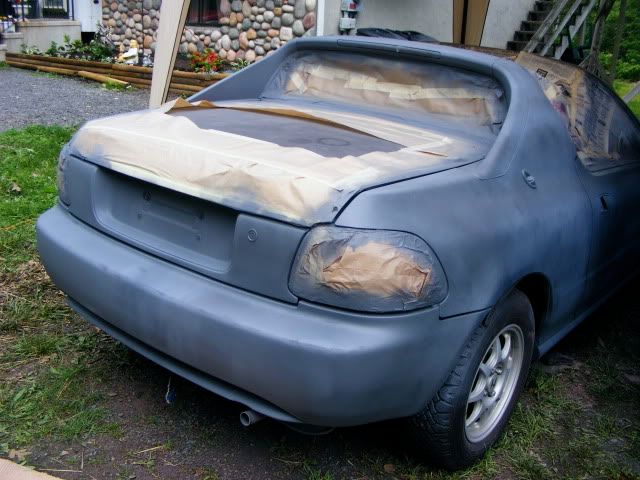

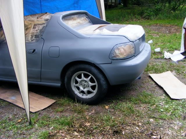

Third, start with spraying your primer, now you are going to want to shake every can before spraying as to get an even coat of paint with every spray, you're also going to want to START spraying before you hit the car, and STOP spraying after your off the car. Do individual panels, one at a time if at all possible (i.e. fenders, hood, doors, trunk, etc..) If at all possible take off the hood, fenders, trunk and doors to do so you can get an even coat on them. You're going to want to do this until all of the primer is gone, or until you can see EVERYTHING is covered.
Fourth, you are going to want to let this dry, but after it has, you will want to wet sand the ENTIRE CAR, i cannot stress this enough. This will get rid of any rough spot, wet sand it and that hose it off, than dry the car completely before going onto the next step.

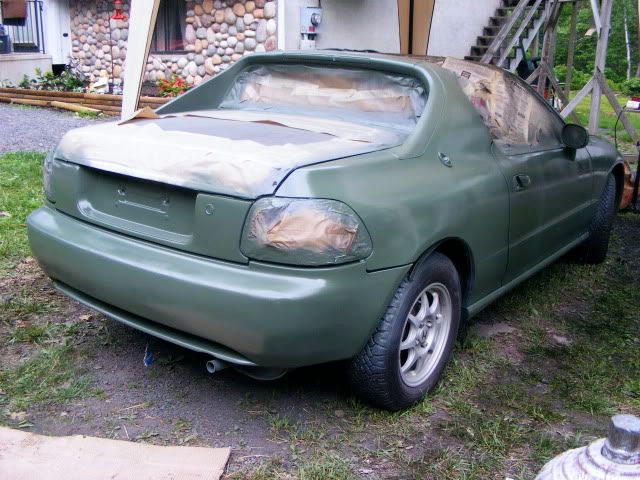

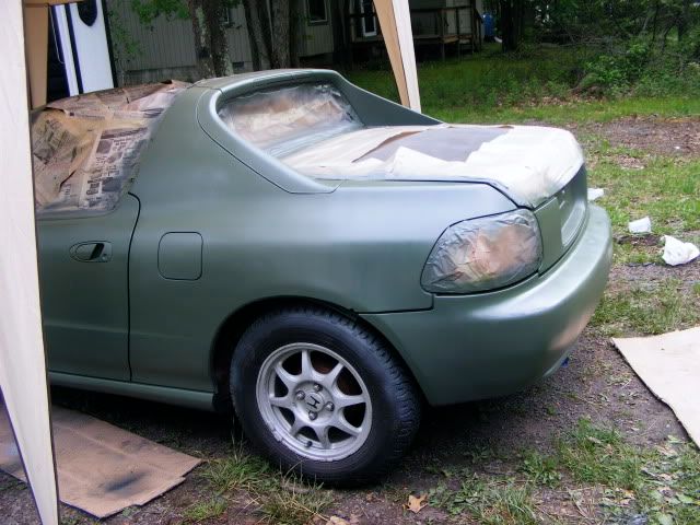

Fifth, Start with the paint. Just like primer, start before you hit the car, and stop after you're off the car. Spray enough to cover the entire car and you can see an even coat. Be sure to inspect all areas that would be difficult to spray and make sure they ar covered. be very careful on touch ups as not to get any drips.
REPEAT STEP 4
Seventh, spray your clear like you do your paint.
REPEAT STEP 4
Ninth, Buff the car after you've dried off the car from wet sanding. Ideally, do it in a shaded area, and do small areas at a time. 14x14 inch areas and be sure to clean off the buffed areas immediately after finishing each area.

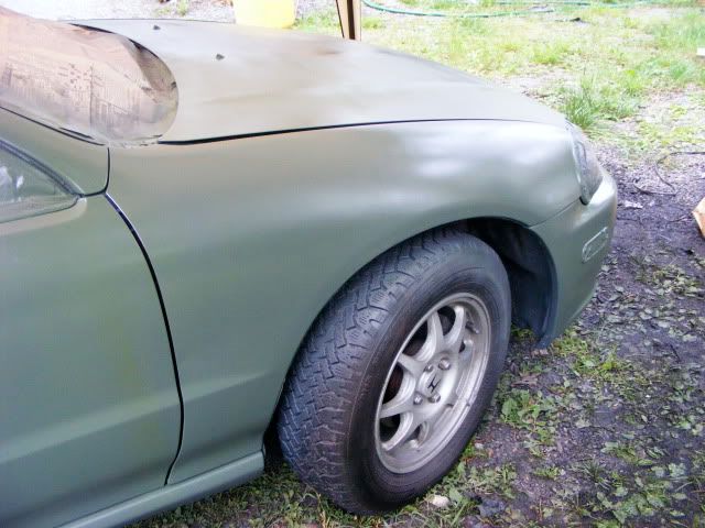

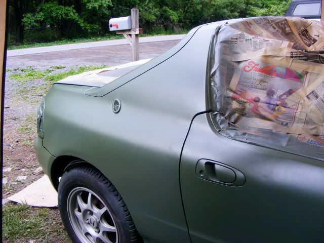

After this you will want to rinse off the car and get all of the buffing compound off of your car. Here are some pics:

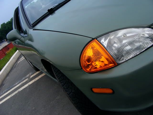

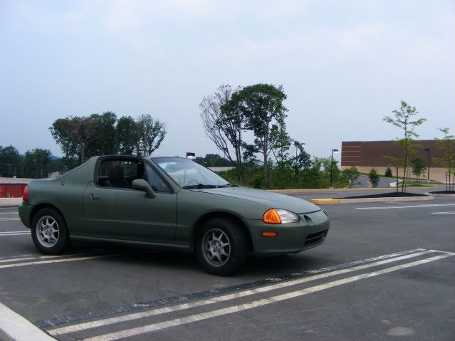

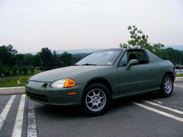

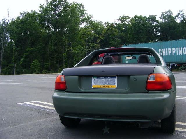

And heres the finished product:
Hope this helps someone looking for a cheap way to paint there DD or project.
