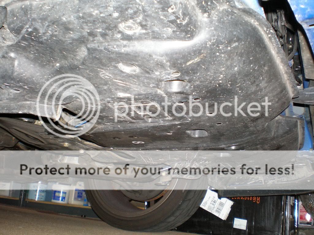

Step 1: Jack up the car and put it on jack stands. Remove the under tray from the car to allow access to the radiator from underneath.
Step 2: Remove the five 12mm bolts and the four pops.

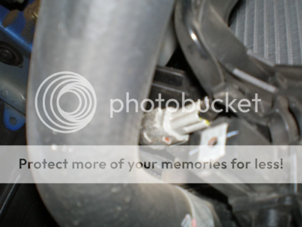

Step 3: Drain the radiator fluid by loosening the drain valve. Also, while under the vehicle, unclip the radiator fan plugs. Once the coolant is completely drained, remove the lower radiator hose completely to allow for trimming of lower radiator hose. (Trim ˝ inch from each side.)

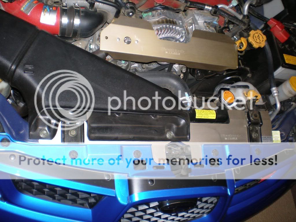

Step 4: Remove the top radiator brackets and the intake scoop. Then remove the top radiator hose clamps and hose completely. If they are left attached, they will interfere with the removal and installation of the new radiator.
The scoop has two 10mm bolts, and the brackets have two 12mm bolts.

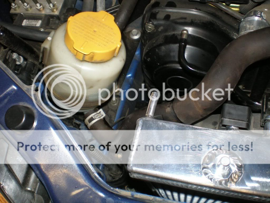

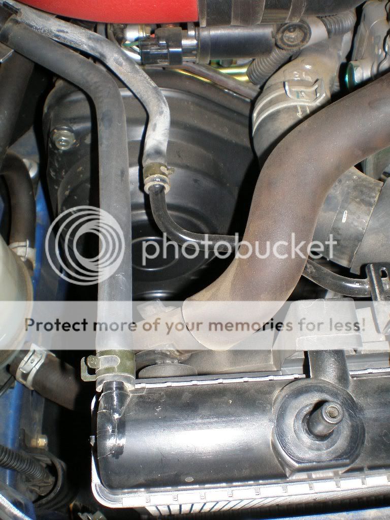

Step 5: On the passenger side, remove two small radiator hoses and unclip the power steering line. Removing the power steering reservoir from the mounting bracket releases tension on hose.
Note: You do NOT need to remove the reservoir clamps or the entire reservoir completely. Only unclip them from the mount on chassis.

Step 7: Install the new Mishimoto Radiator into the vehicle using the same steps as was used to remove the stock radiator but in reverse order. Install all of the hoses and clamps to their original positions on the new radiator. When installing the lower hose make sure to reconnect the radiator fan cables.
Step 8: Install the zip ties on the coolant reservoir lines to ensure that they do not leak.
