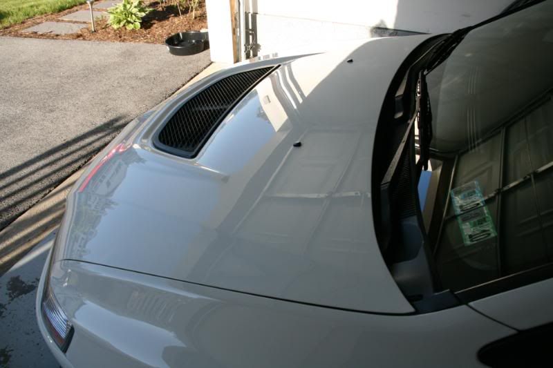

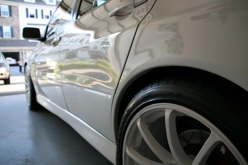

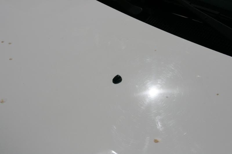

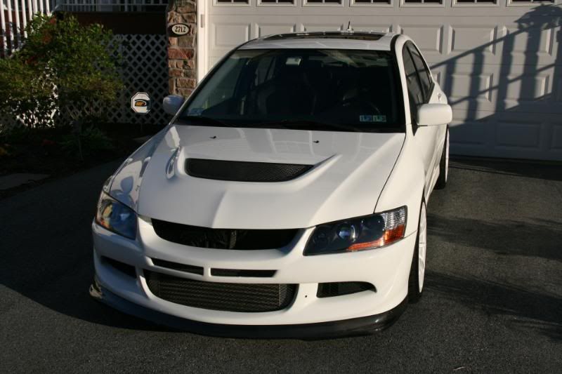

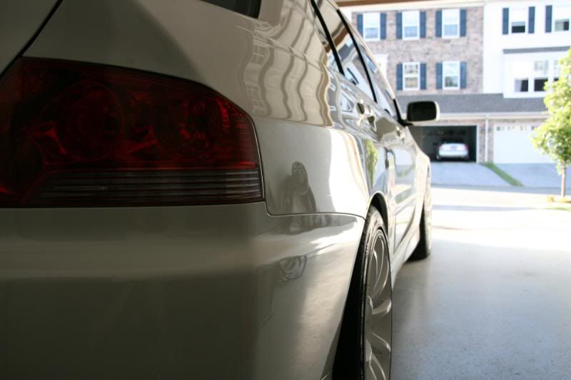

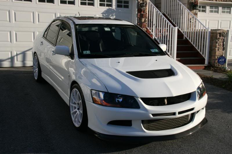

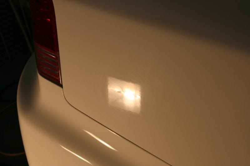

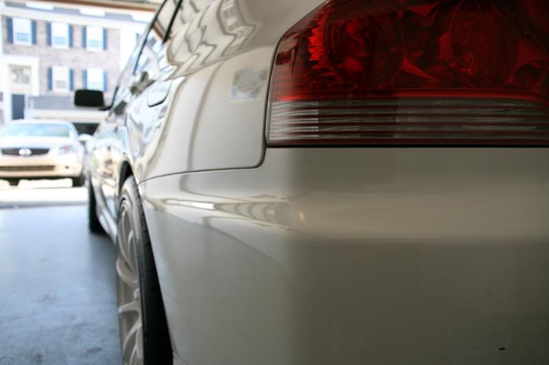

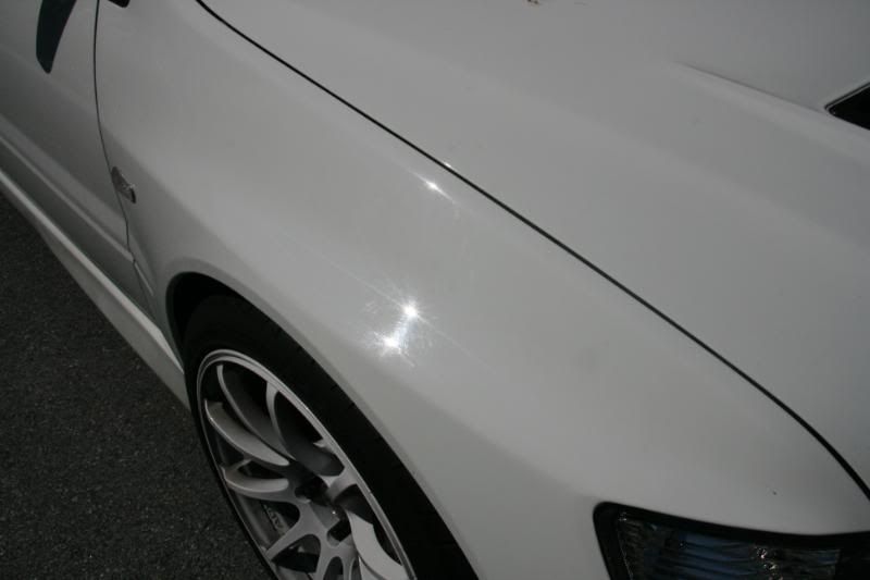

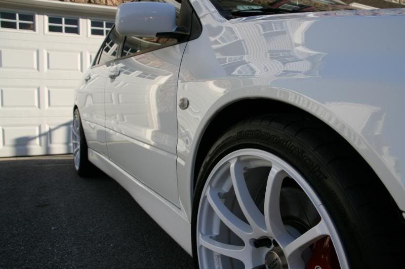

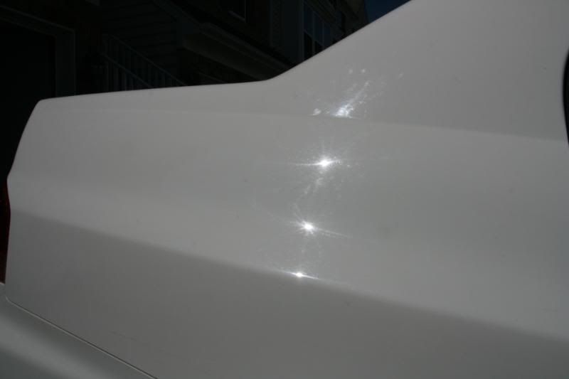

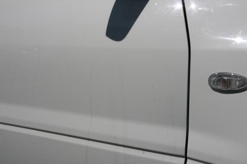

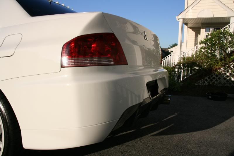

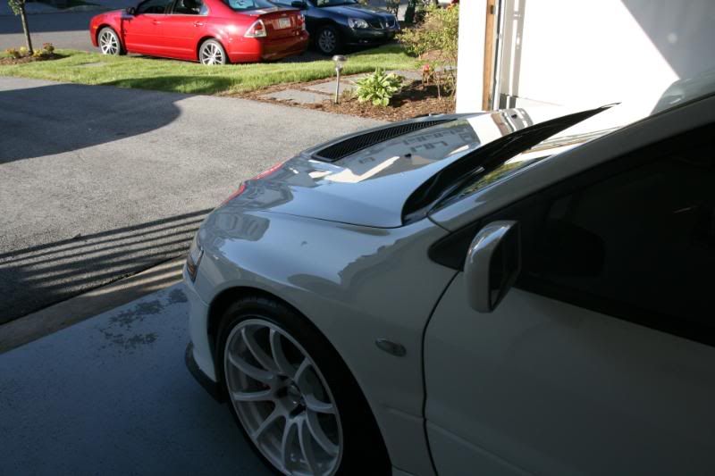

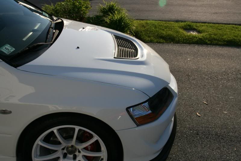

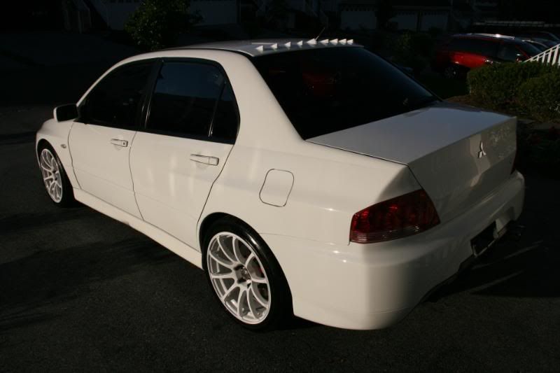

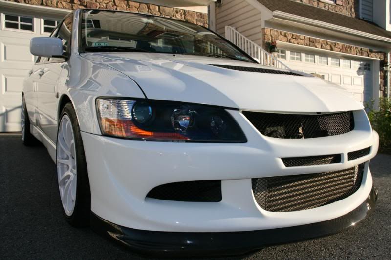

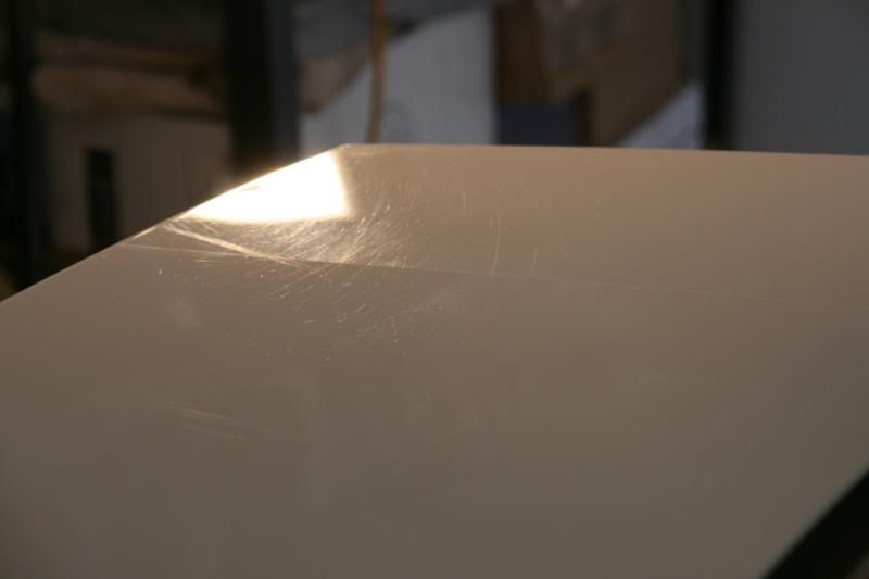

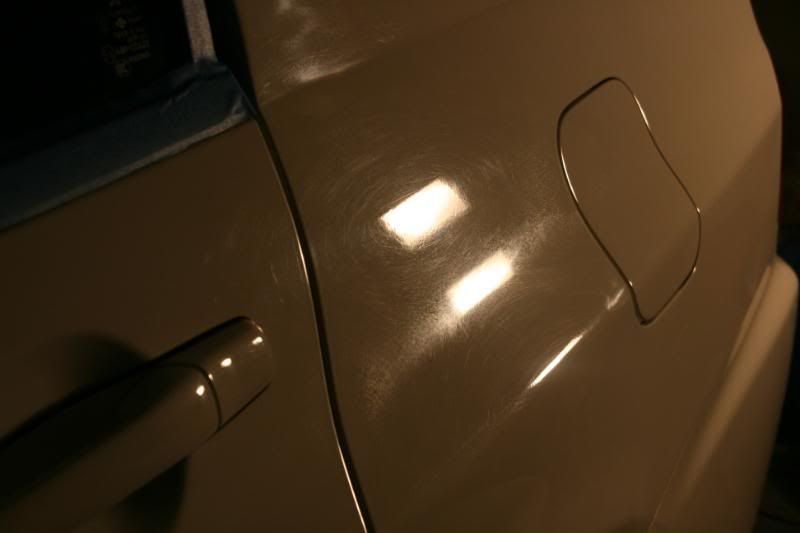

Here is a full exterior detail (pacakge III) of jjm4life's Mitsubishi Evolution, ended up being a three day long detail that took care of about 95% of the problem areas Mat pointed out to me. Mat got in contact with me Monday before he left townto have the car done while he was gone, it was returned to him tonight after his arrival. Tried to be as precise with the pictures as possible, however it is difficult to capture defects with white paint.
Process:
Menzerna 203 - PC, orange pad
Menzerna Intensive Polish - PC, orange pad
Menzerna Final Polish - PC, white pad
Menzerna Finishing Touch Glaze - Cyclo, white pads
Optimum Opti-Seal Sealant - microfiber hand applied
Pure Carnuaba paste wax - hand applied
Before Pictures

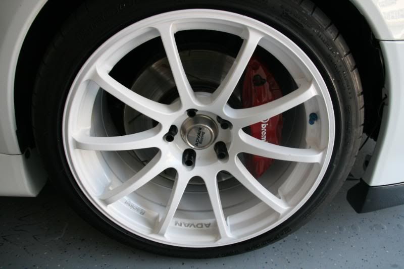

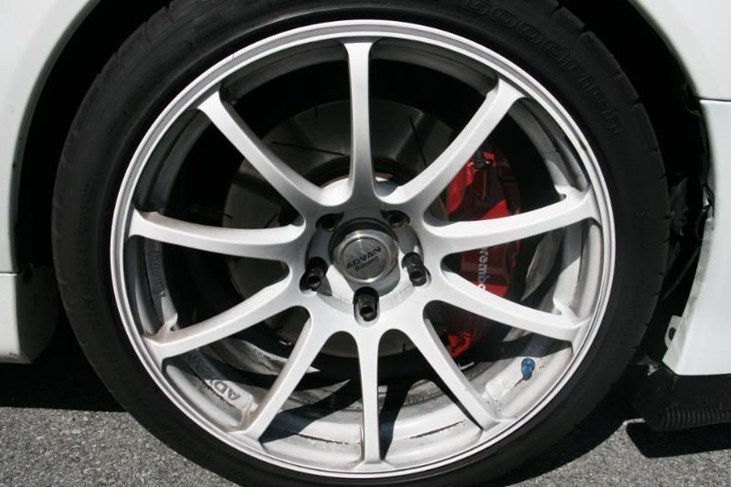

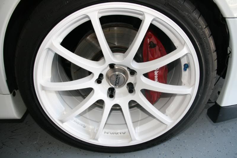

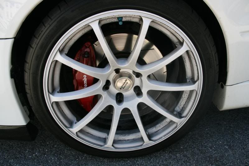

Wheels Before/After

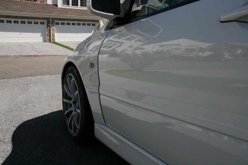

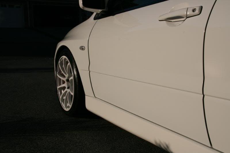

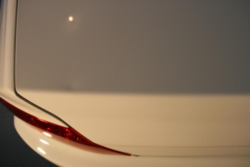

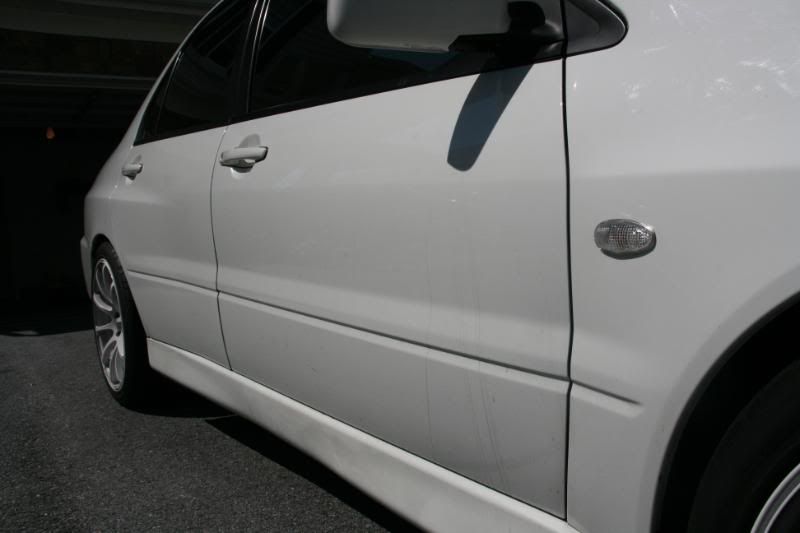

Some 50/50 photos, very difficult to take with a white car.
If you squint you can see the different shades of the paint from the left unpolished side and the right polished side

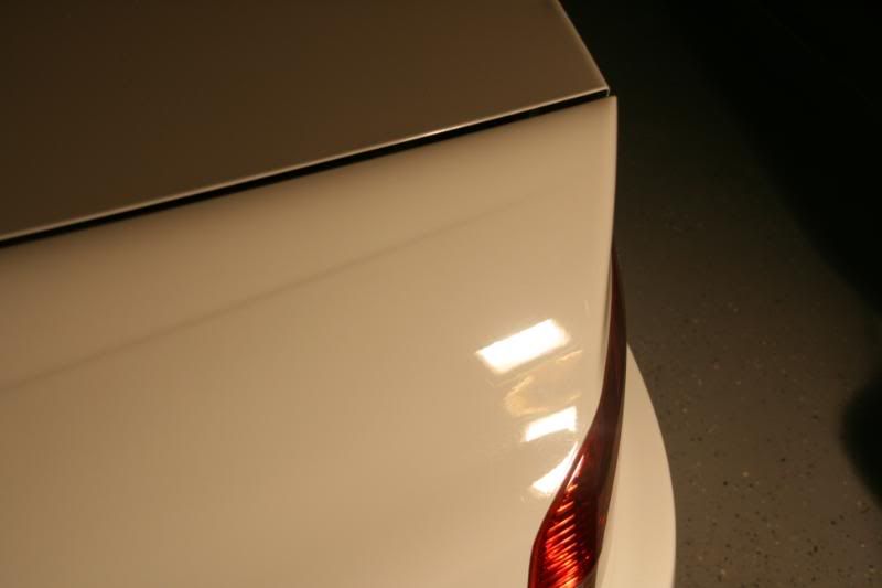

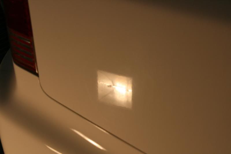

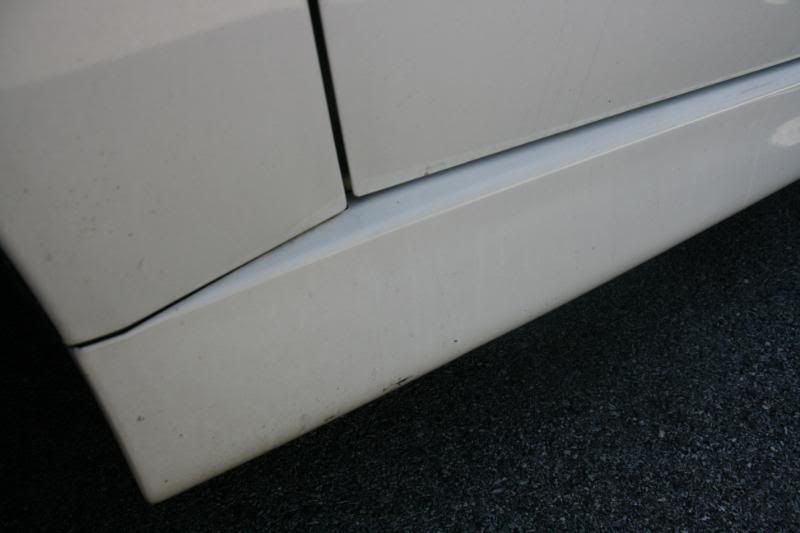

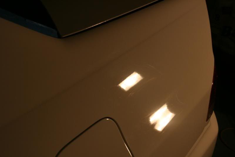

Rear Quarter before/after
1.
2.
3.

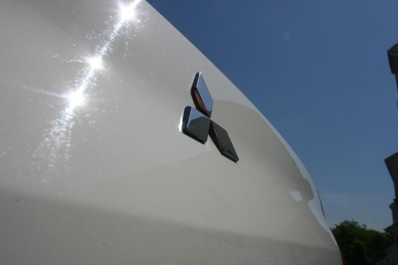

Reflection photos of the finished product

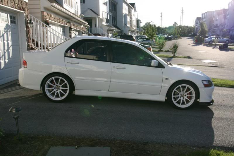

Finished photos of the vehicle
On her way home!
