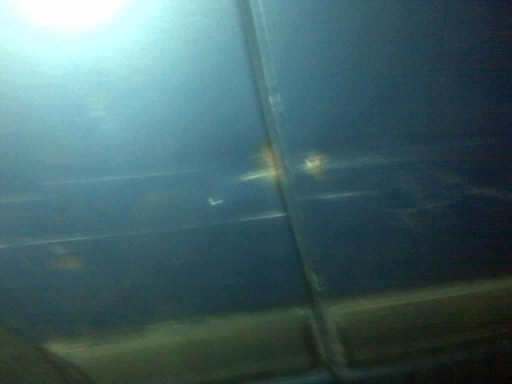

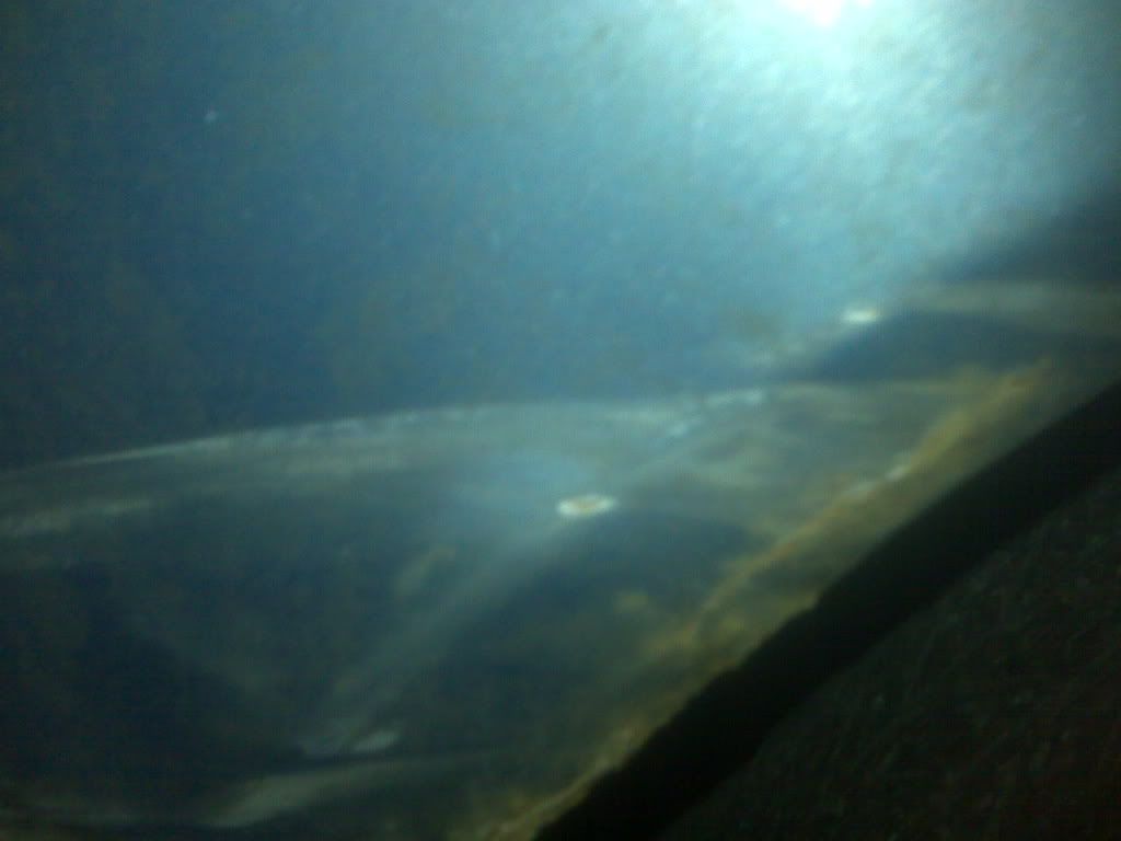

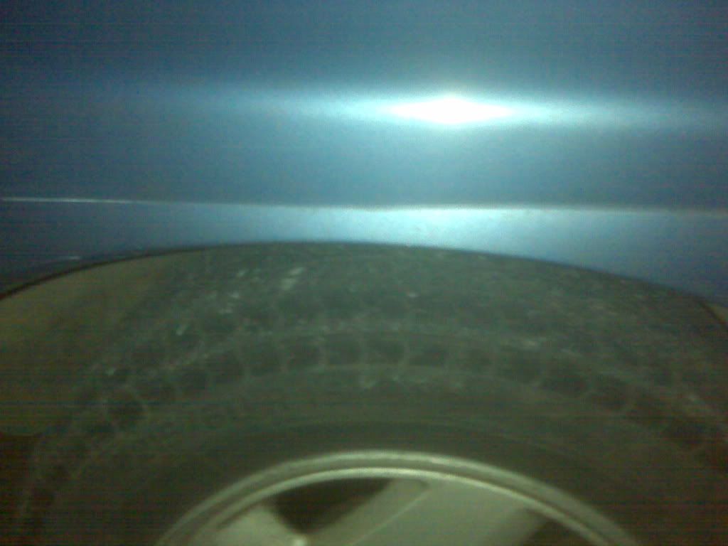

kinda new to the body work stuff, done some **** here and there nothing great but yeah just wondering if anyone has a good approach for fixing these dents, and if this will be hard or anything of that sort, cuz im trying to get the rx7 painted but id like to have the body work done already.
this is pretty much all of the bad stuff..

your pics are too close to see the dents well

its just hard to see the depth and general shape of the dent (at least to me)

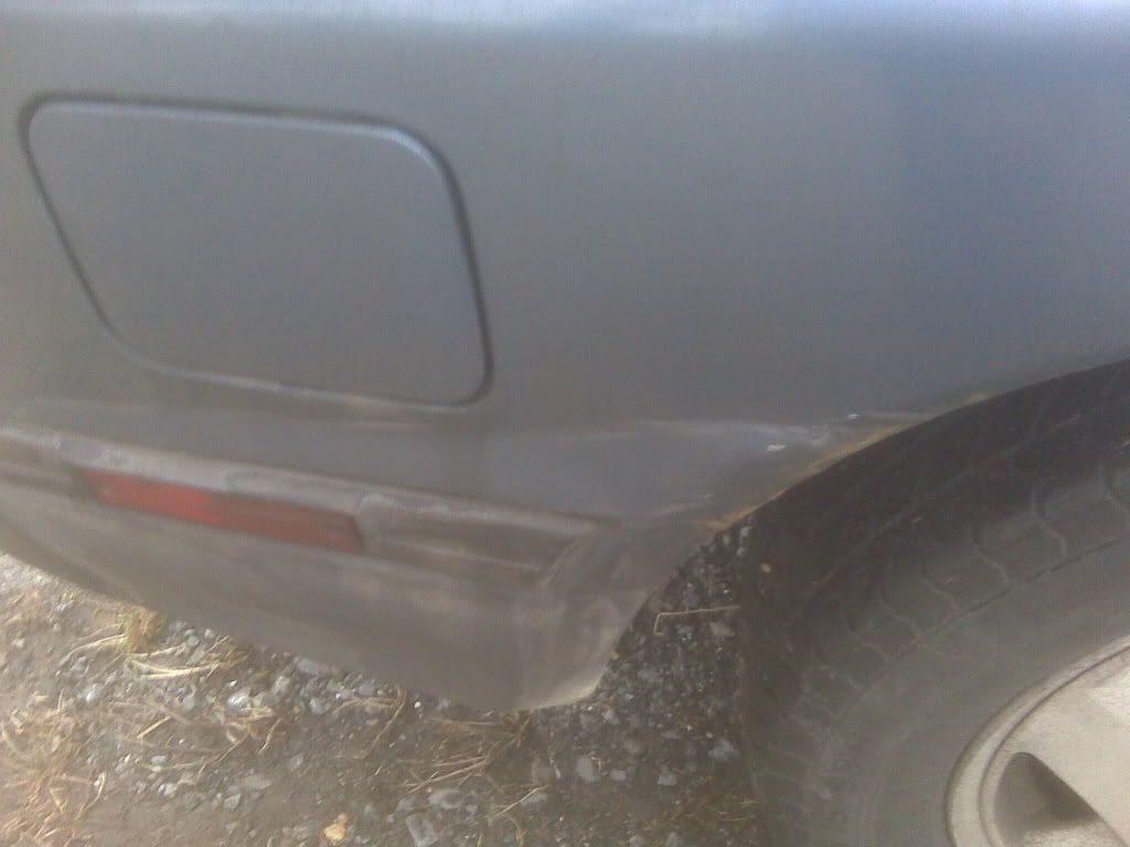

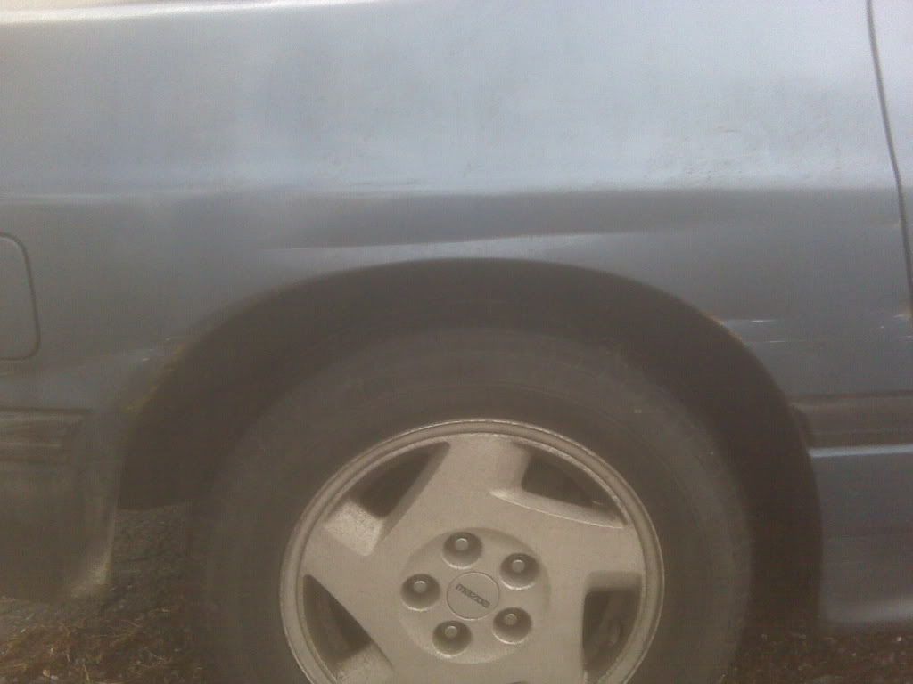

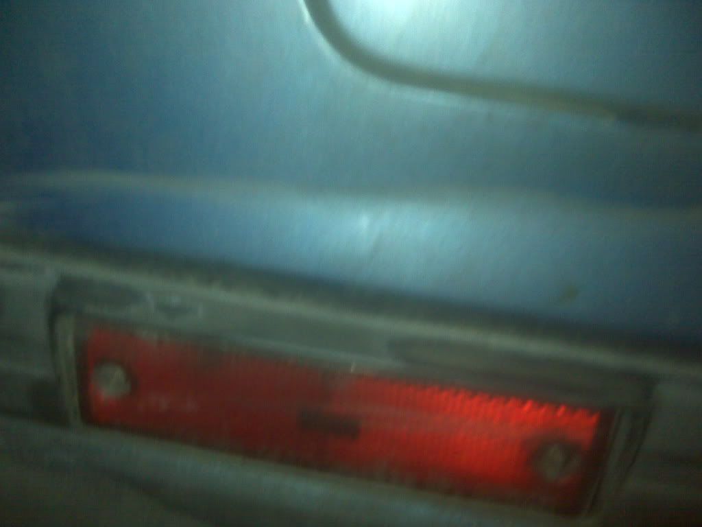

ok heres a better pic i think...
and after briefly inspecting the car, thats probably the biggest spot of repairing needed.. thanks guys.

Go to harbor freight and get this for $120: http://www.harborfreight.com/cpi/cta...emnumber=98357
I have one and it works fine... You may want to invest in a better slide hammer tho, the one that comes with it sucks and slips off after 2-3 pulls. Just grind down to bare steel whee you put the studs, start in the lowest point, and dont overpull. If the panels get a "can" effect where it easily pops in/out just heat it up and cool with a damp rag.
