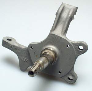

ball joints and spindles and disc brakes...oh my
but really, just the ball joints and spindles...
how the **** do i get the spindle out? mallet on the bolts till **** falls out? this is for the 72 parts truck...

you need special tools for the ball joints and stuff, the ball joint tool kit i believe is about $300-$400, find a mechanic you know that has one and borrow it

wait... seriously? i dunno... there are people doing that **** in their garage all the time... gotta be a way to get the spindle out w/o dropping $300 on a kit...

Pickle fork and hammer if you don't plan on reusing the BJ (had to do it)

i'll be replacing the ball joints with fresh ones. i picked up a nice mallet and some ratchet straps to hold the spring to the upper control arm... tomorrow, it's hammer time...

For the ball joints, use a pickle fork or a ball joint separator. As for the spindle, in the cases that I have seen it, its usually pressed into the knuckle. So to remove it, you will need a hydraulic press.

by spindle... i guess i mean knuckle...
this whole piece needs to come off the control arms

just googled pickle fork... back to the hardware store... then back to my parents... i can potentially get both knuckles off today... which would be awesome

If your replacing the ball joint simple..... lots of PB blaster, thread the nut 3-5 turns and smack it. Some heat on the spindle around the ball joint stud will help too.

PB blaster huh... i think i have some of that in the garage.
I managed to get the steering and UCA joints off, but the bottom one is being a bitch. the knuckle doesn't sit close enough to the BCA to use the pickle fork.
