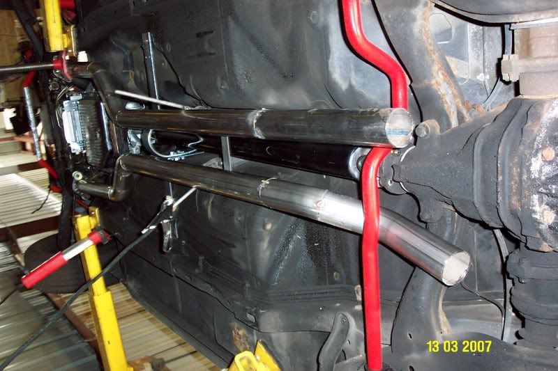

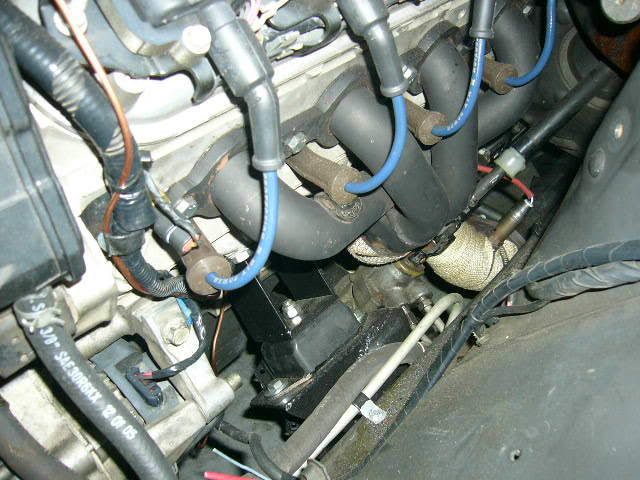

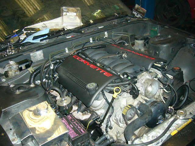

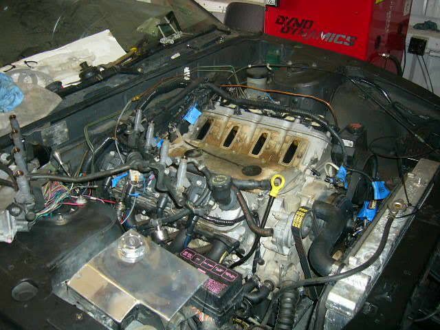

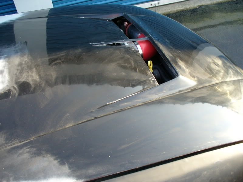

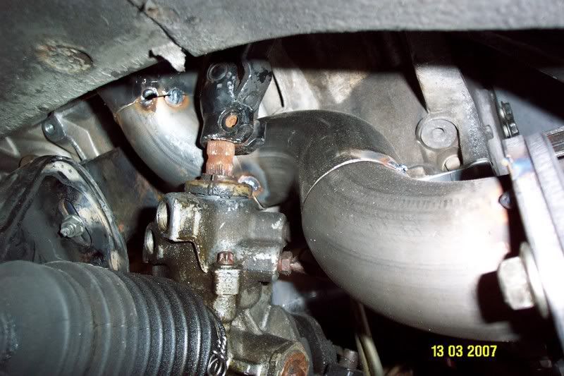

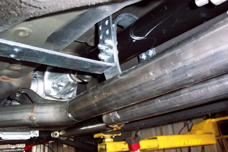

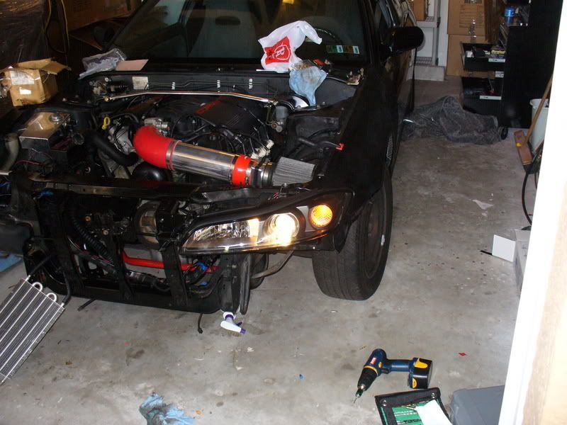

The VH Swap Ellis Autoworks did.

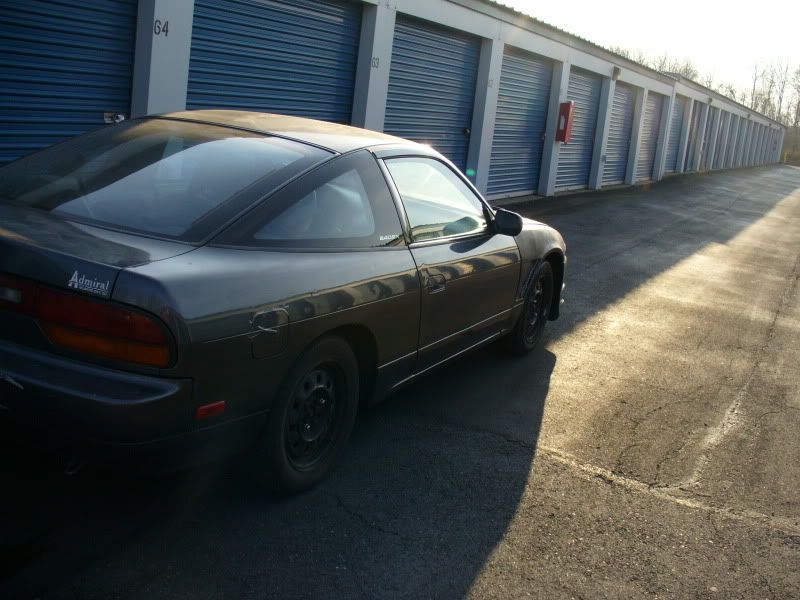

The car
THE SWAP........
Engine.... Estimated HP 430-480RWHP, need dyno after some upgrades and tuning
2002 Chevrolet LS6 5.7 Liter V8, F-Body accessory drive, LS2 front sump conversion, Port and Polished throttle body, ported and descreened MAF, Custom headers, Hypertech T stat, Bosch 42# EV1 injectors, LS7 lifters, Hardened pushrods, ported and polished 243 heads with patriot racing dual gold valve springs, Texas Speed MS3 Cam, Tuned ECM, Mishimoto aluminum radiator, Mishimoto fans, AC delete, Emissions deleted... No cats or emissions controls enabled, Dual stainless steel exhaust, dual 3.5 in/out Borla XR series mufflers, 8 Gallon fuel cell, Hypertech Hyperpak monitor

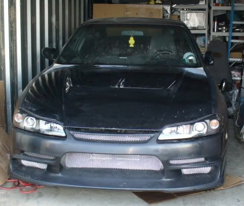

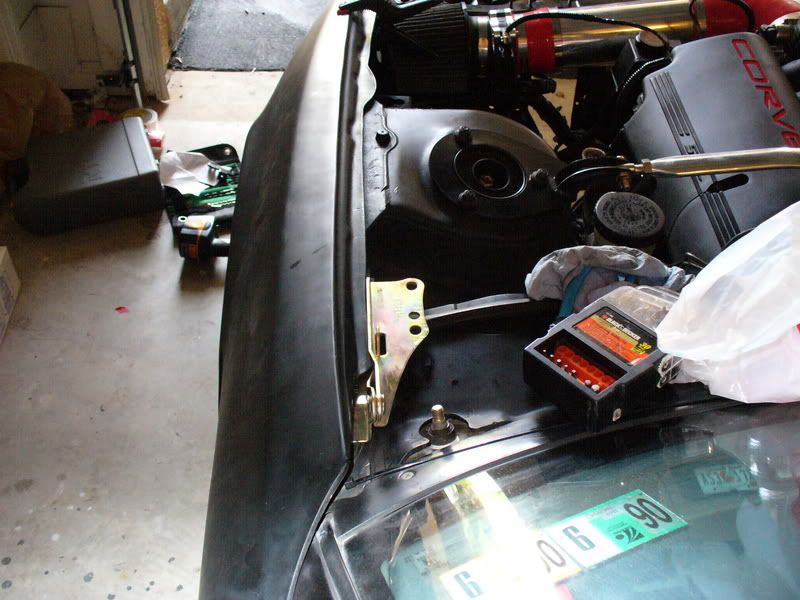

Exterior
Silvia S15 front end conversion (RaceOnUSA Fiberglass) conversion fenders, hood, bumper, OEM black housing S15 headlamps, OEM S15 radiator core, going to be adding a custom cowl to the hood, and most likely I am going to be selling the front bumper and going with something that will flow better with the GP Sports Aero kit

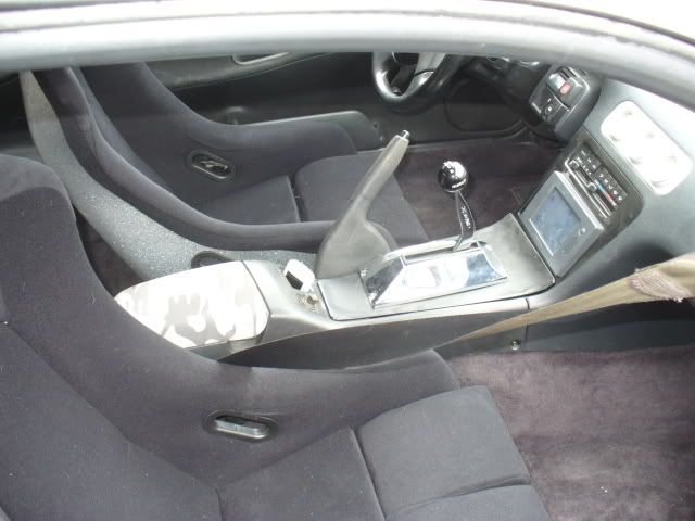

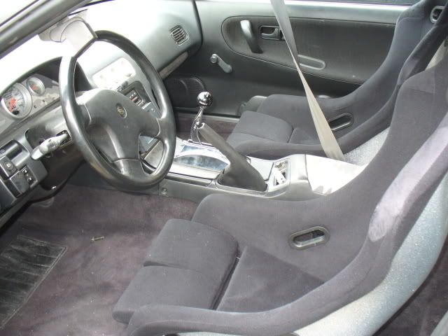

Interior
Autometer Ultralite 2 gauges, Speedo, Tach, Oil Temp, Oil Pressure, Water Temp, Voltage, Fuel... Bride Vios Seats, Dyed carpet, Safety21/Cusco 6 point cage.

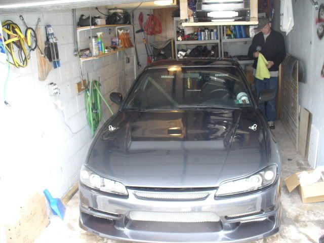

Well its a work in progress. I paid 300 for the rims brand new in the box 2 years ago for use on another car and they were laying arround, but for now they work. Steelies were on it and I went 5 lug so its all I had.
I am doing this same kit here, the Orgin lab stream kit s13 skirts and rear with the s15 bumper (Enjuku is giving me a deal).
And i need coils right now I have KYB AGX's with TEIN springs but I need lower 1 inch in the rear (fuel cell), 2 inch in the front. I wont slam it, I live in the city and it has too much power to granny drive.
But hey its coming along. I need to hang the exhaust, get carpet, get my bride seats, and get it on the road for now.
future kit

Bride Vios seats
Dyed OEM carpet

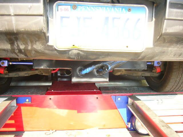

Tomorrow I am going to align it better then Monday it goes for a real alignment and to have the mufflers hung finally. I still need to finish the new cluster, put the interior in, get lug nuts (rays lugs don't work with rays wheels WTF!!!), fix my transmission leak, and send her back down to Fran because the tune is off.
