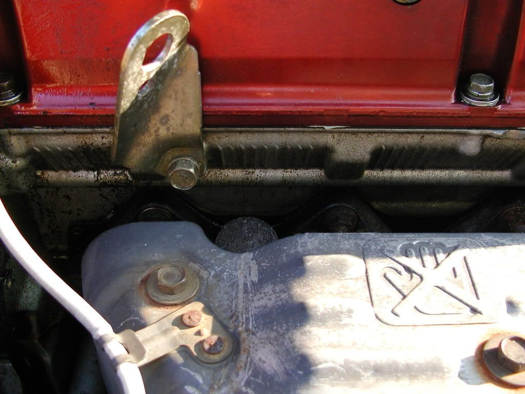

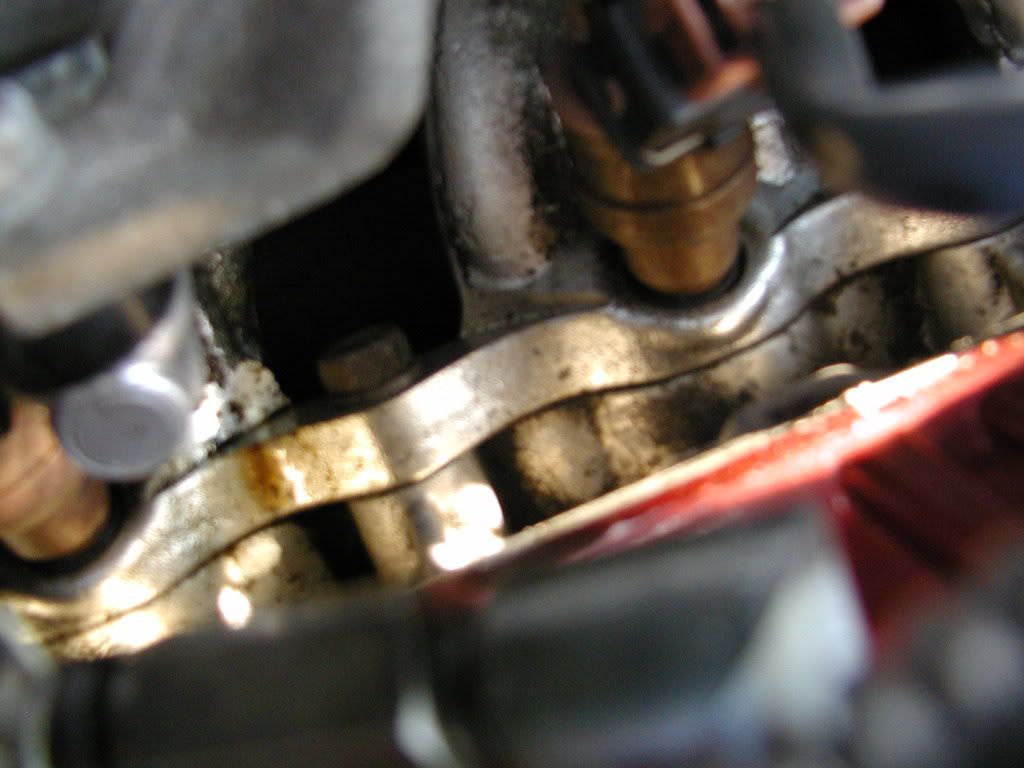

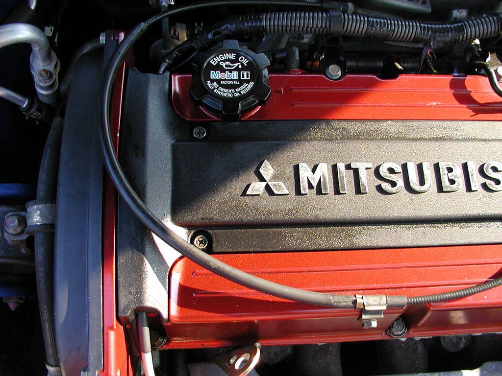

The pictures are of the "engine cover" (That's probably not it's proper name now that I think of it), intake and exhaust manifolds.

seeing as how the oil is ontop of the valve cover i would think dip stick, but then again it could be many things but it doesnt seem like a head gasket because i dont believe the spray would get it on the hood/top of the valve cover
also if its that HARSH as in spraying the hood
add oil till regular running level
fire her up
open the hood and look
if its powerful enough 2 hit the hood you should be shown the problem if not sprayed in the face
burning sensation when looking at the car may reveal a problem lol

take the spark plug cover off. If there is oil sitting in the galley, they it is the spark plug valve cover seals. there is a drain to drain the oil out of the galley, if it does leak. that is why you might have oil sitting where the intake manifold meets the head. the drain outlet is a little gold hole above that in the valve cover.
without knowing what it looks like under the spark plug cover it is hard to say. it looks like the valve cover gasket. Do you have aftermarket cams? It could be the cam seals. Remove the timing belt cover and see if oil is down there.

To me it looks like the valve cover gasket. But, others have said things to check. Check those things as well, you should be able to see the leak.

yeah i was thinking valve cover spark plug seals too but wouldnt it trap the oil under the cover and not have a crazy spill over like seen there? i dont know really iv only had something like this happen to me once and it was becuase i didnt put the dip stick in all the way once (idiot i know) but the result looked exactly like the pictures my hood was covered. i just dont think you usually get splatter from valve cover gasket, cam seals, or anything gasket wise because usually there isnt enough pressure to push oil out of gaskets like projectile wise

I don't have aftermarket cams, and there was oil in the galley underneath the spark plug valve cover.

I'm pretty sure it's the valve cover seal. There was oil in the galley but only a small layer (almost as if there was some in there and then it drained). I don't think it's the cam seals, there is no oil around the timing belt, just around the manifolds, on top of the cover and in the valve galley. I will most likely run into more information later on today since I will be changing my oil, hopefully I'll get a better look at everything.

yea that is the point for the drain. to make sure the oil doesnt sit around the ignition components. change the spark plug valve cover seals and the valve cover gasket. and the PCV valve. It could have been the PCV's fault the gasket started leaking.
