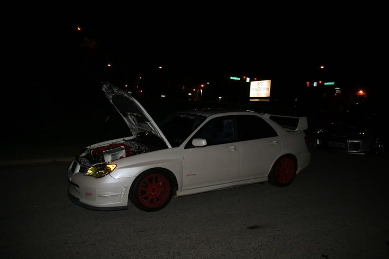

So, Here's the deal... Friday night, we wrap up work and Ray shows up. He screws around tuning my car for a bit. It drives better than it ever did off of the Suby lot! Thanks so much for that by the way. ( but i did lose a bit up top, we will work on that though )

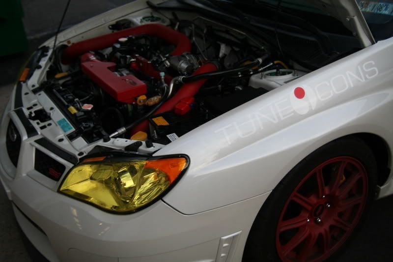

Somewhere that evening we all split. So I go my way home, When all of a sudden the STi just dies. Lights, power, everything, just gone!

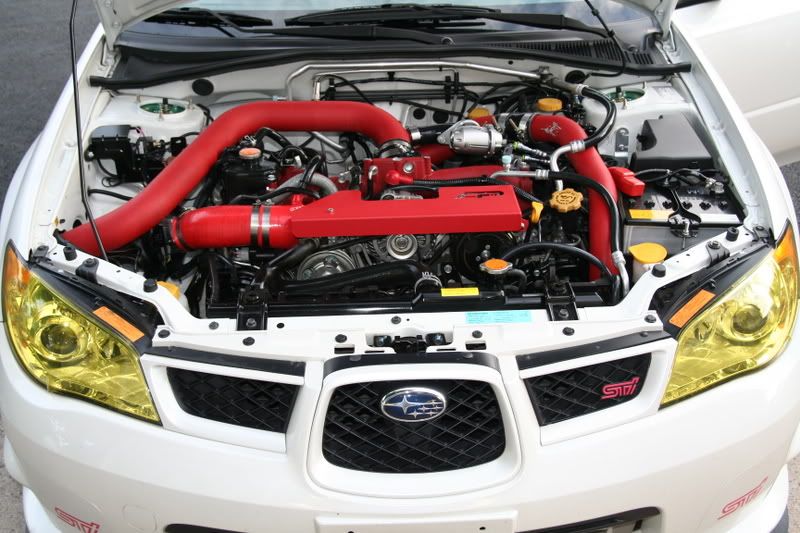

As it would turn out, my positive terminal on the battery rubs the 'grounded' Intercooler pipe. NOT GOOD!
Can't believe this didn't get noticed or bust sooner.
oh well, Ray to the rescue. One new battery later, a few hours, everything is back to tip, top shape.
((Oh, and a little side adventure on the way back to the shop, which I don't think can be commented on TST....))
Heres a few pics from the night.

dont feel bad, it happens to a lot of subie owners.
well atleast blowing the main fuse happens to a lot of them. I use a cut house clamp wrapped around the piping at that spot.
