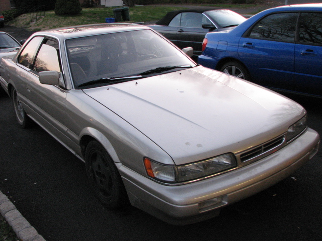

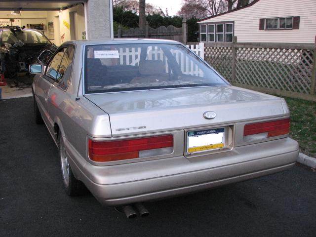

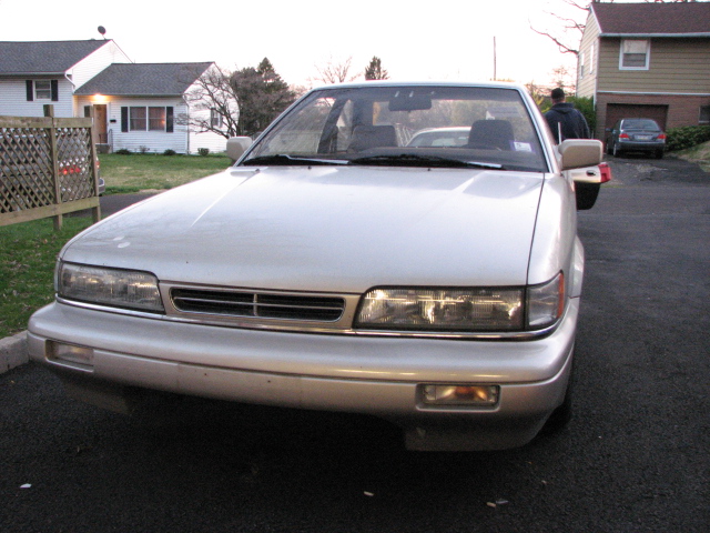

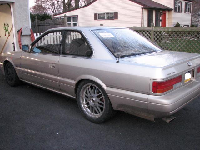

Ok, so its about time to move on with another project. After wrecking the WRX and the subsequent teardown of said rex I've got my hands on a replacement. She's a bit rough around the edges at the moment but soon she'll be amazing.
1990 Infiniti M30 aka F31 or the Leopard in JDM Land
Here she is!!

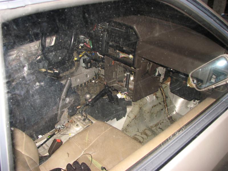

Gutted interrior

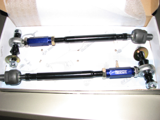

Here are a few bits I've picked up that are about to be installed.

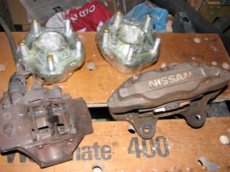

Wicked tuning inner and outter tierods plus a 5mm spacers installed into the steering rack for UBER-ANGLE!
5-lug conversion for awesome wheel selection + R32 Big Boy brakes - 4pot up front + 2 pots in the rear with drum E-brake =

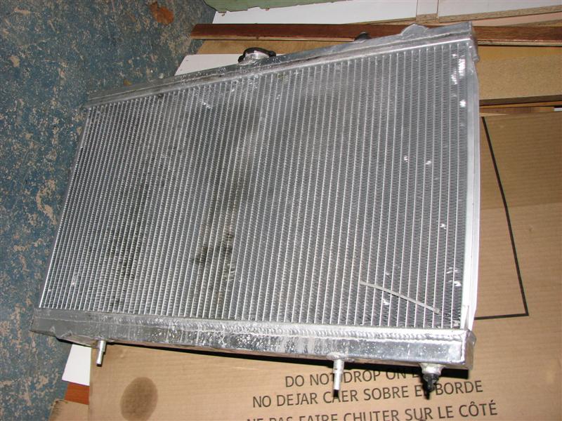

better cooling!!

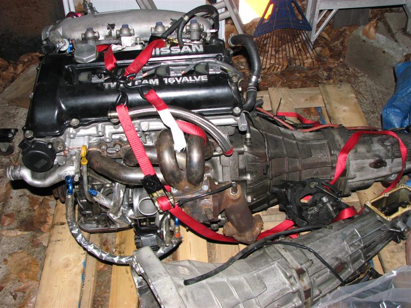

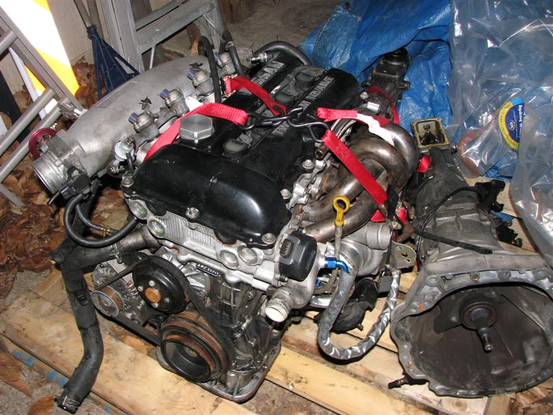

Heres some details on the engine:
1997 S13 SR20DET Engine
stock bottom end
SR head was ported and polished, butterflied by Jim Stewart
Jim Wolf Valve Guides
OEM NEW Valve's and Valve Stems
Brian Crower Springs and Retainers
Brian Crower 264 Cams
Apexi headgasket
ARP headstuds
Megan Racing Manifold
GT2860 aka Disco Poato
Greddy Intake Manifold
740cc Tomei injectors
Brown and Miller Racing custom Turbo lines
New OEM engine harness was converted by Enjuku Racing
Exedy Stage 3 Clutch
Fidanza lightened flywheel

How do those wicked tie rods look (quality)?
I was thinking bout getting them.
i got the tension rods a few weeks ago with no complaints as of yet
