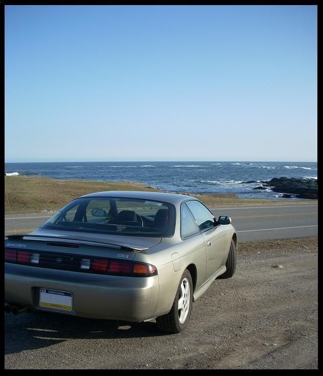

As for the exhaust, I like it a lot. The tone is nice and aggressive, and not too loud (even on a NA KA w/ a hollow cat). At low rpms, its damn near silent. Most people say its even quieter once boosted. My only complaint was that the fitment was, in my opinion, sub par. The way the hangers were bent cause the exhaust to sit too far to the left, making it hit the body on every little bump. As you can imagine, it was annoying as hell. I drove it like that 24 hours before ripping it back off and using a torch to heat up and bend the hangers so that the exhaust would fit right. Problem solved, and im happy with my purchase. Id recommend it.

Heres the best pic of it i have on the car.
