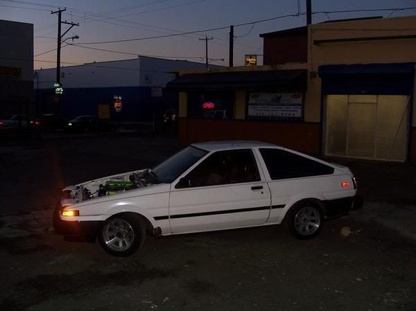

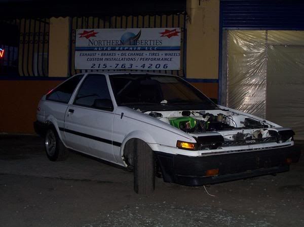

hey guys here is a couple of pics from dave's lil bro dan ae86 silvertop.that we are currently building.
a lil fire wall prep so it could clear the distributor.
slight diference between the silvertop and a 16v 4age.
cut off the over lapping flange.
secure waterlines and thermostat before installing the engine.
then figure out this hell hole.lol fuel lines
yeah i used my jacket to clean the engine.lol
crazy spaghetti harness
so i hope you guys enjoyed the pics i'll post more of the build later.

Wow. That 86 is really clean!
Are you wiring in an a/c and all the idle up stuff?
I wired up a silvertop/AE86 for a buddy and I didn't feel like messing with all that extra crap.
Are you using the evap lines for fuel lines too?

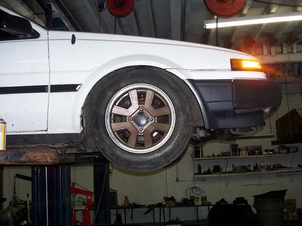

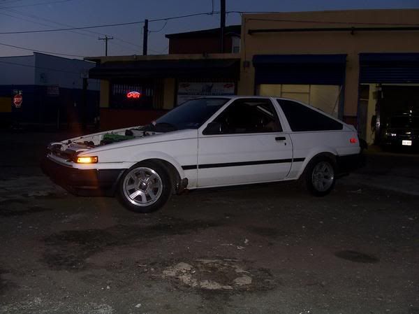

not quite running but the lighting was nice.

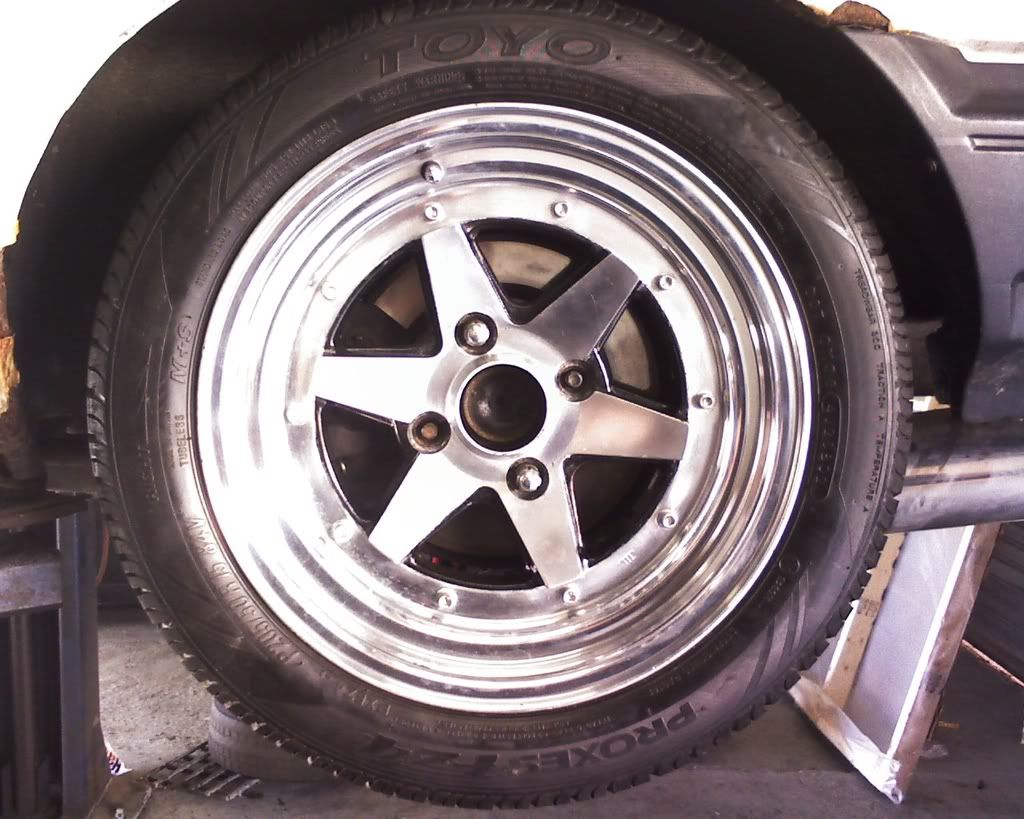

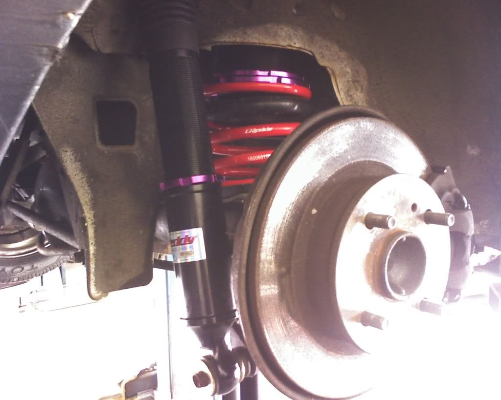

new stance and wheels since the calipers didnt clear the old wheels.
and of course my favorite pic...
she is coming along nice.......

ok so i did it ssr long champs test fit what a tease.lol

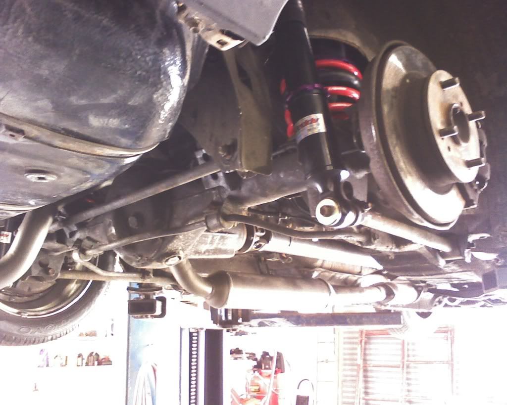

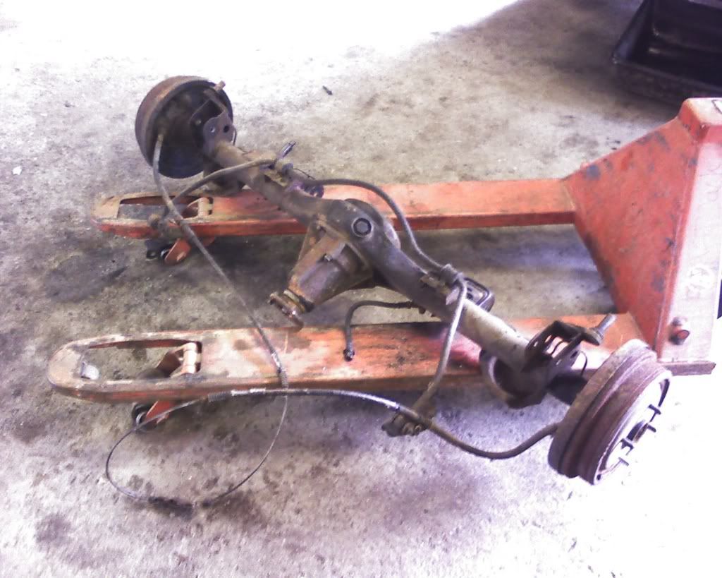

so after much debate and pacience Dan get's my old celica/supra rear.
the weakest link...

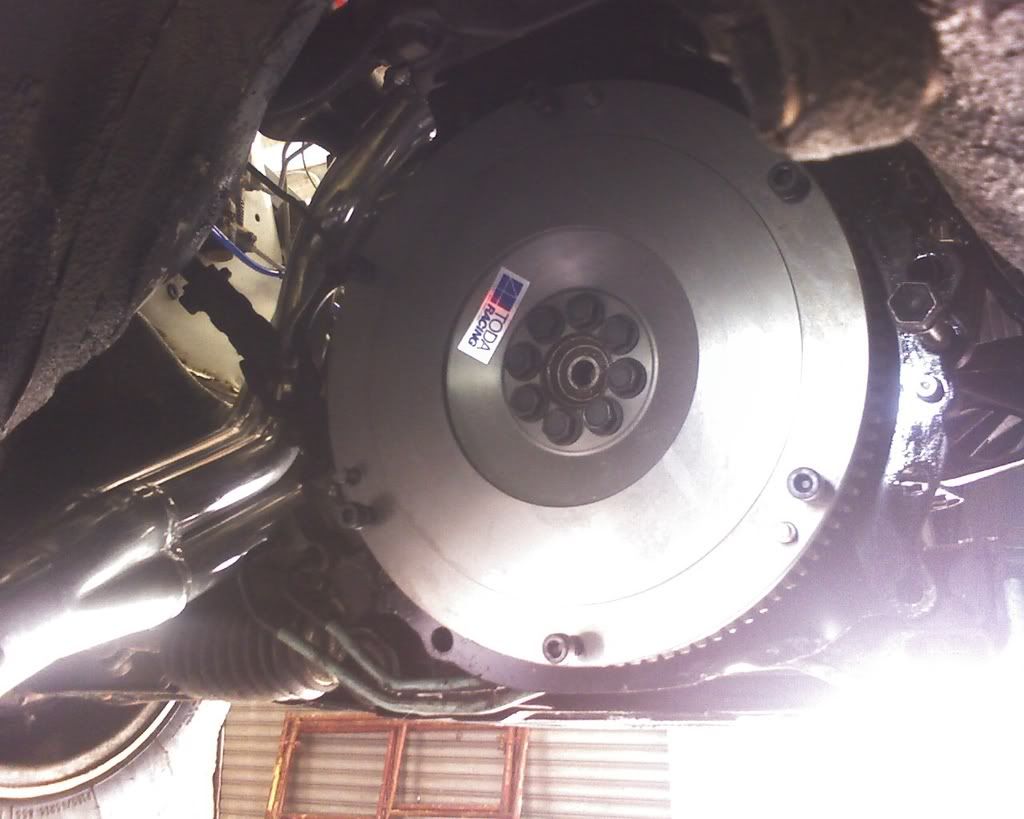

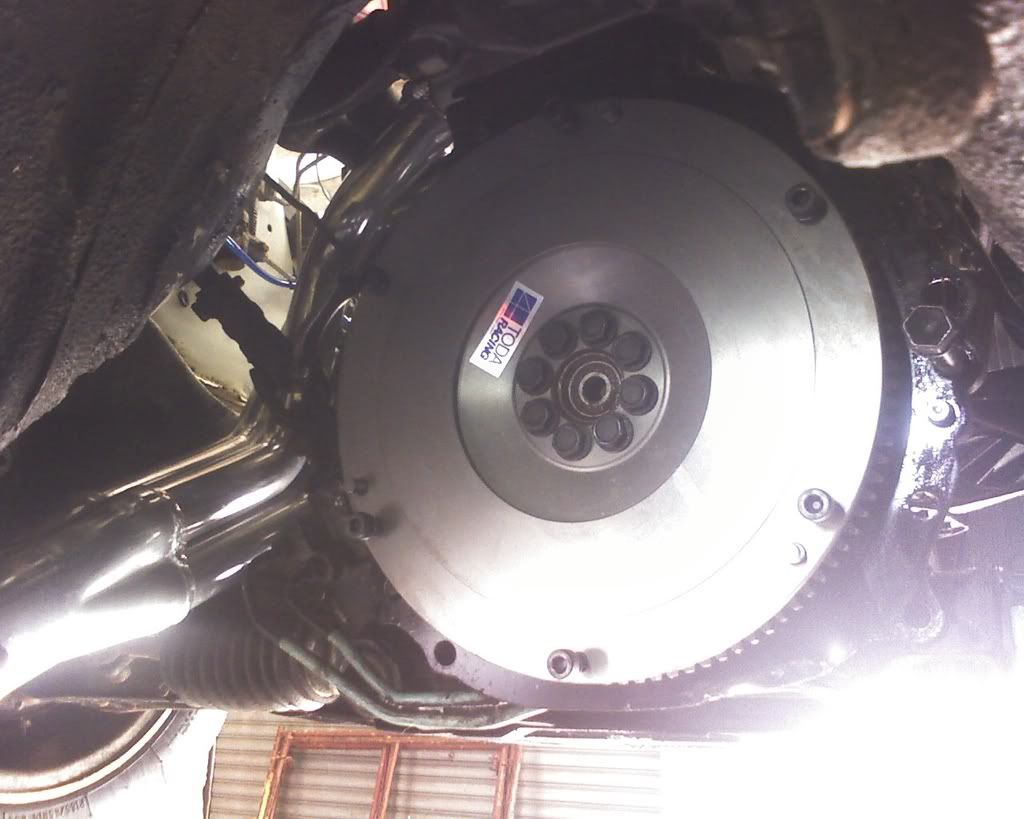

yeah that's a toda flywheel.

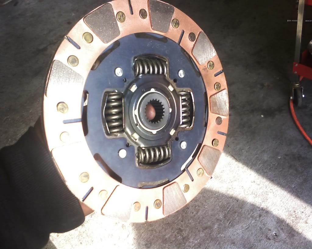

if this clutch slips we have a big problem.

Your gonna want to get an Adjustable 4link in the rear with a panhard bar. Other wise your alignment will be way out of spec. Also the old ass bushing have alot of play and will be very sloppy. Just a suggestion. Also need to get some bits to claim more steering angle.

don't worry you guys will be incharge of that.

oh and will can you email me all of the pics you have so far, maybe a little bit bigger or put them on a CD and ill swing by and pick it up. also i just got off the phone with my buddy thats doing the tires on the new wheels and he said its a HUGE stretch... maybe new tires?

bead blast them bro. and as for the picks no problem i'll give them to you when im done with the hachi.
