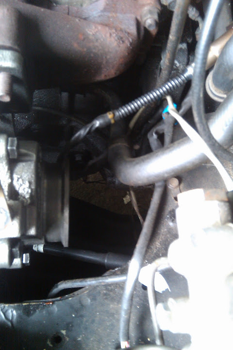

Wow, the same day, two years from the last update. Weird!
So like I said, I just got the MS2 in (bought with a Megasquirt 3 case so I can update the processor soon!). The closed loop boost control is GREAT! Among the various other updated features. It is now running full stand alone, no pussy **** here.
Also, my last turbo blew (**** in the oil passage) so I took a risk and bought a CXracing ebay T3/T4 turbo. Build quality looks great, and it works well so far. all for $160! It also has a V band downpipe outlet, which is great.
The turbo lags, sure, but it hits HARD and thats what I like.
Oh, PLEASE Ignore the ****ty welds. All I have is a Harbor Freight Flux welder, and the welds it makes look like ****. But they do hold well aha.
