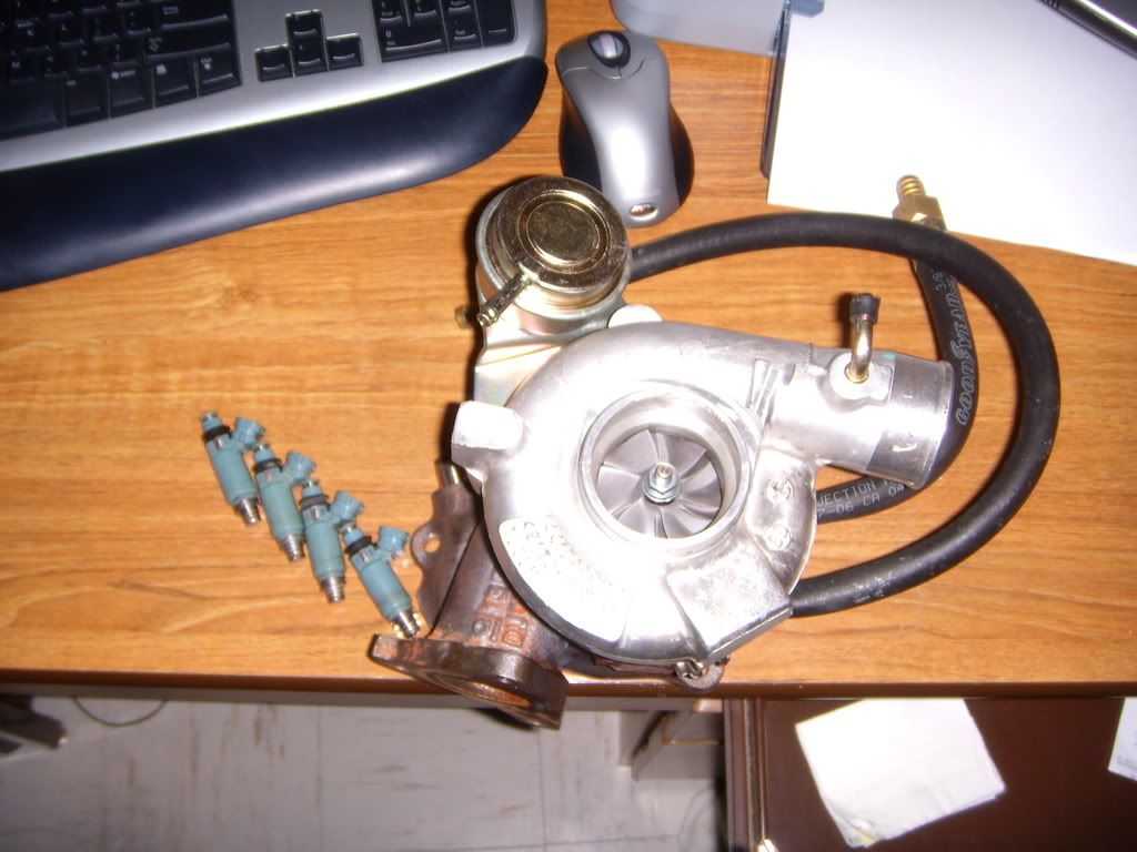

So, i noticed with my 16g that I wont be able to use my stock lines period. What now? Heres why, it will never reach.

the wastegate actuator is turned about 180 degrees the wrong way.

Even if it doesn't reach, you replace the non-restrictor hose coming off the T with a longer hose of the same diameter and there should be no problems.
