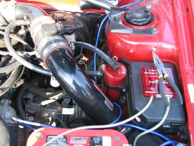

is this sound a leak or my sc
i've been mind****ing myself with the idea that i hav a vaccum leak, this high pitch noise i keep hearing is off and on, wich is the reason i don't think it's the sc
what do you think?

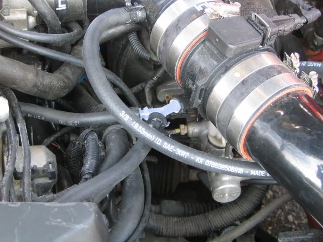

i also fixe my catch can, i'm using a fitting i borrowed from work that's used for feeding tubes
