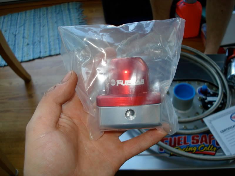

The fuel cell came today, its a 17 gallon tank with a fram racing fuel filter and a bosch 330 lph fuel pump, oh and a fuel lab fuel pressure regulator
pulled the stock gas tank out
i used the ful pump to drain most of the fuel. I just disconnected the fuel line and ran it to the container

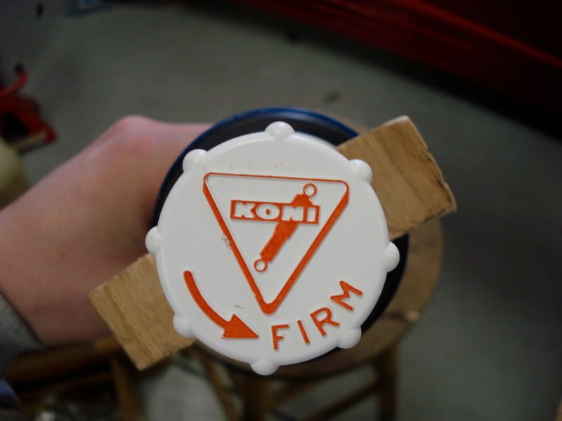

The suspension came in. It is a Mopar Stage 3 kit that has been gutted and revalved with much more aggressive koni inserts, also it was converted to a two-way adjustable. the reason we went this rout is because there are really no good suspensions (in our price range) for the SRT for a road race aplication. So instead of having a 100% costom shock built we bought the Stage 3 suspension to basically just use the casings so we know it will bold up. the springs havent come in yet but expect pics soon.
