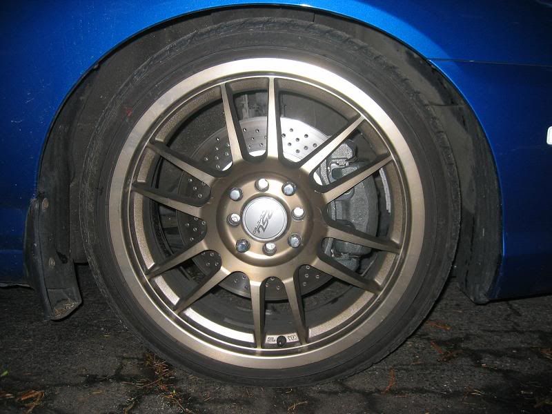

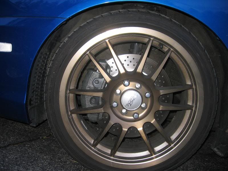

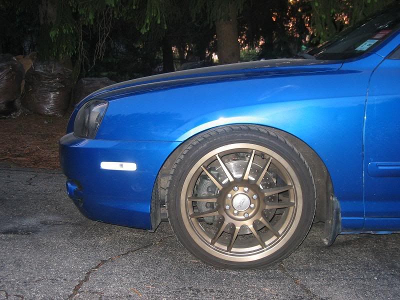

My car can stop now...! Still needs the GO though.
OEM Kit from over in korea...bolt-on install
12" rotors, dual piston calipers, and high metalic content pads
Did I mention I got it shipped from korea overnight for $530?
The rims are 17" for comparison.
I have to do something about my rear brakes though
Pretty, no?
Turbo kit is up next.!

nice, fronts look great, what are your options for the rear? you probably shifted brake bias frontward substantially and your braking would really benefit from improving the rears now as well.

Well I have a GLS model..the GTs came with rear disc so I could go to the junkyard and pick up the rear knuckles and all the parts for probably $200. But the rear discs are tiny. So I might grab the knuckle + parts from a tiburon, which would give me bigger rears but then The hub would be 5 lug. So I would need to grab a 4 lug hub and bolt it on, and then the list goes on for rusted parts I'd have to replace.
I'm really lovin' the upgrade, The term "stop on a dime" has really changed for me.
