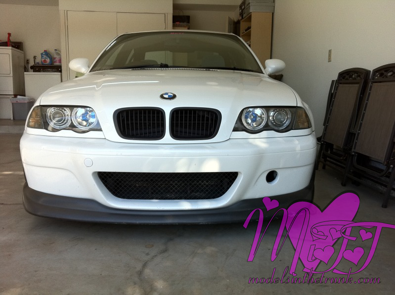

-CSL style front bumper Actually a modified M3 bumper trimmed and Glassed to fit the sedan, needs paint

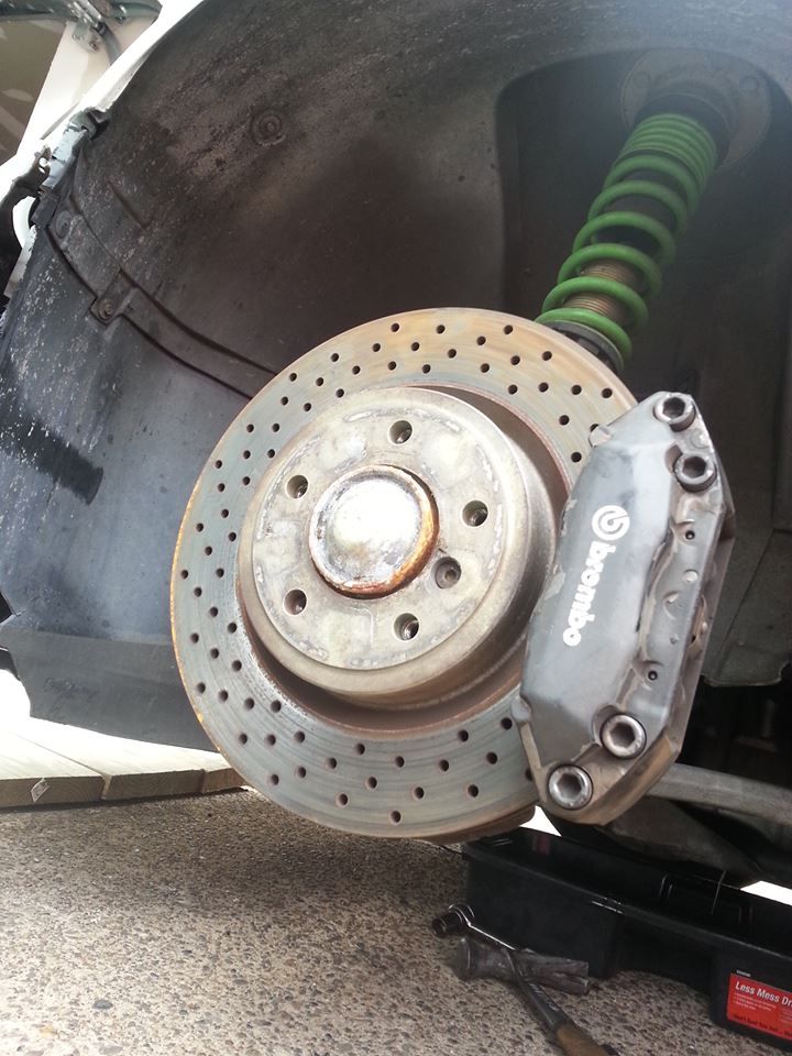

Suspension/Brakes/Wheels:
-Suspension Techniques Coilovers
-Brembo 4 pot front
-OEM 335i (Style 189) 18in wheels w. Bridgestone Potenza RFTs (225/40 front | 255/35 rear) "run flat tires"

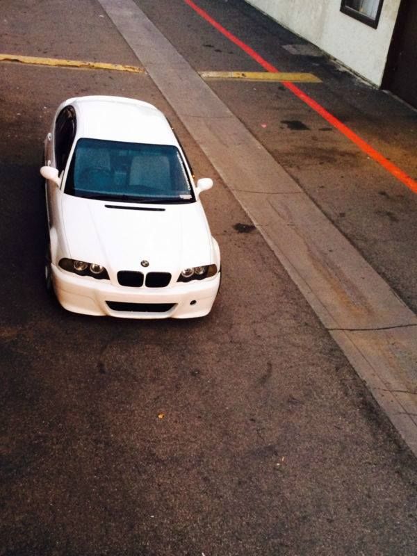

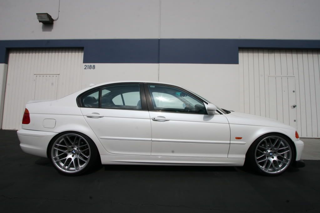

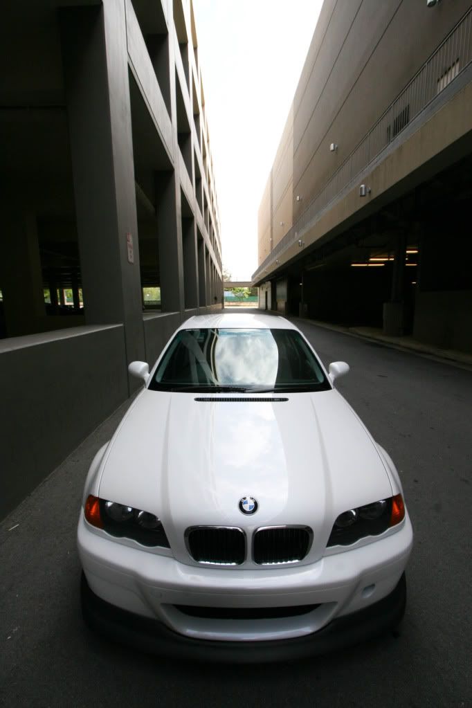

2011 Photo I have found of it.

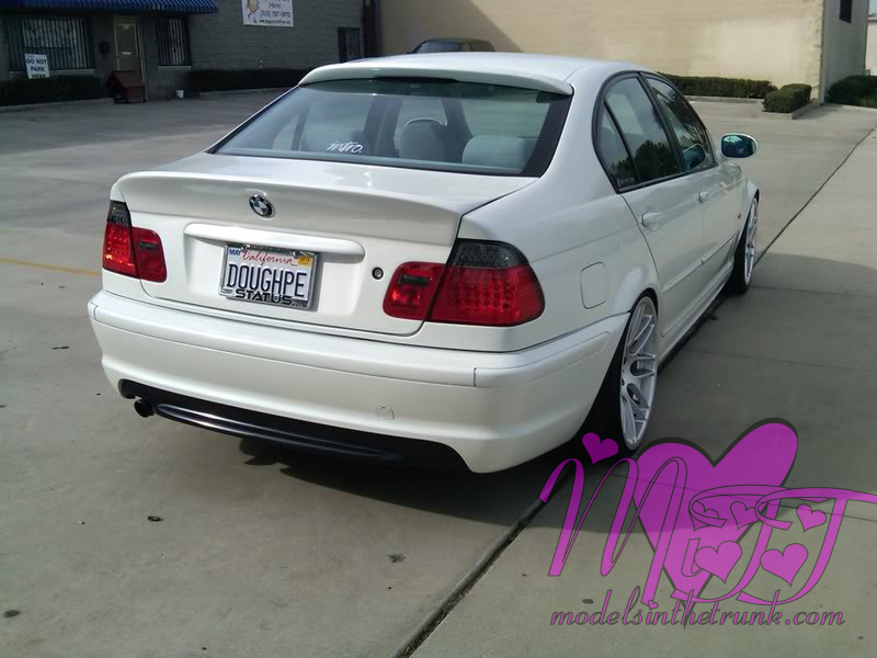

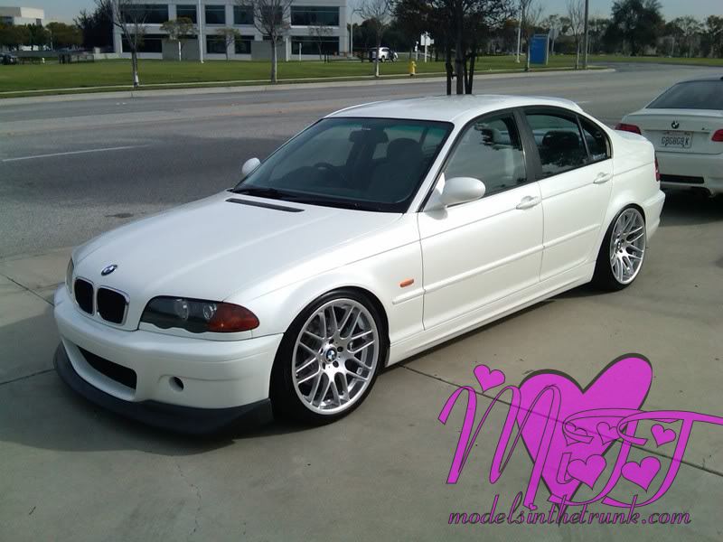

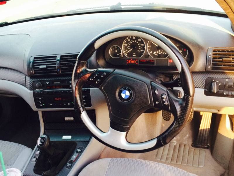

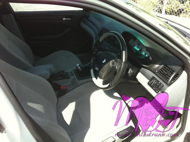

Photos when it was for sale when I bought it.
Notice cluster light and idle and all the crap

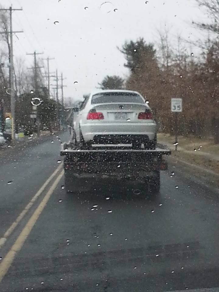

In my hands, got it transported and towed to tot he garage.

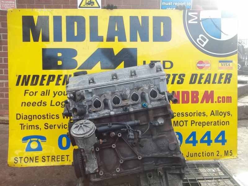

Ordered this from the UK, took 2 months to get here.

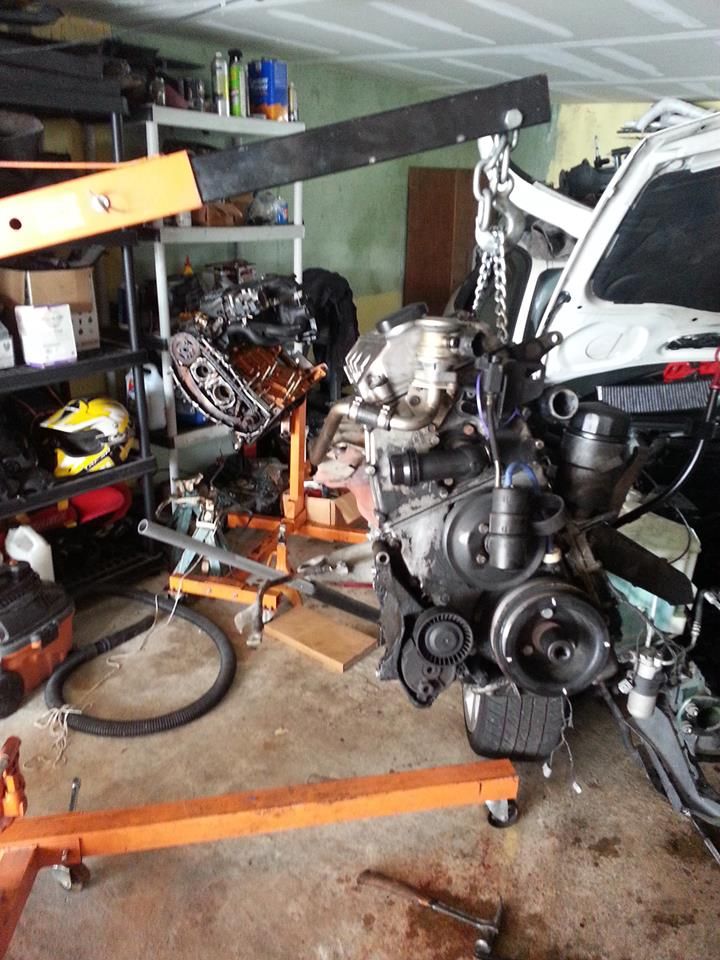

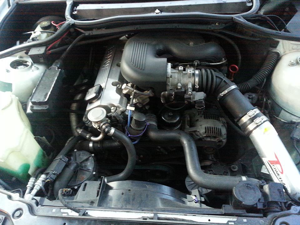

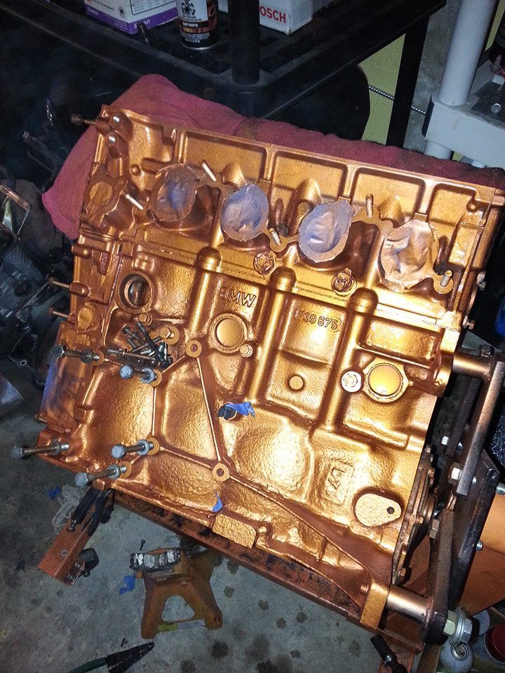

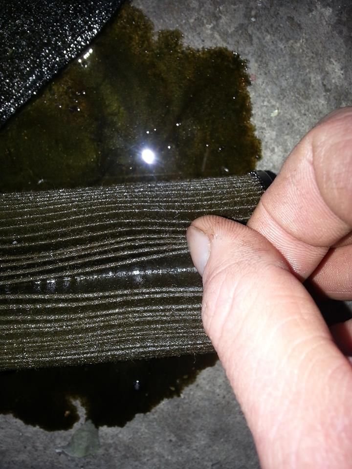

Took it apart kinda to inspect and other than dirty it's good. cleaned it up and I ordered a complete gasket kit, seals, tensioner, oil pick up, tons of o rings, fresh top to bottom. Only snag is I need to order a e36 ac pulley, some e36 specific bolt on stuff, and im waiting on some dealer parts. Painted it copper.

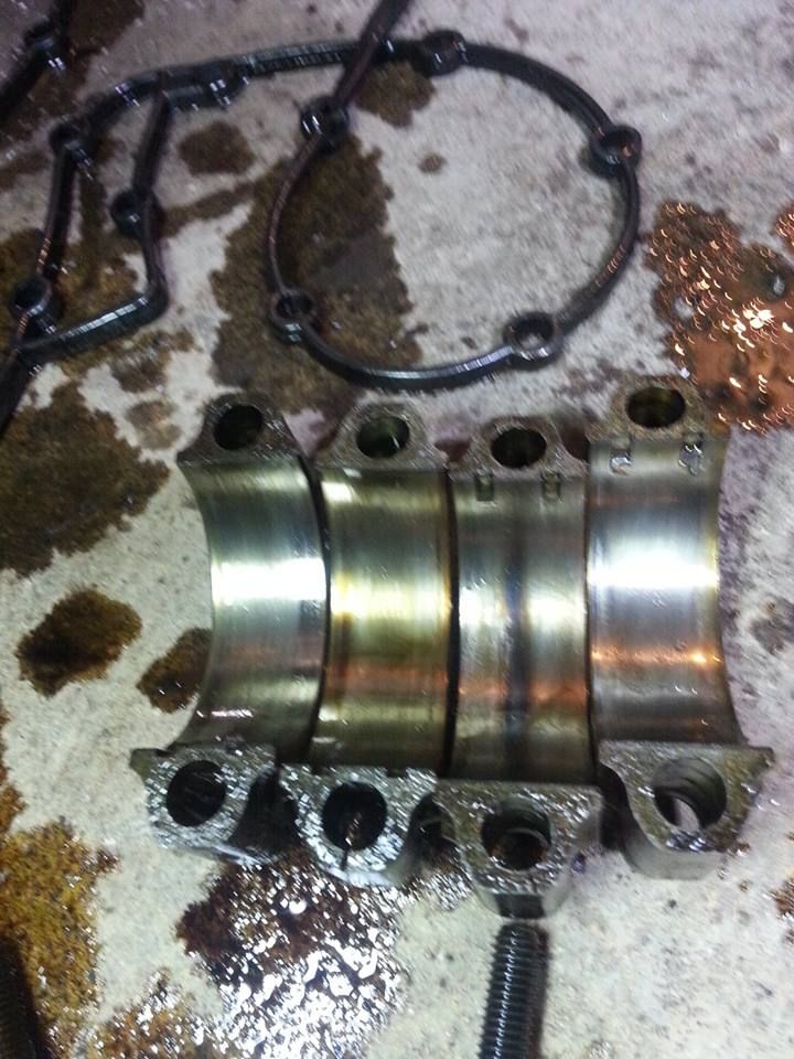

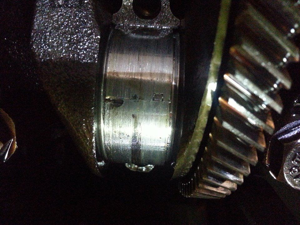

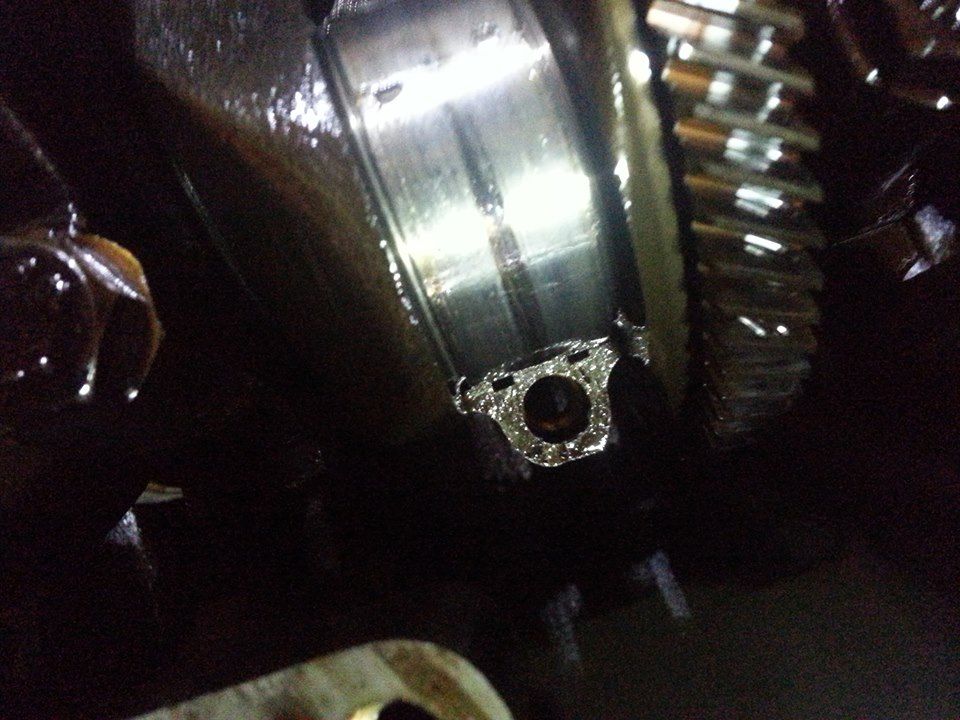

Pulled the bad motor
stripped the good parts I need for the long block and wanted to see what went bad. #3 rod bearing is gone.

I thought it was cool, so I just figured hmm. Parts are surprisingly cheap.
E36 M43 has some difference from E46 but all easily addressed. Crank pickup is pulled mounted on e36, and crank mounted on e46 but some tooth and position count, just need to extend the harness. Timing covers, and oil pan must be used from the e46 due to sensor mounts. Water pipe connectors need to be e36 as they are different size and I need to convert the hose ends to normal vs the euro style.
The head gasket / bolt hit is here and have all the upper gaskets and such, I ordered an oil pan, seals, oil filter housing and other gaskets from Pelican parts. The M43 block is externally the same as M42 and M44, and most parts do share which makes it easy. Trans is the same as a late e36 318 model.
Since the long block I got is low mile and has good comp numbers I'm not going to do a head gasket for now. I may mess with the head off the bad motor. The porting is so small, so I may go to town port matching the gasket, having it cut and serviced. There are a few cams available for this motor too so I may just cam it and get it tuned. Basically just NA tune, light flywheel from the dual mass and drive it like that. Wont be fast but better than stock.

motor is in the car, all fresh gaskets, pumps, seals, water connectors, and some new sensors. Gonna try to get it plumbed and wired up over the weekend and maybe even start it. Picked up a grey leather interior for it. once runing I will need to fix the cluster and then replace with window regulator. The front bumper is at a body shop getting prepped and cleaned up for painting. Due to some waveyness I will be replacing the rear bumper too. I'll grab pics this week, but the engine bay is painted black now. Also picked up another RB motor over the weekend, have been toying with the idea of a rb swap in this, well see.
