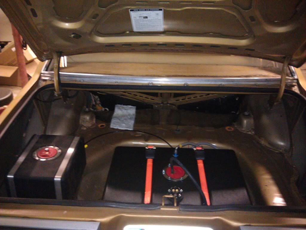

car is running a 16 gallon fuel cell from summit with fuel sending unit, single Jay Racing 044 fuel pump, -6 nitrous feed line for a fuel feed, ebay rails, Siemens Deka 80lb injectors, aeromotive regulator, 3/8s crossover and return line, im running 91+ gas with 70% methanol injection on 10+psi 3 gallon cell in the trunk and twin nozzles in the intake.
