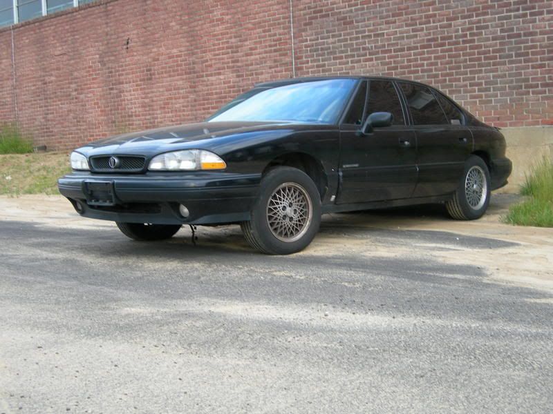

I've owned an n/a 95 Bonneville for 7 out of the past 8 years. I learned a lot of what not to do with my first and made my second much better.

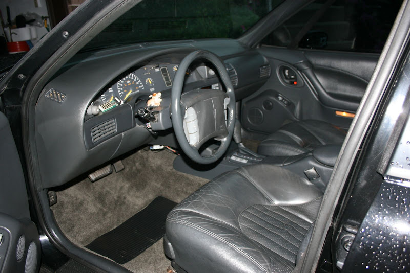

Over the past three years I've done DIY front coilovers, custom rear springs with air assist struts, LS1 front brakes, E39 headlight conversion, shaved a couple things, black onyx 202 paint, new carpet and headliner, and spaced out some Super RSes.
I did cam/heads/headers and pretty much every n/a bolt on (3800 series 2) but the engine is very very tired. It burnt a lot of oil and had poop compression. (wet test confirmed rings)
I had been planning a new n/a build for a while now and it was scheduled to go down this winter. A very nice lady decided to cut infront of me as hard as she could on 95 to apparently avoid and accident a couple weeks ago. This had me trying to squeeze between her and a jersey barrier. I never hit her but I did hook my wheel on the barrier, pop up slam down, poked my hood with my strut, bottomed out my subframe, crack my trans, ruin one of my Super RSes (fml), and scraped my mirror.
So, my build started a little early.
