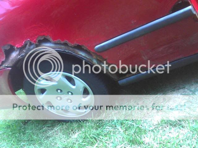

yeah so i just bought the car and moved to the area i have honda rusy baddd im looking for someone to help do the body work or who would do it for cheap. ima college kid i gotta save my money

that's by far the worst i've ever seen. the inside of your car is completely exposed to the weather. at the bottom, along the pinch weld, there's probably little to no metal left. you have absolutely no choice but to put an entire quarter on it, and that involves some serious body work skills. from a shop you would s*** yourself when you saw the estimate, so unless you find someone who would do it for cheap as side work, then you're pretty much screwed. cheap will mean garbage work 95% of the time, so the rust will just come back anyway.
please, whatever you end up doing... DO NOT let anyone try to cut out the rust and put in patch panels. a lot of hack body techs will tell you that it's the right way to go but believe me that quarter panel is so far gone, there's no way you could ever patch that and expect the rust to not come back. besides, you'll probably just end up with inch-thick body filler.
i wish i could tell you i'd do it for a reasonable price, but that right there is a pretty large job, and i just don't have the time at the moment.

seriously itd be cheaper to buy another shell thats really bad

Either get a new quarter on, find a shell and convert over, or better yet, part the car out, junk the shell (scrap it for cash), and with the money you made buy a nicer condition one. ****, engine and trans should get you about 500 I'd assume.

fill that up with foam in a can. let it dry. shave it off with a knife. bondo over it. rattle can over it. and keep driving your car til it dies.
