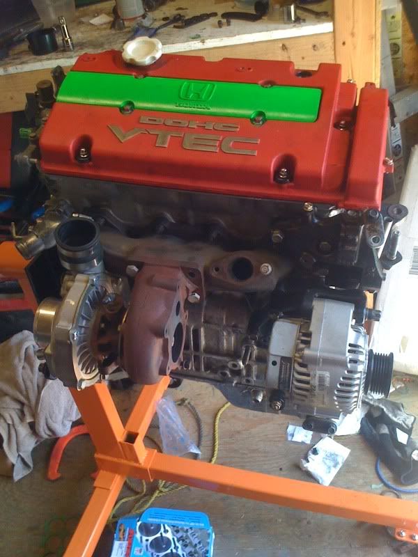

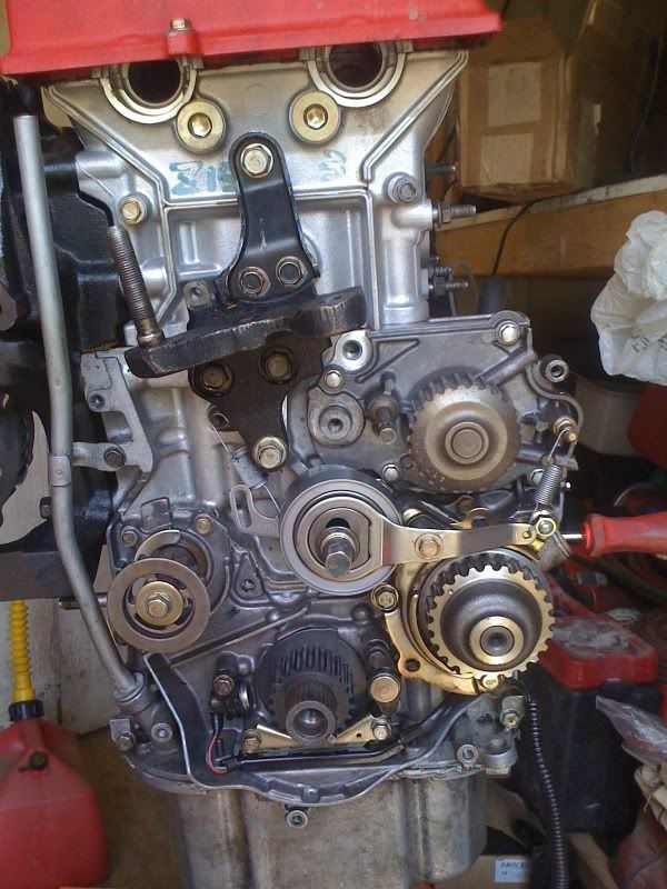

Been in the garage...
putting this beauty together for a day.
Fully sleeved- Darton close deck sleeves
ACL race bearing
Arp mains and rod bolts
Eagle rods
CP pistons 8.5-1
Micro polished crank
H23 manual tensioner conversion
Stock head for now

lets see some pics from under the pan...

thanks guys. Im not taking all that bs off to show you a girdle rich. Your crazy.

dude its not even that... you should really inspect it before you go and install it...
what if the dude sold you a ****ed up or stock block?

Hmm built motor goodness. Very nice. Did you pick up the block used? What turbo? This motivates me to send my head out and get my motor together.
But why the cheap cast manifold, that wastegate placement isn't the best.

Rich.... Relax. I have inspected it. I'm just not taking everything off again for pics. The manifold is jut for now because I'm in love with a/c and p/s... It's going in my 99 prelude. And rich, it's not even close to stock lol. If I took the headgasket off when I took the pics you would see the sleeves, etc

Hmmmm a/c is a good thing. I can understand that.

with this current manifold setup prob only around 330ish... but if i get a new manifold, DP, and injectors umm maybe around 420. Its just a street car. Anything over 400 tho and i should be looking for a better turbo. My pocket is already hurting lol. Maybe next year. Block is capable of 500-600 Hp. But if i switch out rods for the manely I beam rods, I could put way overr that. But since I don't have that kind of money, nor the desire to have a car with that much hp, it will likely stay around 400
