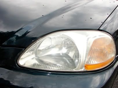

Didnt think this really worked but seen it on clubcivic so figured i would give it a try. I had pretty bad yellow foggy headlights so i had the guy at my work was going to charge me 30 bucks to clean them up for me like sand it down and clean it all that nonsense. but i seen this. Just use toothpaste!
Before:
After:

Really doesn't look that good.
Use a 2.5 inch rotary with a felt pad and plastic polish. That will make it clear. Still it's never gonna look like a brand new lens.
I went to a detail clinic at poorboys world and this was one of the things people demonstrated.
I should have taken pictures but my girls car has a new headlight from a car crash and an old headlight that was yellow. I polished the yellow hazy one and got it clear but it still never looked at good as the new one. Problem is the headlights get hit with debris that causes cracks to form on the inside of the lens that you cannot get to.

you're telling me that doesnt look better then it did? You're out of your mind lol. From what it was looks alot bettter. It doesn't do the best job but for free it does the right job.

I think what he was trying to say is that for a free mod, sure it's an improvement. But it's by no means clear or "good". If you really want it to get clear again (again, like he said can't get it perfect) you're gonna need plastic polish and some kind of mechanical help.

Doesn't last that long, even with good compounds after extensive wetsanding yellows again over time. Best is to remove all the factory clear and oxidation then clear with a high quality clearcoat.
Another forum I'm on a guy is using packs of 'headlight restoration' kits from AutoZone to 'buff' the shine back on his carbon fiber hood... all by hand LOL.
My buddies Civic, wetsanded till it was consistently dull w/ no shading with 400 then worked to 2000 and buffed. Look bad again, not quite as bad as they were, but it's only been 2 years.
