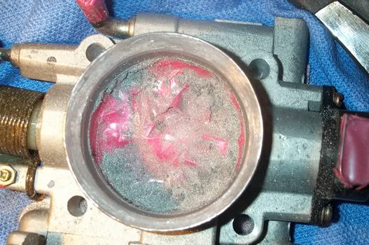

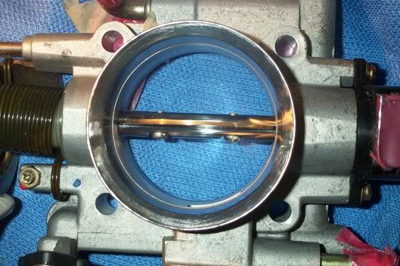

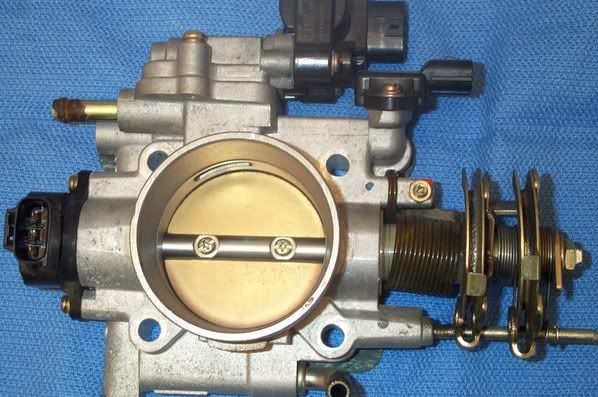

i got home from work today and it was soo warm out ! I thought to myself, it would be silly to not work on the car today. so i decided to port and polish my throttle body.
here are some shots
before
before (notice screws sticking up)
during
after
the car felt a little more responsive afterwords. almost the same feeling you get after doing ic hoses, just not as much.

thanks guys. I left the bottom little shoulder just in case it effects idle. and left the top slightly blunt to avoid it cutting into the silicon hose.
i used a carbide bit,sand stone, flapper wheel, crytex bit and finally a polishing wheel. The whole project took about 3 1/2 hours. not bad, but man my arm was numb after.

so did you just work on the tb inlet and not the outlet? doesnt look like you messed with the ridgd where the flapper seals shut... i didnt either.
i really only worked with the first inch or so of my tb inlet to taper it a bit because i didnt want to go too far and mess anything up.
its easy to get to so maybe down the road i'll work on it a bit more.
anyways, looks real good and i'm interested to know your technique on this and what you did and didnt touch.

Exactly what i did. about an inch. I don't want to mess with anything that may need to be there.
Did you do the throttle body coolant bypass? I was going too, but i don't want too until i know exactly why it is there to begin with.
