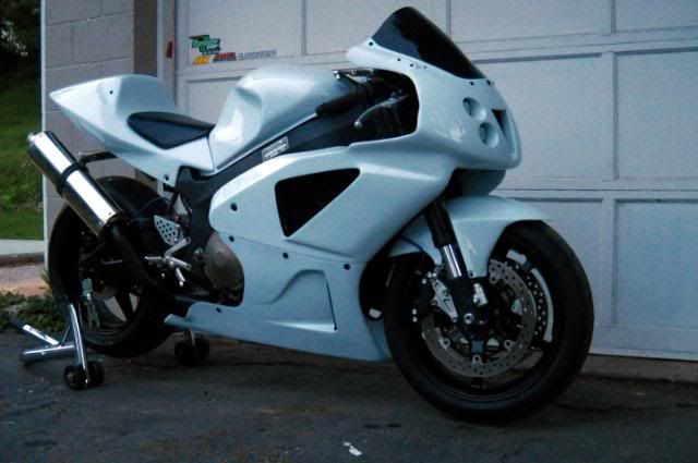

I've got what look like HID headlights.
They're actually "Blazer" fog lights I molded into my track plastics. I'm using the 35w DDM kit with 5k bulbs. Light output is superb.
I'll have to get some night shots here shortly.
