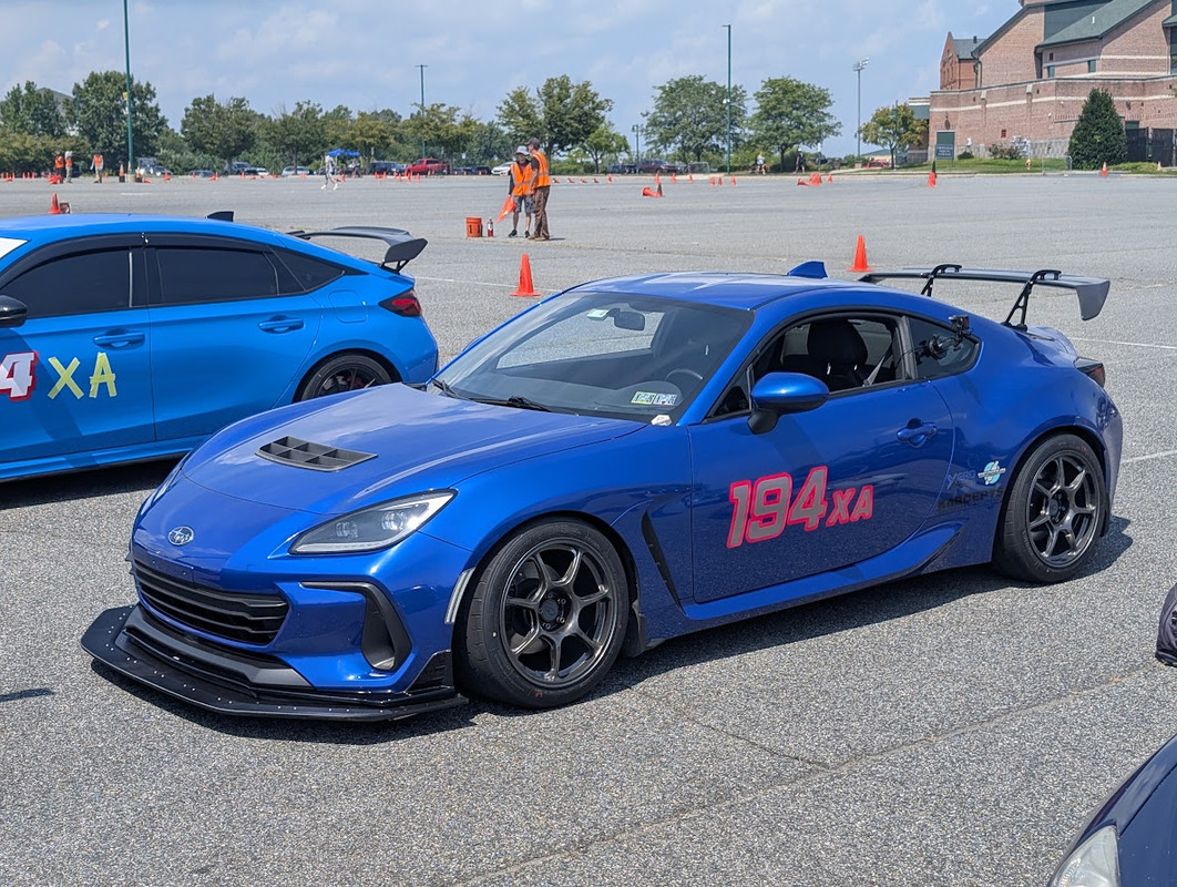

I've been bored and spending time on some aero improvements. Started with a nice rounded/extended nose for my splitter, designed it to snuggly fit to my Racebred splitter (which is mounted upside down) and printed it out in ASA-CF

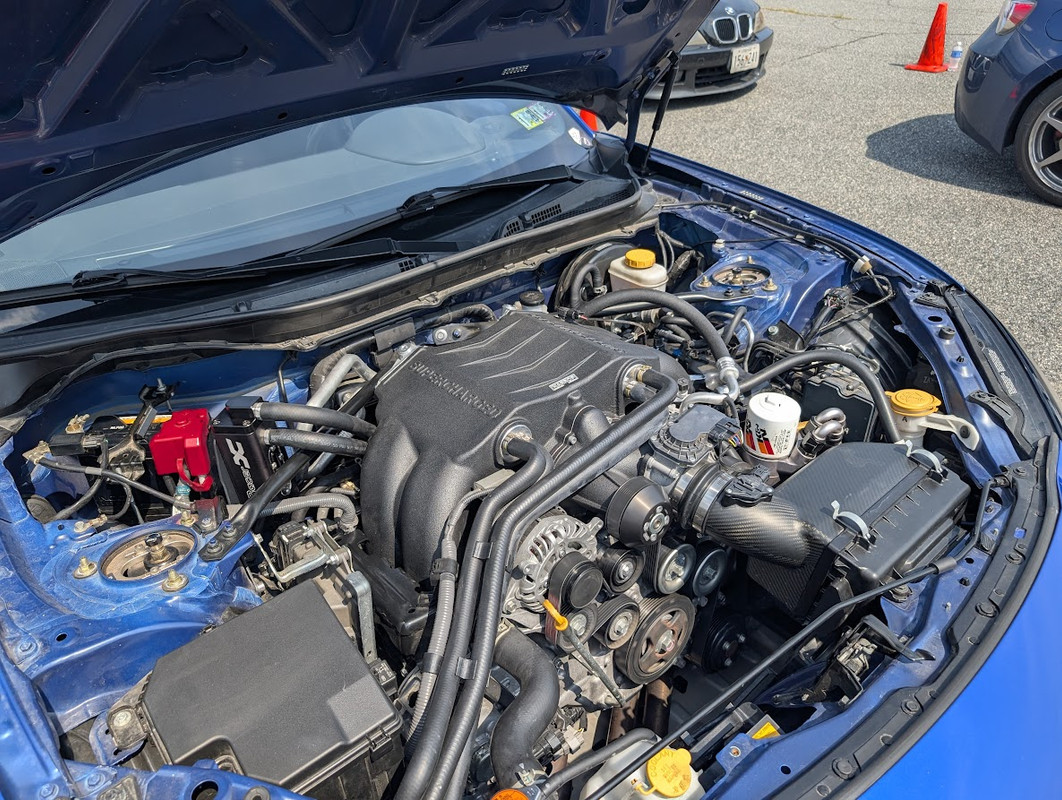

Installed a Harrop supercharger yesterday. Really easy install, only a couple of "hmm" moments when reading the instructions, haha. Bleeding the coolant was the single most time consuming aspect of the installation process!
I'm working with Xero-Limit on the tuning and he's made great progress in just a couple of revisions driving around on the street to adapt his knowledge from first gen kits to the second gen kits. Car feels great and we're not pushing for power yet, I'm hoping for ~325whp on a Dynojet (probably like 275whp on Xero-Limit's Mustang dyno, it's a heartbreaker)

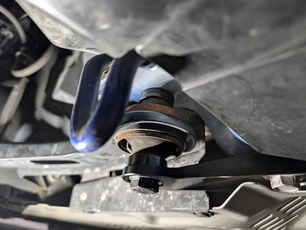

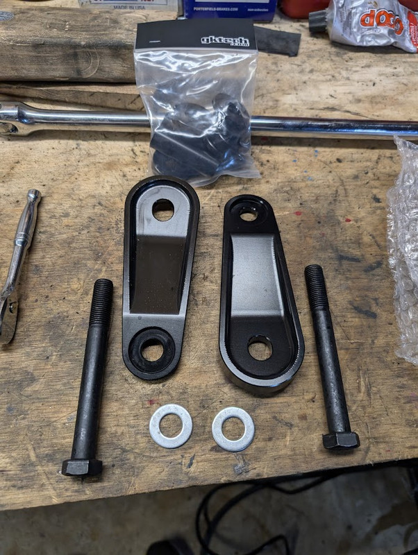

Last night I installed the GK Tech anti-dive kit. I like that it's adjustable vs the Jackson Racing kit, but it's "the same" for all intents and purposes. Tom had given me feedback on the car saying it's a bit "bound up" feeling on initial braking and sort of "snaps" into the turn as you release the brakes, hoping this helps and if not... I can put it back to OEM anti-dive easily.

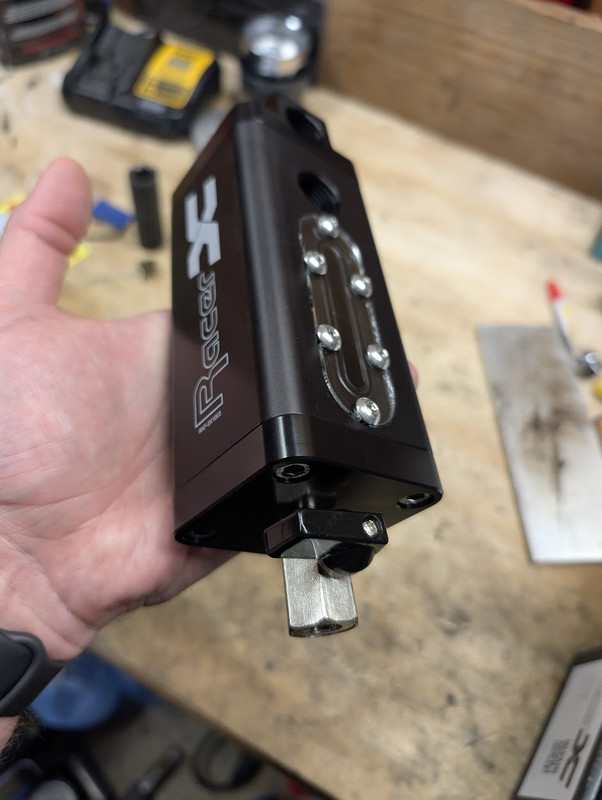

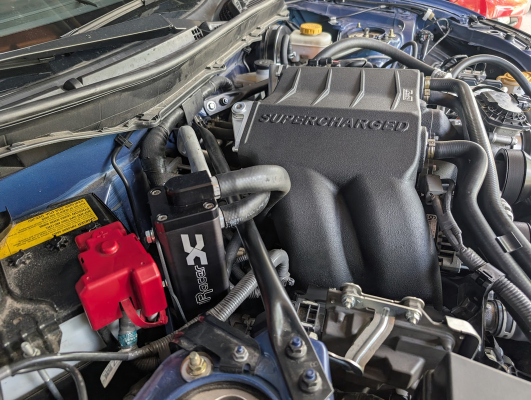

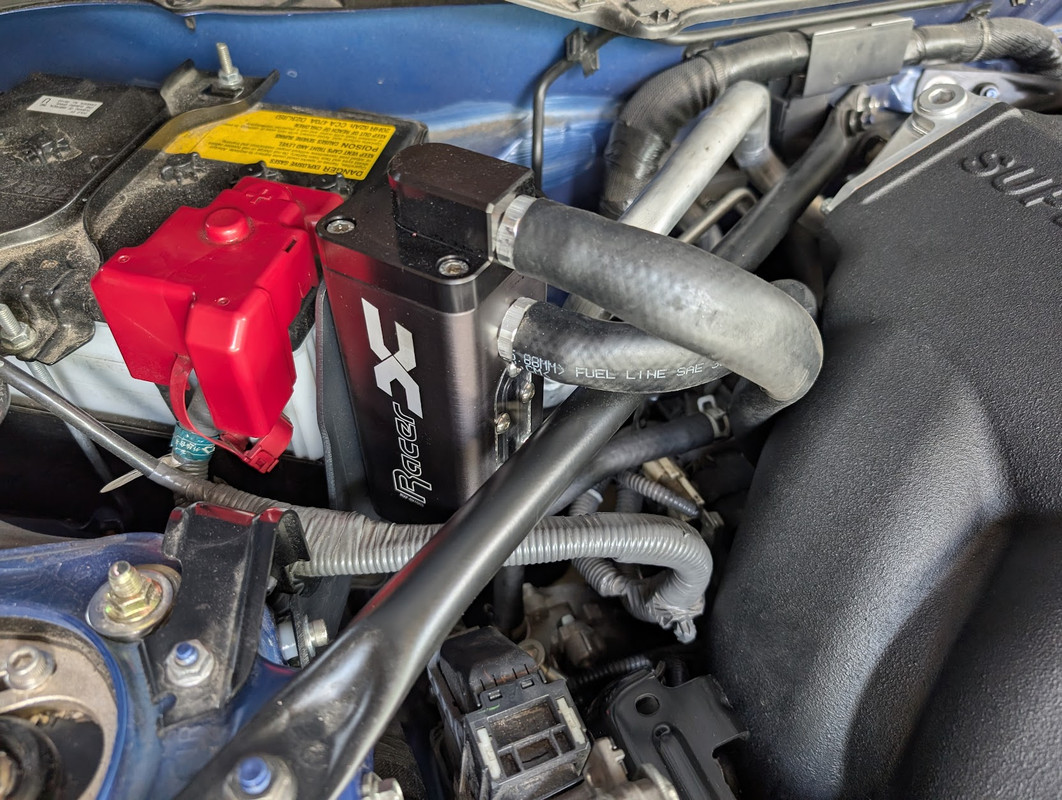

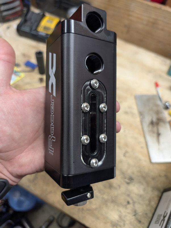

Installed a RacerX catch can, I get a little bit of smoke on starts after an autocross event. I'm running 1 quart overfill so it's occasionally done it but the supercharger has definitely made it happen more regularly. The install is a bit of a pain with the supercharger, but still easy enough. I don't love the routing of the hoses and they're easy to kink so I'll be adding some internal springs to the hoses to help prevent kinking/collapsing.
The can itself it *super* nice and seems like it will be really easy to drain.

Got to test my car yesterday at a Philly SCCA event at Ripken stadium in Aberdeen. Kind of weird surface, but useful enough for making sure the anti-dive changes did what I needed and that the catch can worked as intended. Glad to report the catch can worked perfectly! I did slide some stainless spring stock inside the tubes to prevent kinking/collapsing.
The anti-dive is interesting. I'd like more time on this setup, but so far they feel like a positive improvement. It feels easier to control the weight transfer to the nose and the front of the car seems to bite into the surface a little more on hard braking and trailing in.
