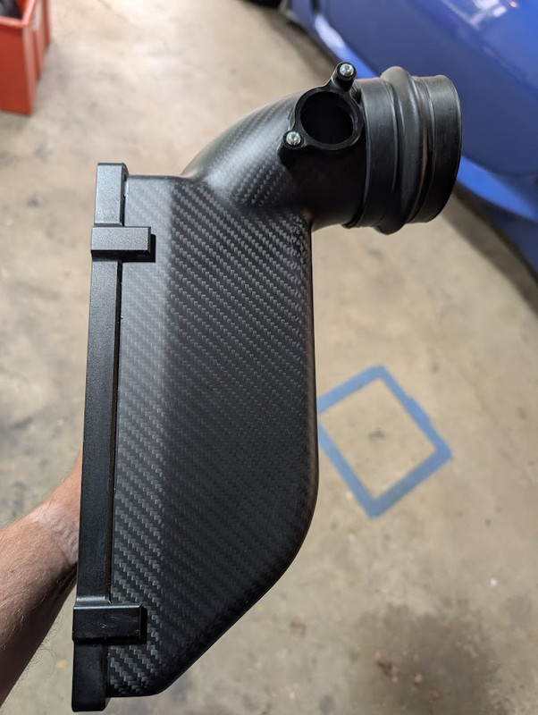

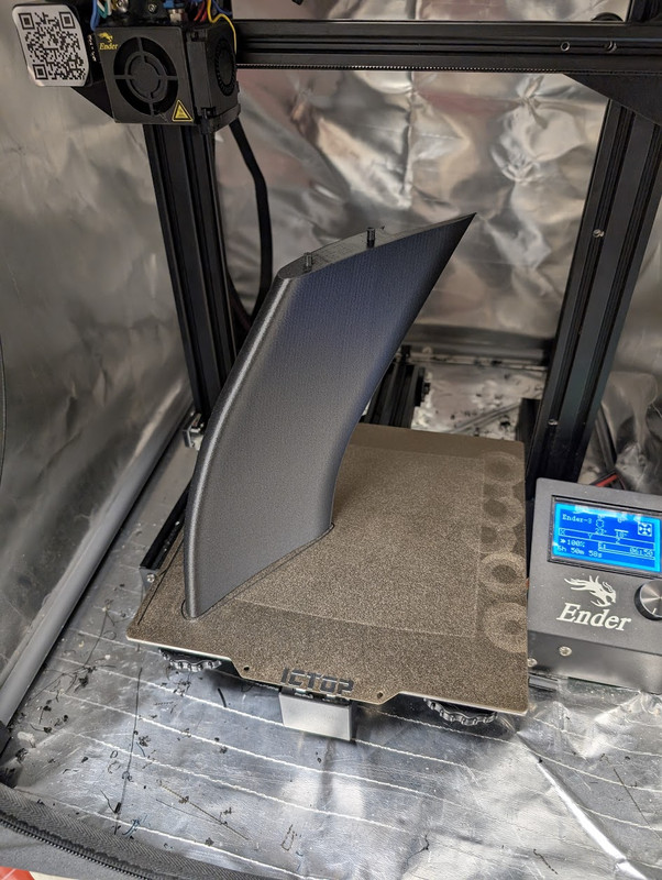

Designed and printed some stuff inspired by another guy that's been doing 3D printing for his first gen twin.
Battery adapter for my Noco NLP20:
Snazzy looking door mirror "wing" to help with buffeting:

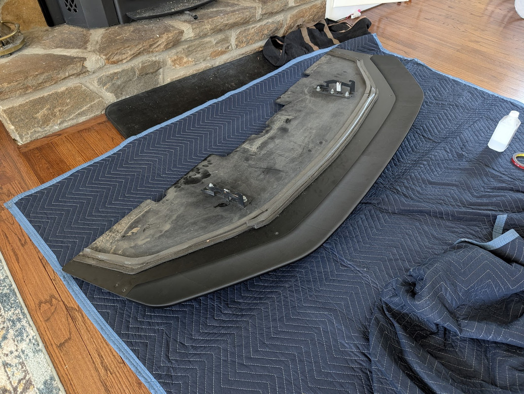

I've been bored and spending time on some aero improvements. Started with a nice rounded/extended nose for my splitter, designed it to snuggly fit to my Racebred splitter (which is mounted upside down) and printed it out in ASA-CF

That splitter extension looks clean!

Thank you!
Worked on stiffening up my splitter mounting for when I add splitter diffusers. The Racebred mounting is totally fine for the diffuser when it's totally flat. The ends/sides are less stiff and if I'm cutting out a big piece of material to put in a diffuser I needed to support it properly. This was ~$35, used OEM holes in the chassis and only required light trimming of the fender liner and drilling the splitter for the elevator bolts. Plus it's all hidden so I don't look like *too* much of a ricer driving to work

Splattered a deer on the way to autocross yesterday. Car is fine besides the broken/destroyed half of the 3D printed splitter extension I had made.

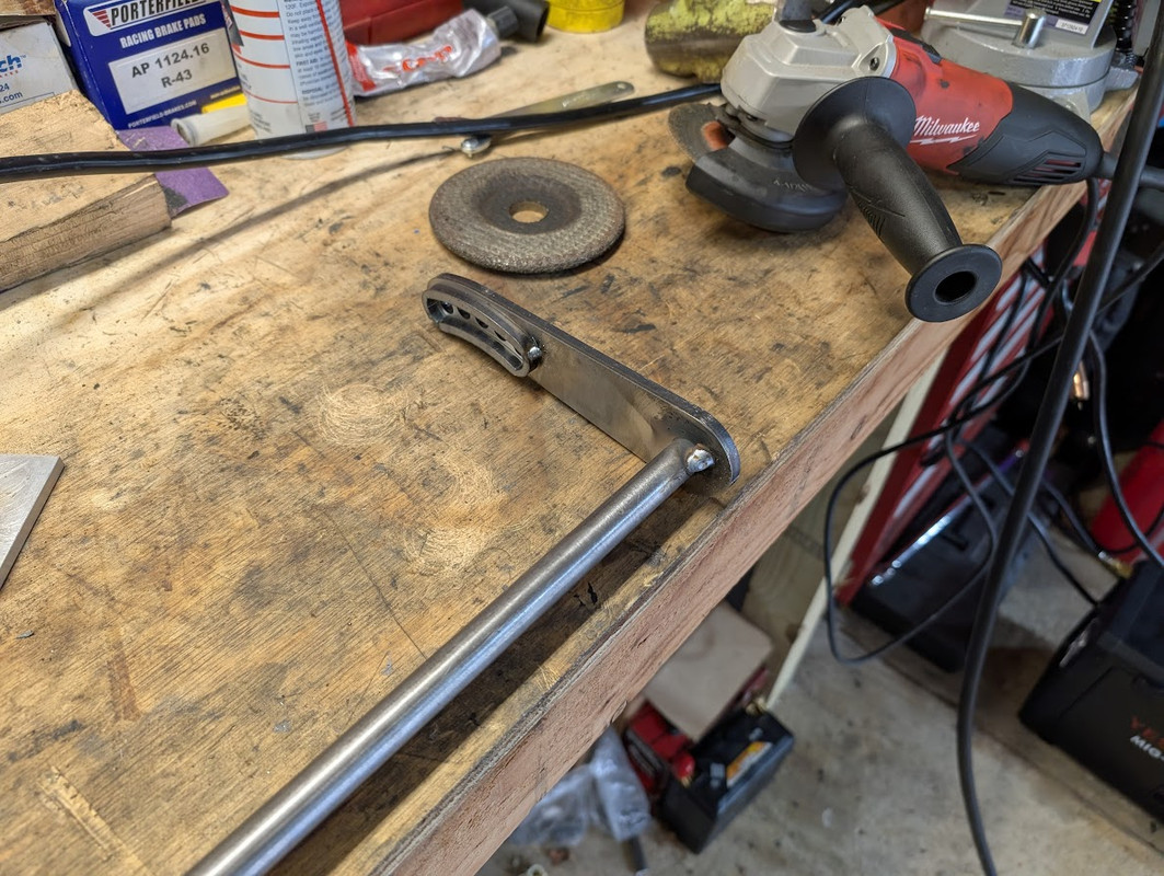

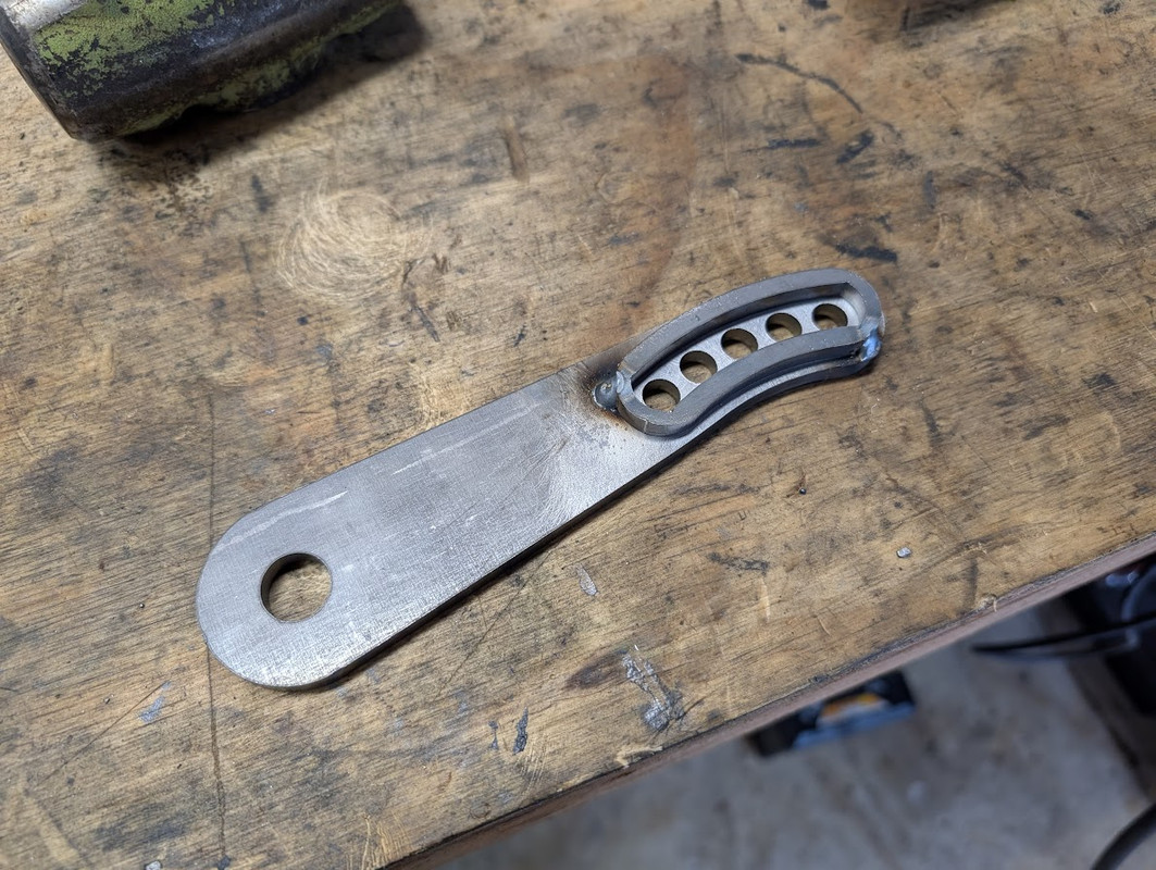

Designed and fabricated a new rear swaybar with Karcepts style adjustment path and geometry that's correct for my rear swaybar geometry correction kit (that Ansix Auto is now selling as a product). This swaybar was inspired heavily by David Whitener's swaybar that he posted on Thingiverse a while back, so big thanks to him for sharing: https://www.thingiverse.com/thing:6591373
I did some testing this past weekend and it works great. I might build a second version that uses a bigger diameter tube so I have more adjustment range instead of being maxed out, but that can happen later this year.

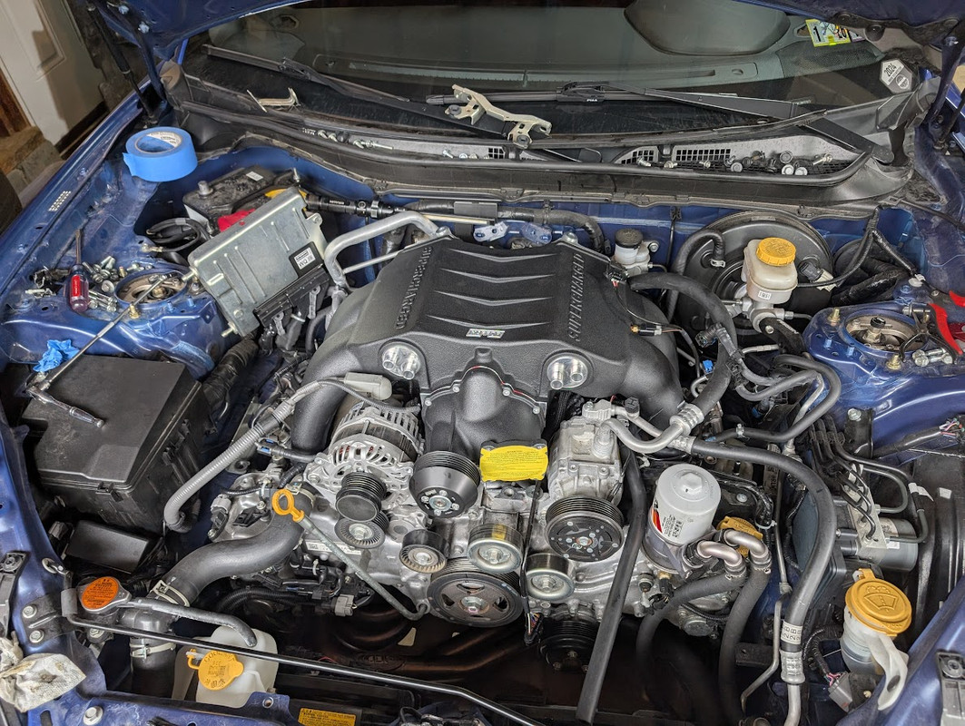

Installed a Harrop supercharger yesterday. Really easy install, only a couple of "hmm" moments when reading the instructions, haha. Bleeding the coolant was the single most time consuming aspect of the installation process!
I'm working with Xero-Limit on the tuning and he's made great progress in just a couple of revisions driving around on the street to adapt his knowledge from first gen kits to the second gen kits. Car feels great and we're not pushing for power yet, I'm hoping for ~325whp on a Dynojet (probably like 275whp on Xero-Limit's Mustang dyno, it's a heartbreaker)
