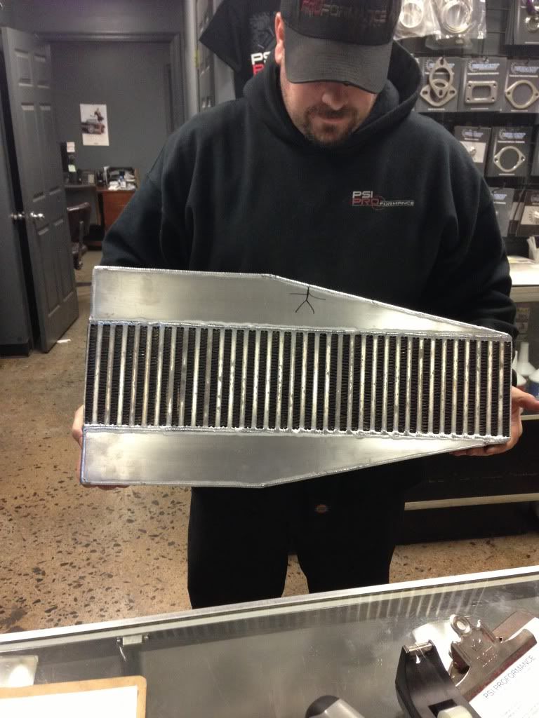

Intercooler isn't installed yet, but a lot was done today. Sneak peak:
