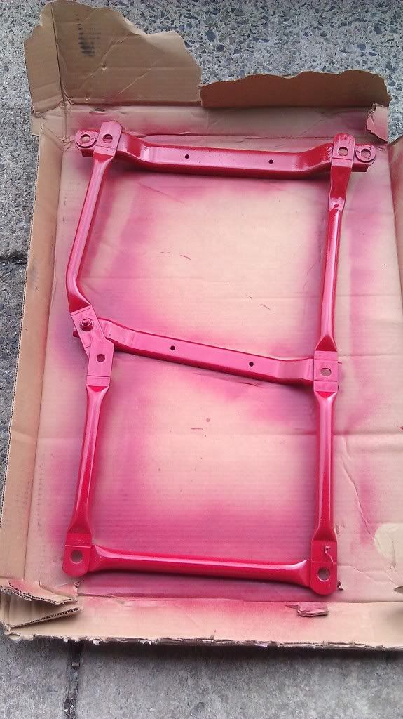

It's definitely to be done soon. Meantime, today I started some painting because my chassis pieces came in earlier than expected. I had 4 cans of this red paint, we bought them back when momma dukes had a 97 Civic HX, no idea why so many, but at least its less to buy now. Here's one finished, both sides are like this, pretty happy with it.
Where can I get Black and Silver POR15? There's a few other thing I'd like to spiff up (control arms, pinchrails, exposed belly braces)
Also got the rear hook on. No I'm not overloading this thing with red..
