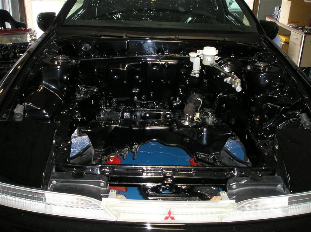

91 Eclipse GSX Restore/Rebuild 1000 hp goal

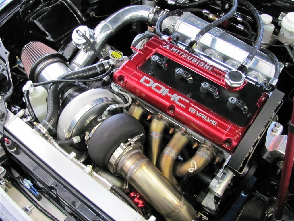

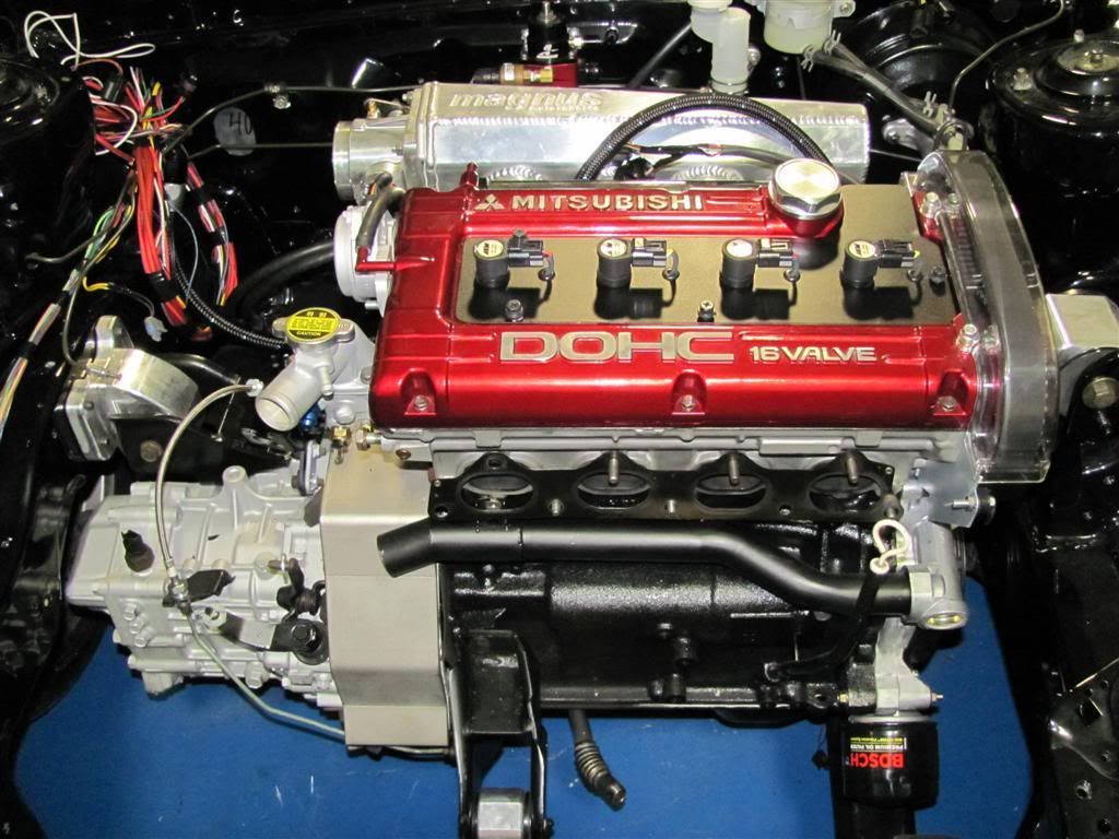

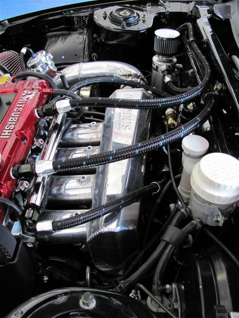

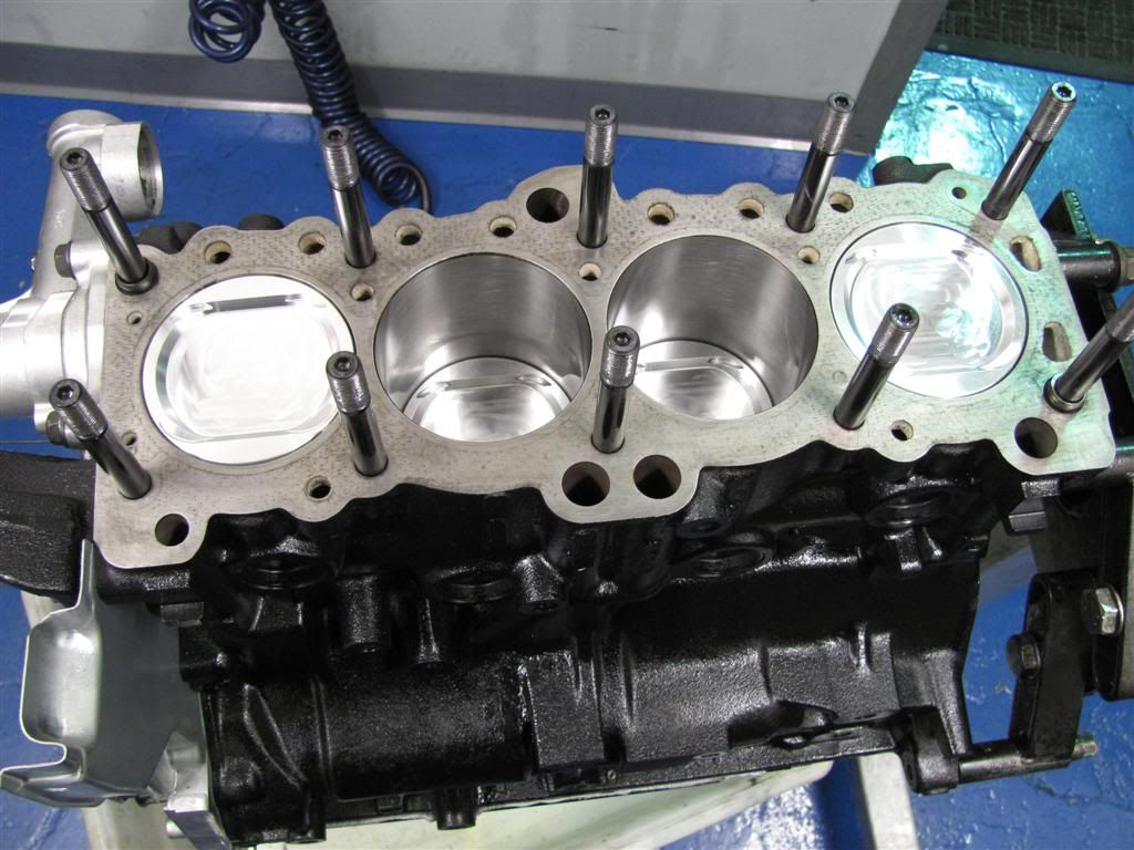

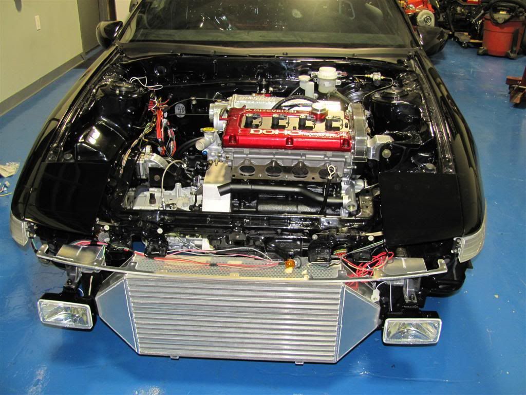

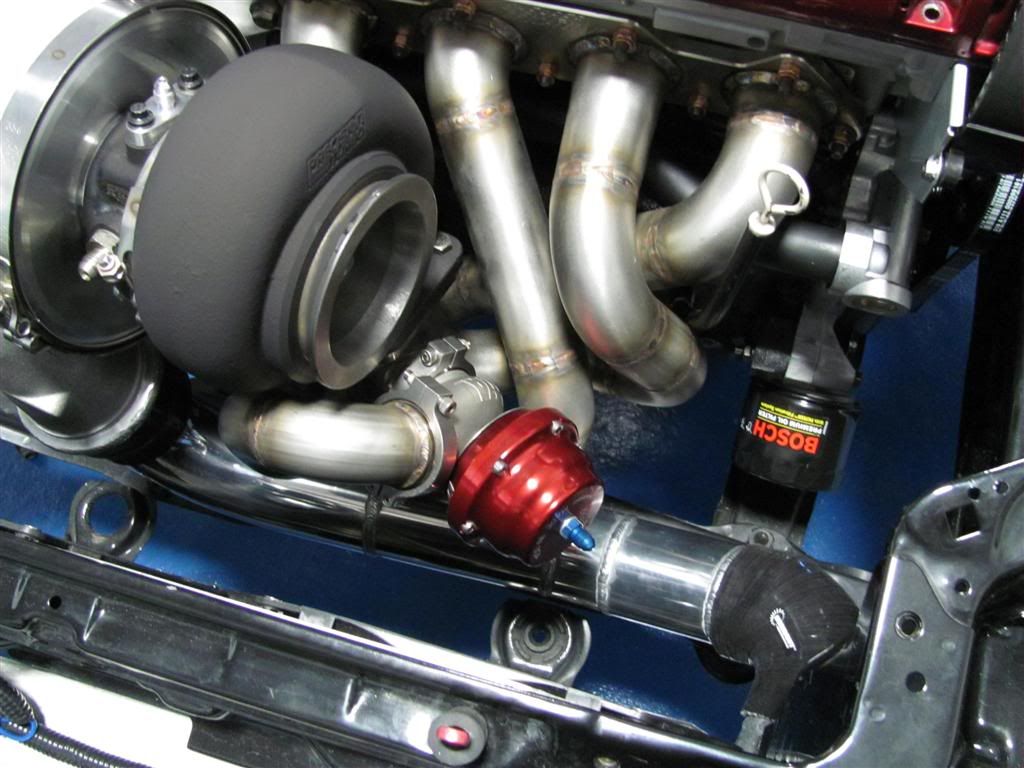

Here is a 1991 Eclipse GSX that we stripped down, sent to paint, and now we are in the process of putting it back together. We are doing custom suede interior panels and building the car to handle 1000hp. The turbo set-up will be redone for next season. Check back for updates.

Wow sweet 1g! This is a car you can say, Damn that is clean! Nice work.

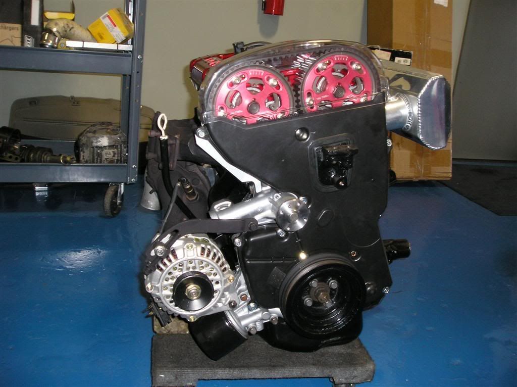

UPDATE!! Customer decided to change direction with the build and now would like to make 850-1000hp! The engine is coming back out and getting a full rebuild. Stay tuned in the next couple weeks for more updates.

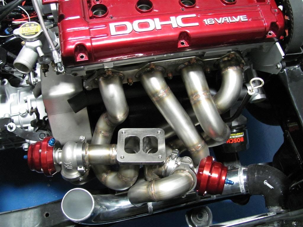

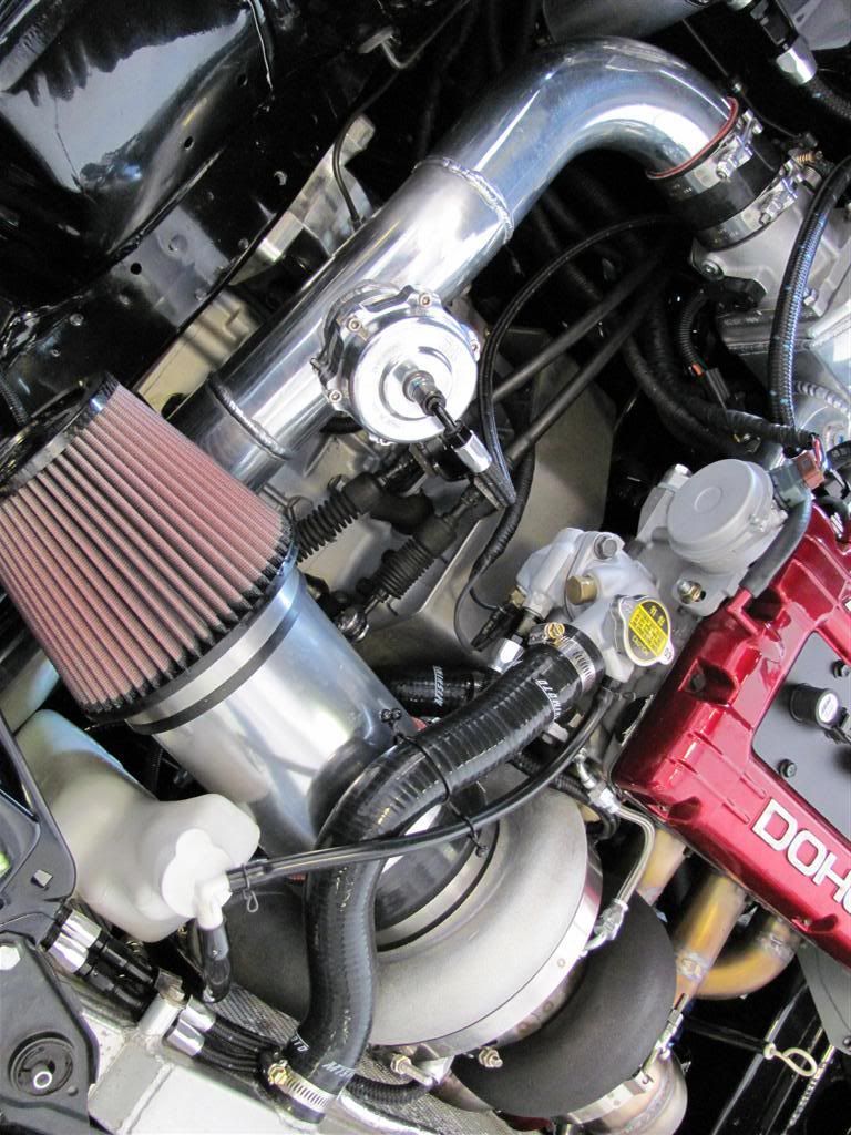

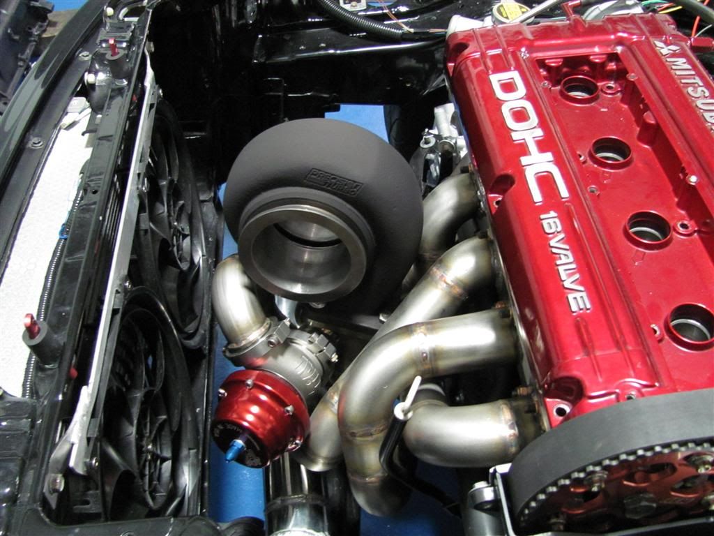

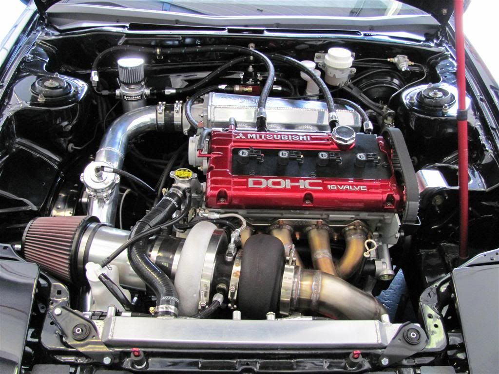

Pictures updated. Let us know what you think.

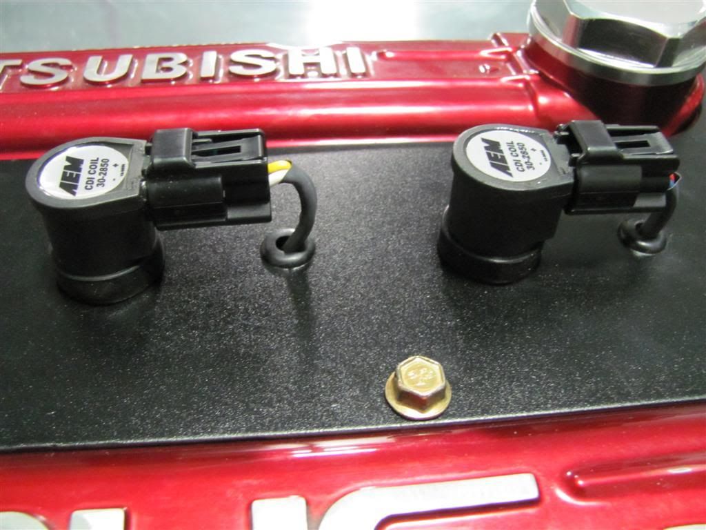

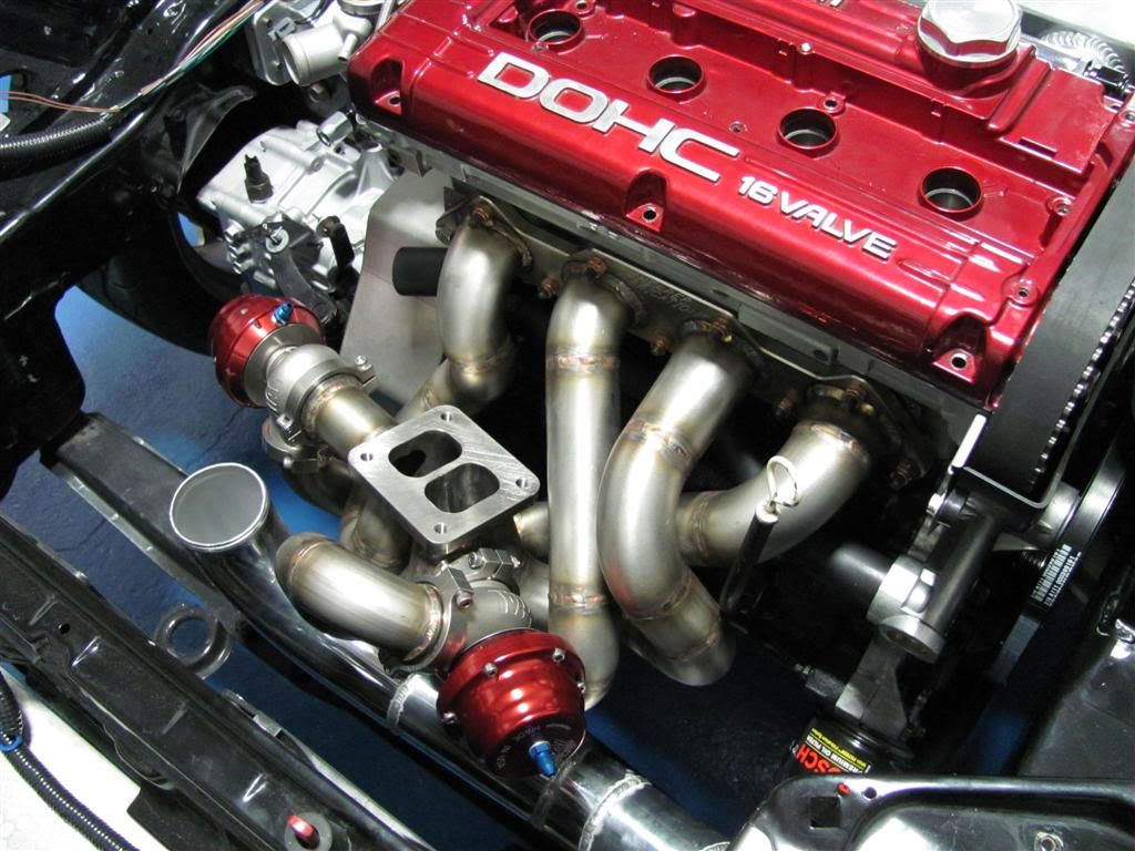

that looks awesome. any specs available?
i would love to know what kind of fuel and ignition handles that much power. I've been following Nicks car (assault187) and would love to compare and learn!

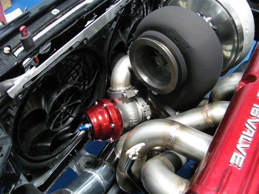

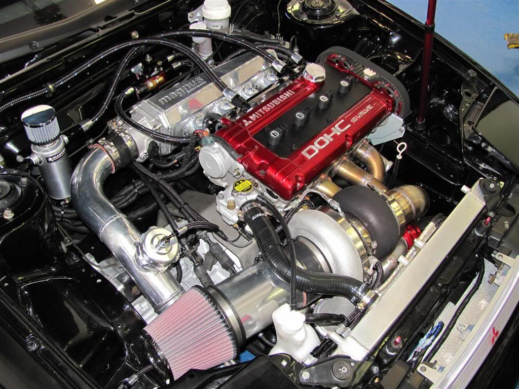

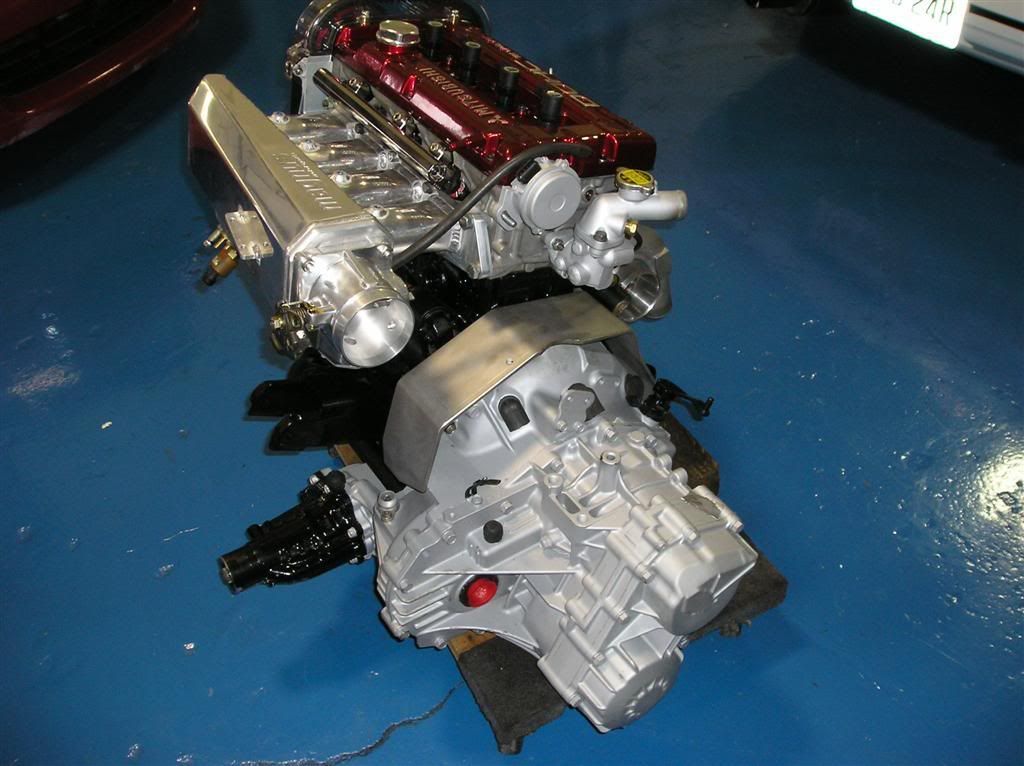

The fuel system has twin Bosch 044 fuel pumps, twin Aeromotive fuel rails with (8) 1000cc injectors. Ignition has a M&W Pro 12 CDI box and AEM pencil coils.

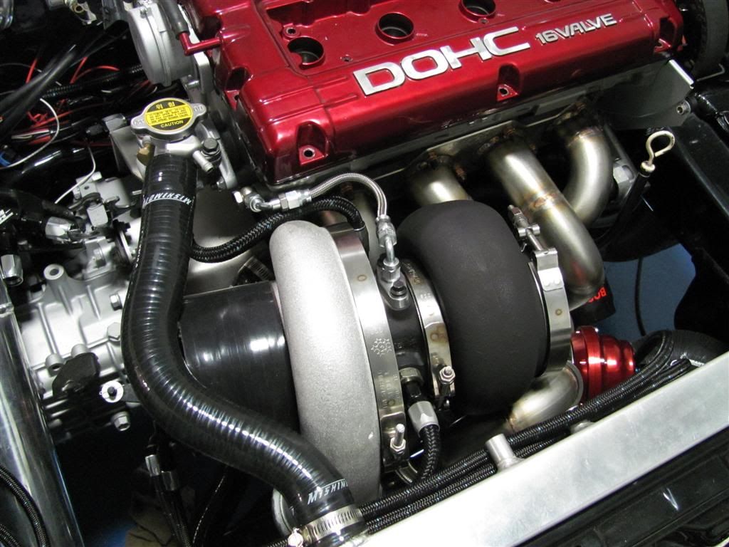

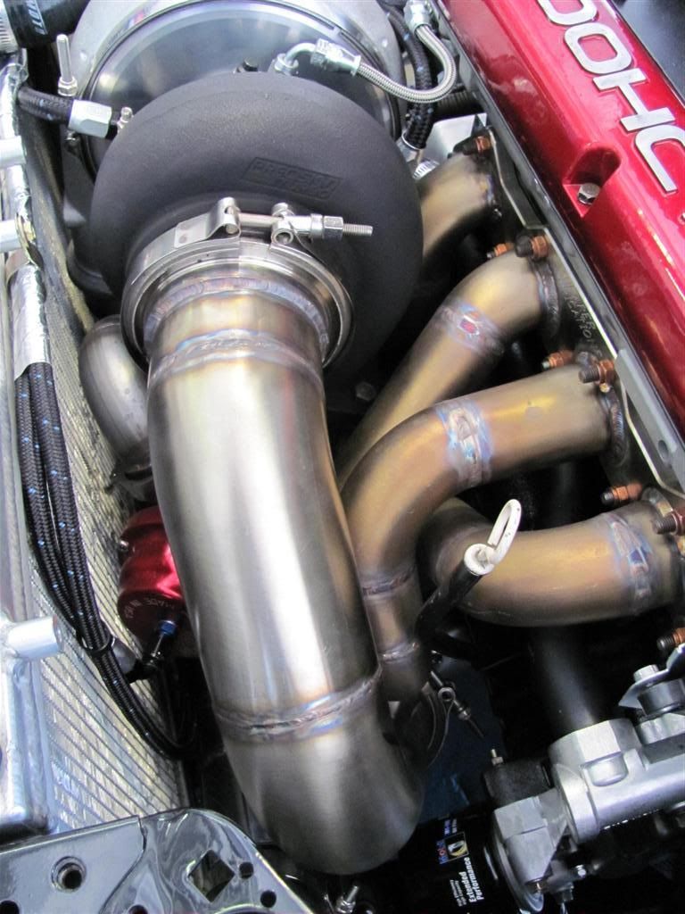

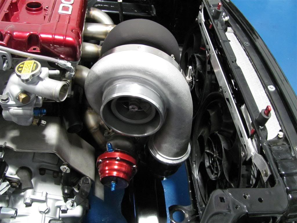

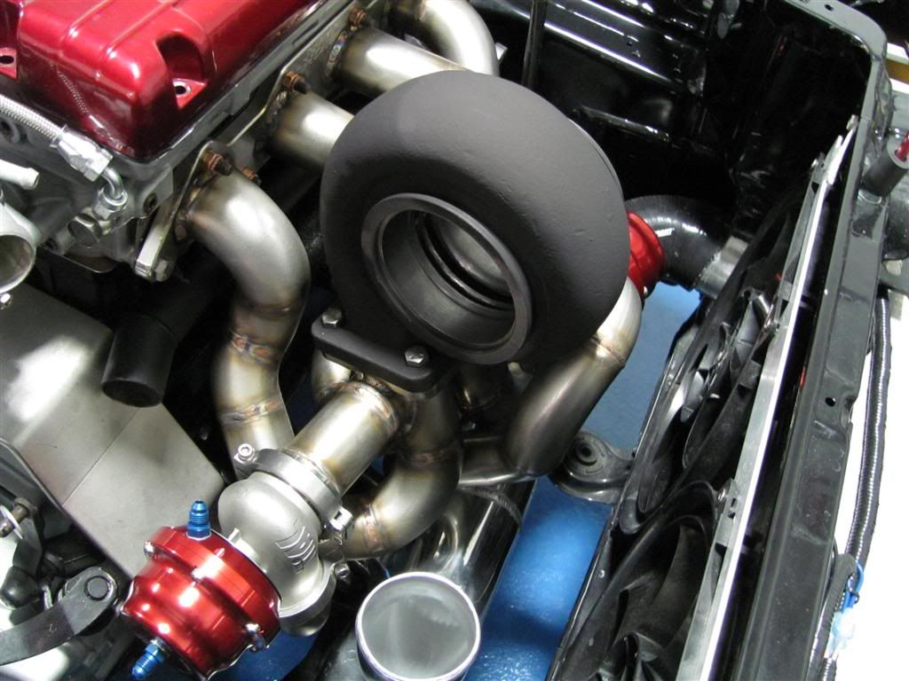

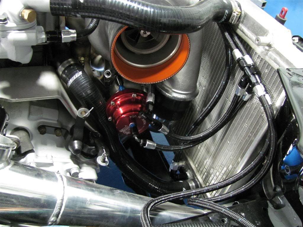

Oil feed from the head? Not sure if I agree with that.
Pretty engine bay...can't believe owner wants to rip it apart again already!

SniperGrl
Member #13662
Are you asking why? Or not sure about my statement. It's one of those continuously ongoing DSM debates.

Old 06-17-2010, 03:17 PM   #16
TrboChicsRock
TrboChicsRock's Avatar
Location: Pennsylvania
Member #152
I don't think it's much of a debate. If you call up a company like Forced Performance or any other turbo manufacturer they'll tell you to run a ball bearing turbo from the head and a journal bearing turbo from the OFH.
Car looks great though. Can't wait to see what it does.
