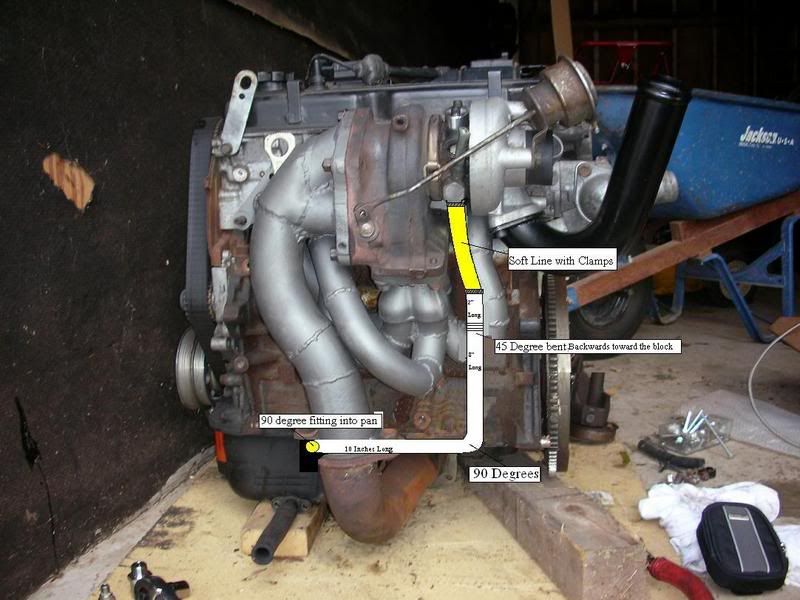

Philly-Night-SR 03-25-2007 03:08 PM
Took some measurements and I think this looks to be the best solution...
http://i93.photobucket.com/albums/l7...nesRequest.jpg
teh DIRT 03-25-2007 03:36 PM
from what I know you want it to be more of a vertical drop to the pan. The 90* turn isnt optimal. Should work still I assume.
77F-150 03-25-2007 03:52 PM
good luck with the project
Philly-Night-SR 03-25-2007 04:07 PM
Dirt.... I know man but I kinda have no real options.... That pipe leading to the pan isn't going to be completely horizontal.. I will be able to give it a 15-20 degree slope back into the pan... should be enough I think...
teh DIRT 03-25-2007 04:11 PM
yeah thats a good idea. just keep it at a slight angle to continue the downward flow.
