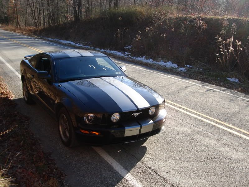

I’ve picked up a 06 mustang, it came all black. The previous owner had silver strips painted on it. Who ever did it did a good job. Because it is black, the guy who had it last put some small swirl marks in it and such. I wanted to give it a full wash, clay, polish and wax treatment during my break. I’ve only ever just washed and waxed, so I’ve really be doing some research about polishing, what to use, steps and stuff. Because is black things could go wrong fast. My Grand-pop has polish cars before, so ill have him help me.
My question is when I polish the car with some SIP, what do I do about the strips, should I not go over them? The stripes are raised just slightly from layers of paint. I’m just really not sure, most of the examples I have seen that use a SIP have all been just plain, no strips or graphics.
Also any tips or pointers other then the obvious ones like don’t do it in direct sunlight?

I never ran into trouble with racing stripes in the past. Either way a DA polisher shouldn't damage any paint. A rotary buffer in the wrong hands will.
Just get a good pad kit and a good 2-3 step polish kit and go to town. There are TST vendors that sell quality products. Just search the threads.

if its painted with a clearcoat you can polish right over them. It shouldnt be a problem at all.

And to Buster, either way the orbital polisher will not damage it! Some cars don't come with clear from the factory, Rally Red Evo's for example. Nothing has stopped them from throwing down a DA polisher.

You are sure it is painted? Mustang stripes are typically stickers, really good stickers that look to be painted, since the painted stripes from factory = $3,000 option. Easy trick to make sure, run your finger nail across the area where the strip starts and the black ends, if you can feel a difference, i.e. finger nail grabs or lifts very slightly, then it may be a really good sticker. Do not pick at it.
Black is a tricky color to work with, as swirls and imperfections show very easily. When you are using the polisher, slower is best, do NOT go zooming across the paint or it will swirl terribly. Also, work in a garage, out of direct sunlight which I'm sure you already know.

When I bought they said the owner had it professional painted, I really didn't try and mess with it. Something like that I figure a salesperson has no reason to lie about. But it does look and feel painted, there’s not a sharp drop off. But like you said there are really good stickers, I didn't pick at it though. Ill play with it later, when it’s clean.
The more I look I get the impression that I may not need to get anything to aggressive, Just an almost a finishing polish should do me well. The car had a good bit of hazing and swirling but nothing really bad, the car has 8000 miles on it. It wasn’t on the road enough to need any compounds. But I guess ill make the choice was I can really wash it well and see what I have.

I've detailed many cars in my life and I've come across sticker stripes that are clearcoated along the edges and when you think its painted on, its just a sticker with clear coat sealing it so be careful. Best bet is to open the hood or trunk and check the edges of the stripe real well and maybe even take a razor blade (experienced people only) and try to cut a small spot on the underside of the bumper or somewhere not noticable.

Another way to check, at least with this body style Mustang, is the stripes on the front bumper. Look closely at them to see and fine straight lines or uneven edges at the body lines/edges. If one stripe is off, then it is most likely a well done sticker. Like I said, I worked for Ford and dealt with Mustangs daily, if it was done right it can fool you.
I'm not doubting that the stripes are painted, just for your own sake to double check so that you don't burnish the tops off or lift the edges. Which will happen
