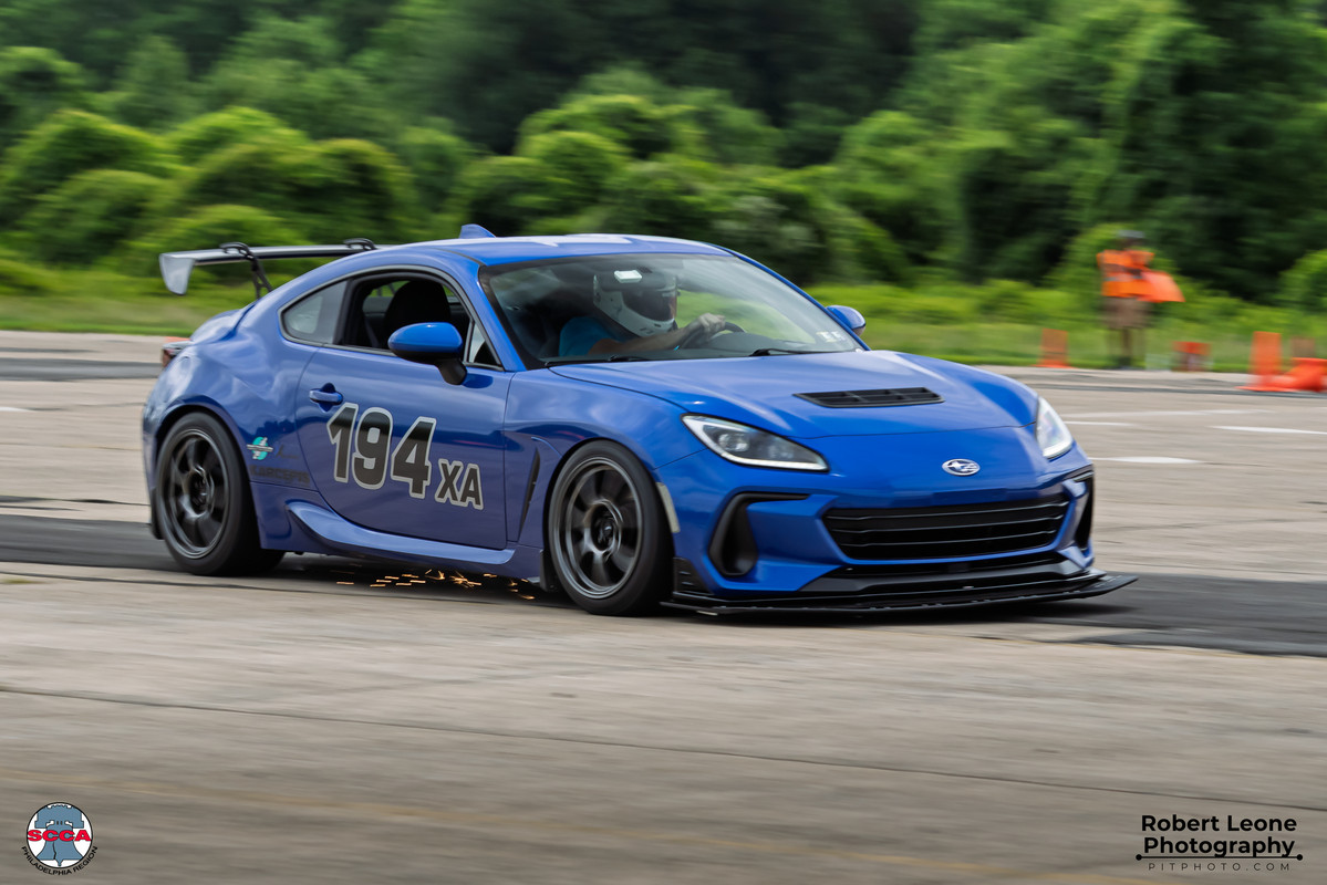

Had my first event with the new supercharger finally. It's freaking awesome! I love the power delivery, it's so smooth and progressive and easy to control. Not at all overwhelming, perfect for autocross.

Old 07-21-2025, 08:54 AM   #157
DocWalt
DocWalt's Avatar
Join Date: Feb 2009
Location: Royersford, PA
Member #10805
'92 GTI, '19 MX-5
Made the trip up to the Finger Lakes SCCA Test and Tune/Points event combo weekend. We got my car pretty well dialed in and I took top PAX by around half a second. Working audio on the videos this time, hah.
Here's my fastest clean run:
https://www.youtube.com/watch?v=6yqtlbSof5M
My slightly faster dirty run, I ran over the start cone. Ugh!
https://www.youtube.com/watch?v=Hbx3nJGhXwk
