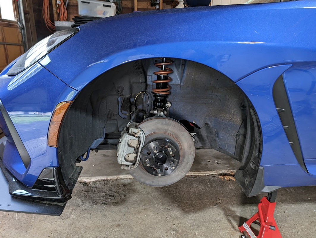

Got my shocks refreshed with a minor revalve from Shaftworks USA, finally had time to install them and realign my car right before we went to Maine for the Brunswick ProSolo in my wife's RX-8. I finally got to autocross the car with not-dead tires and the new setup this past weekend at Pocono. The car is FAST and I love it, haha. Only minor issue (which was expected) was the new 17x10s rubbing the rear trailing arm due to the traction mod lowering the arm into the path of the wheel. I've already ordered some different arms to get more clearance. Besides scraping the wheels and sounding bad, the only annoyance was the wheel weights being forcefully relocated in the process. Rebalanced them Saturday night and we're good to go for the next event.

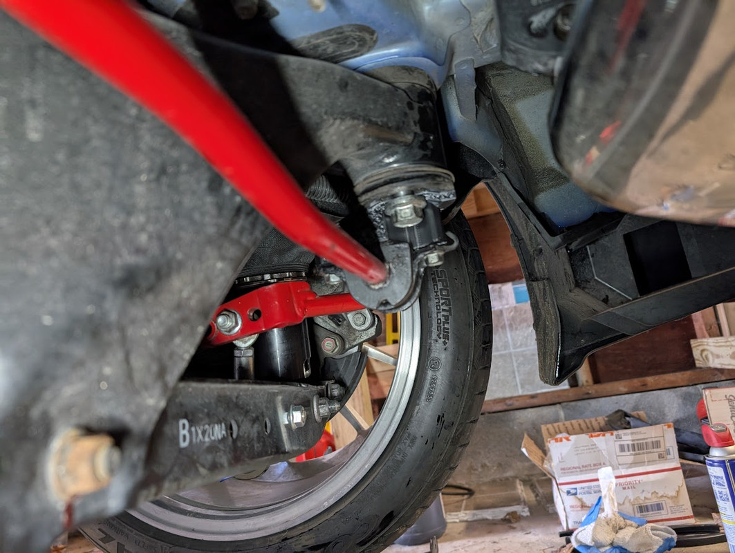

Designed some new rear swaybar mounts to get rid of the ridiculous stock rear swaybar subframe and optimize the rear swaybar geometry. My printer ran out of filament, but the parts were still usable for test fitment at least. I'll get them done in aluminum now
Silly stock rear swaybar subframe and its mounting location:

This is definitely the coolest car project I've done yet, IMO. I designed new rear swaybar mounts to correct the rear swaybar geometry when lowered and stiffen the mounts. I sent the design off to be 3D printed in aluminum and they arrived today. The whole process was great, the printer communicated with me the whole time and confirmed some aspects of my design. For example, they 3D printed the threads into the mount so I didn't have to tap the holes. So cool!
The design ended up being perfect and everything went together smoothly.
This is the stock geometry, you can see how the swaybar isn't perpendicular to the end link or the ground but it's also not centered on the control arm so it can torque the arm.
