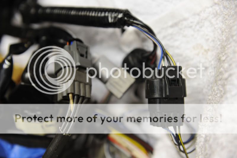

and if you look carefully at this sequence, you'll see why we were having issues with the ECU/wiring...
hint: now the gray is with the gray and the black is with the black. who woulda thunk that they would have 2 different plugs that still clip together right next to each other? we had the ECU and the Igniter plugs switched... doh.
