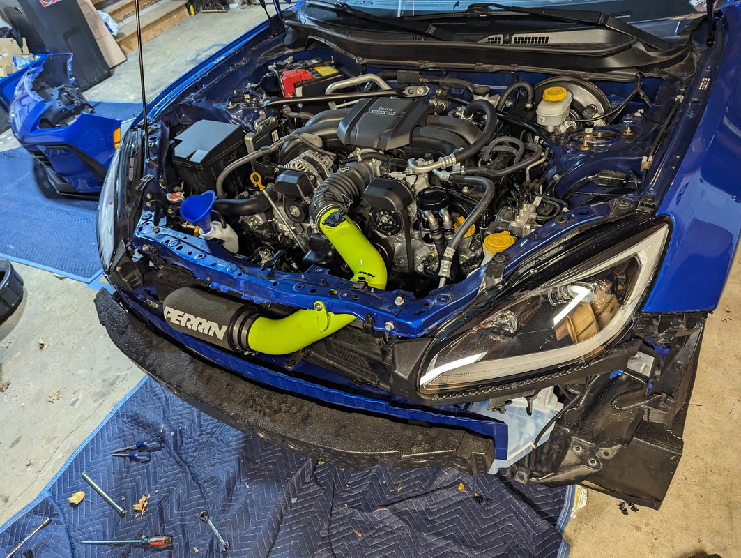

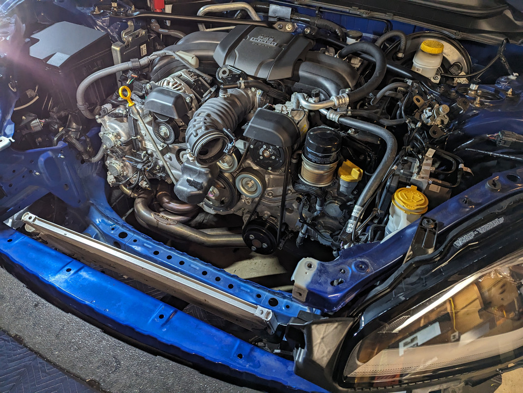

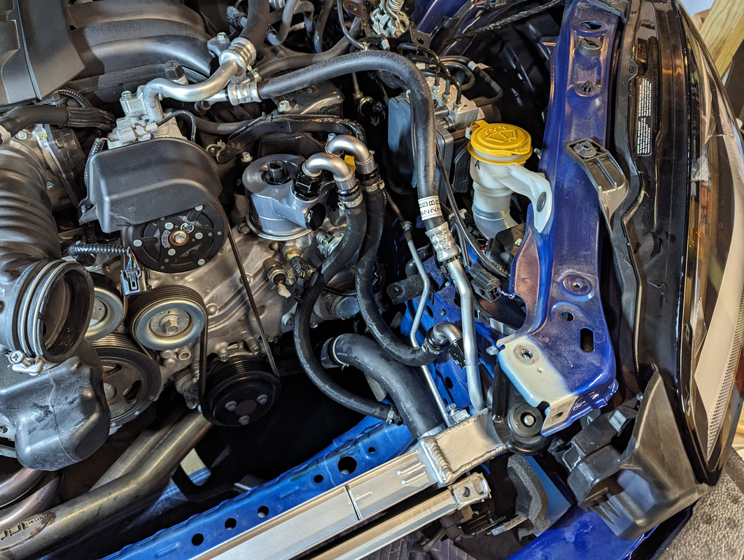

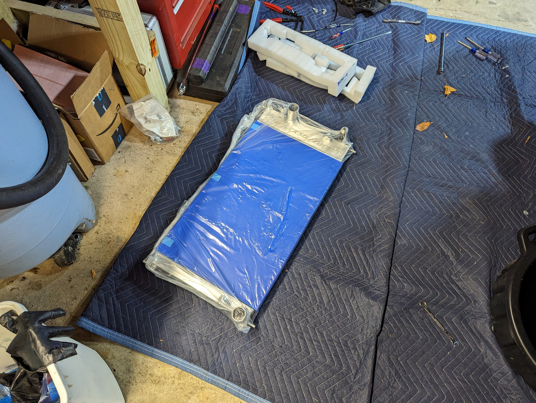

Installed the Jackson Racing Dual Cooler and deleted the factory heat exchanger. I was able to use one of the stock heat exchanger hoses to bypass between the two nipples that fed the stock heat exchanger, it was just long enough to not kink, haha.

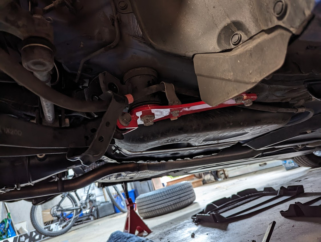

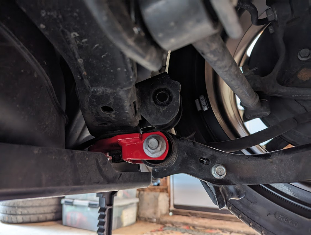

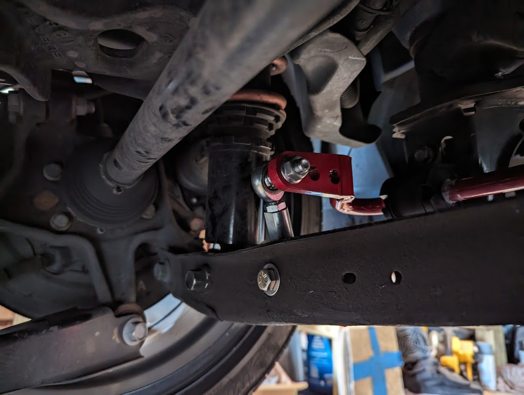

Installed the GP Sports "rear traction member collar" aka the "traction mod" that reduces the rear anti-squat for a more compliant suspension and better ability to put power down. Initial testing on the street says it does all of that very well! The car rides better and seems to settle into the road better on corner exit. There's a particularly bumpy intersection I drive every day that I couldn't accelerate out of hard on stock tires even in 2nd gear and now it just squats and goes. I can actually use first gear now without totally roasting the stock rear tires too on regular roads, so that's a marked improvement. Definitely curious how it does in performance driving!
I also installed the Perrin 16mm rear swaybar and made some DIY end links that I offset using some round tube and washers to fine tune the alignment to not bind the joint nor have the end link hit the control arm. Nothing too exciting to report here, but definitely excited to test these changes. I actually installed the end links last week and drove to work with the OEM rear bar all week, the non-OEM rear end links also seemed to make the car ride better, go figure not being all bound up helps a lot with ride quality.

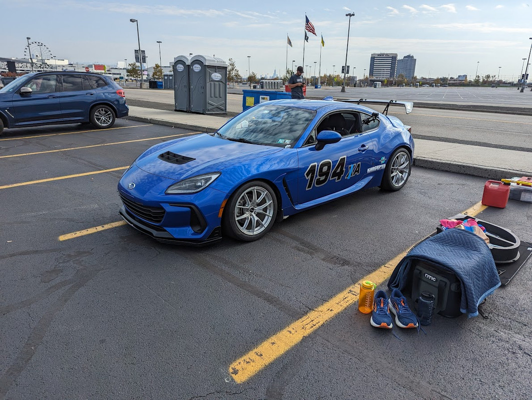

I did an autocross yesterday with Motorsports NE at MetLife stadium. The recent car changes have been... simply put, incredible. I took top PAX (non-SCCA event using their own PAX) and fastest raw time over a well driven GT4 RS, I took second using SCCA PAX, so that's a pretty darn solid result.
The anti-squat changes are a HUGE improvement, it's frankly kind of mind blowing. I would definitely recommend the traction mod for anyone that can do it within their rule set. The improvement in power down is really hard to describe, but it's really sort of mind blowing how early I can roll on the power now and not worry about the car getting unsettled over bumps or slightly imperfect inputs. I was so late to power on my early runs because it was just so settled and forgiving versus how it was before.
That said, the traction mod brings with it some setup issues. I went ~30% stiffer on the rear swaybar versus stock, but in practice it's likely more with the stiffer bar bushings and better end links, and that nearly perfectly compensated for the geometry changes creating a balance change. So you definitely need to plan ahead and plan on stiffer rear springs or swaybar to get the same steady state balance back now that the rear end is so much more stable and planted.
We made zero setup changes all day (not that we had time anyway since it was 3-4 minutes between runs which is pretty tight) and it was SUPER dialed right from the get-go.
Related, but not? I measured the wing angle change between the two settings, ~1.5 degrees between the two settings. I left it in the lower AoA position for now until I do some front aero.
Here's my fastest run from yesterday:
https://www.youtube.com/watch?v=PSDO92ez3-A
Here's my codriver's fastest run from yesterday (I'll spare him the embarrassment of naming him haha):
https://www.youtube.com/watch?v=wHbtDeUxGW0
Some random photos of yesterday's excitement!
and a quick outside video of my codriver on course, the intake noise when it's near rev limit or on the rev limit is *insane* sounding and a lot of folks came up to me to make sure my car was OK, haha
https://www.youtube.com/watch?v=ni78yHK3nvg

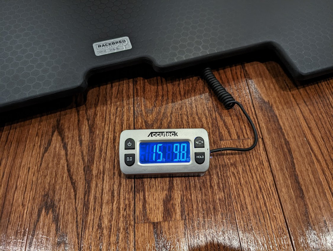

Old 12-21-2023, 04:33 PM   #107
DocWalt
DocWalt's Avatar
Join Date: Feb 2009
Location: Royersford, PA
Member #10805
'92 GTI, '19 MX-5

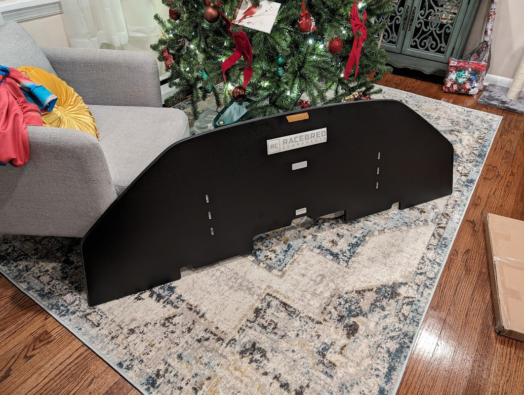

I got my splitter blade for next year, just waiting on the brackets. Seems like a pretty nice product so far! Not too heavy, which is good.

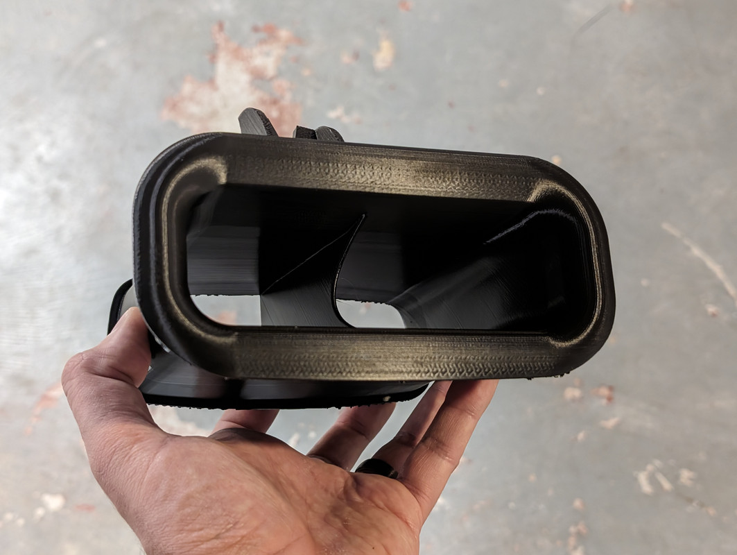

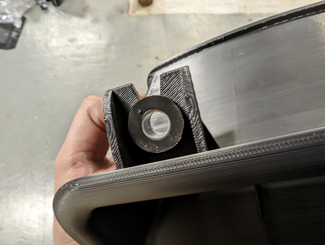

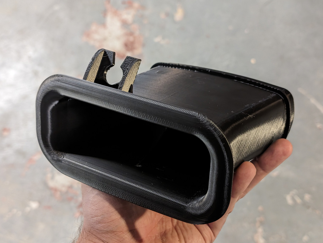

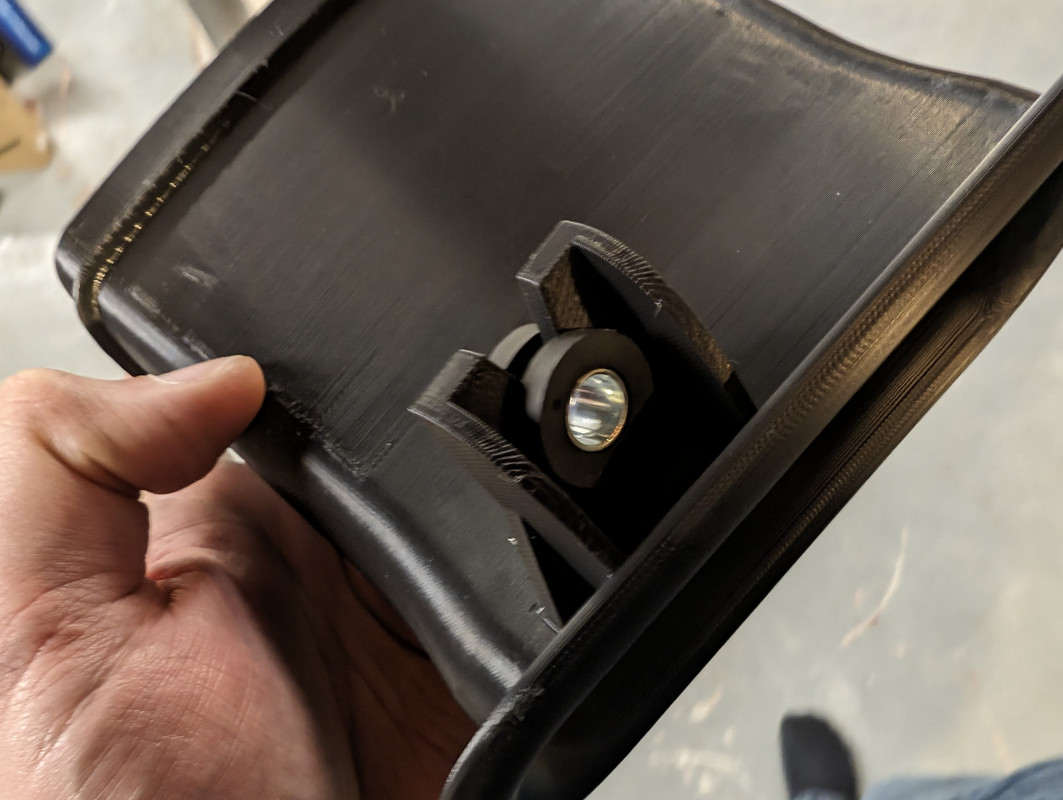

Designed an intake snorkel like the GR Cup cars. No clue if it fits first gens, *should* fit second gens but haven't had a chance to pull my bumper and triple check my work. It fits the airbox fine anyway, with a bit of weather seal tape.
I designed it to maximize the air intake area into the box while still using thin foam weatherstripping (1/16" thick) and mounting using the OEM grommet.
STL here: https://drive.google.com/drive/folde...9X?usp=sharing

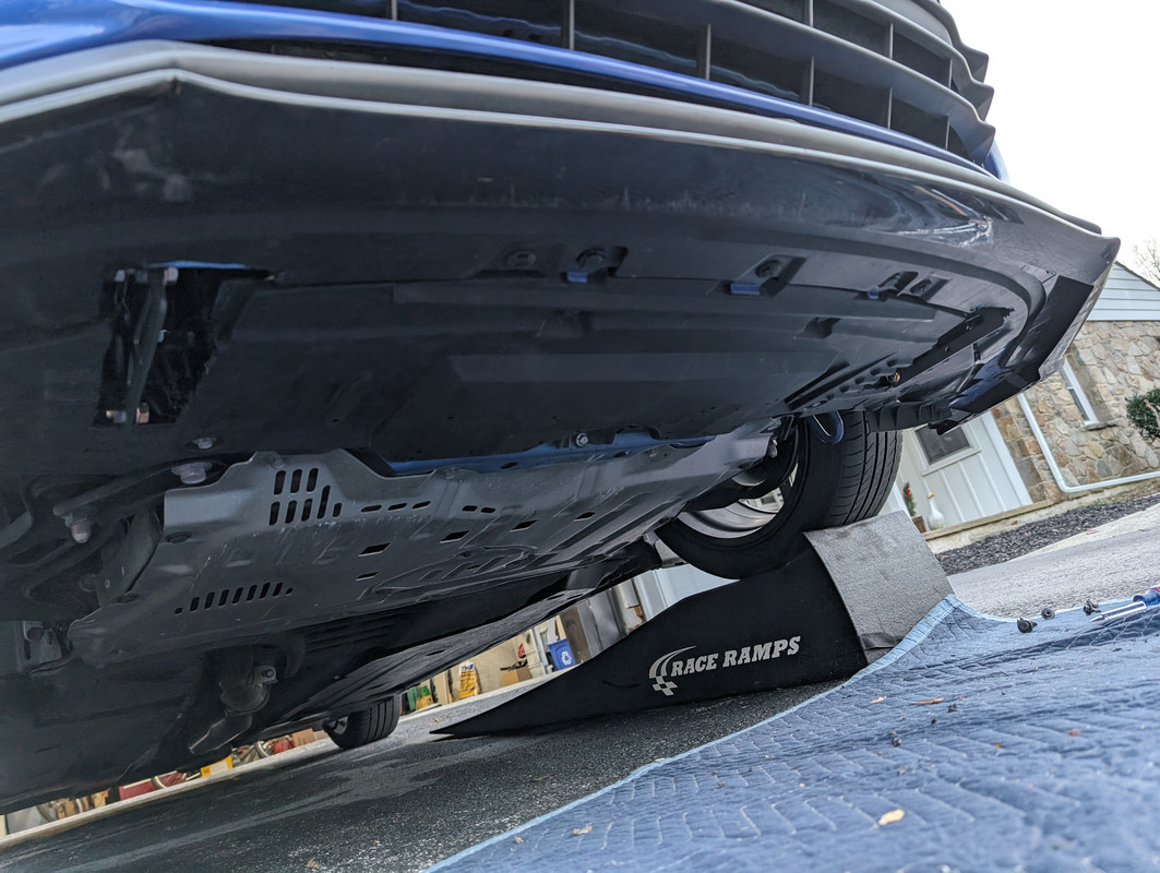

Old 02-10-2024, 09:20 PM   #109
DocWalt
DocWalt's Avatar
Join Date: Feb 2009
Member #10805
'92 GTI, '19 MX-5

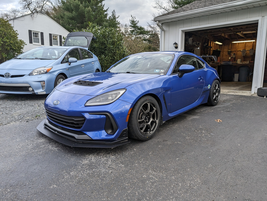

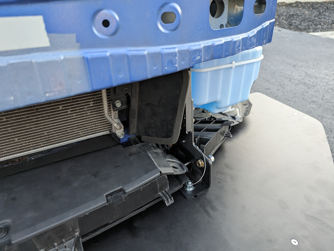

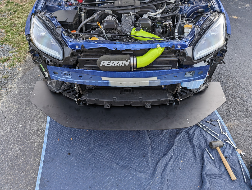

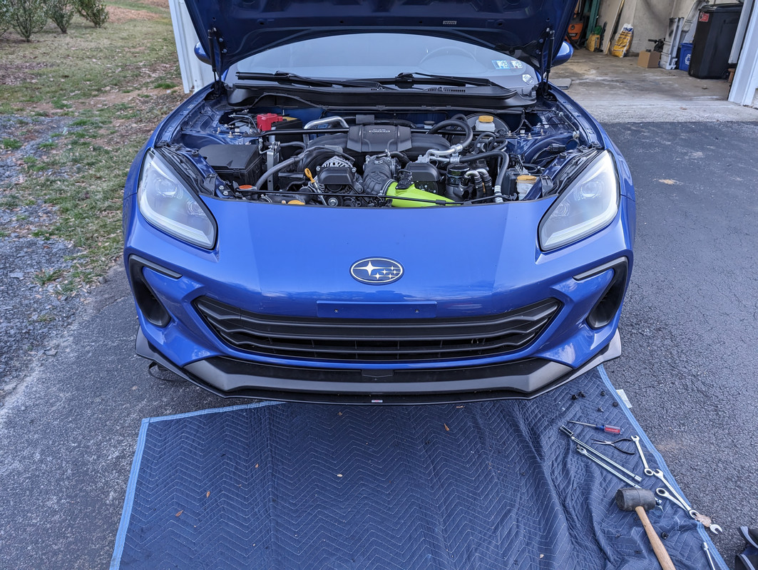

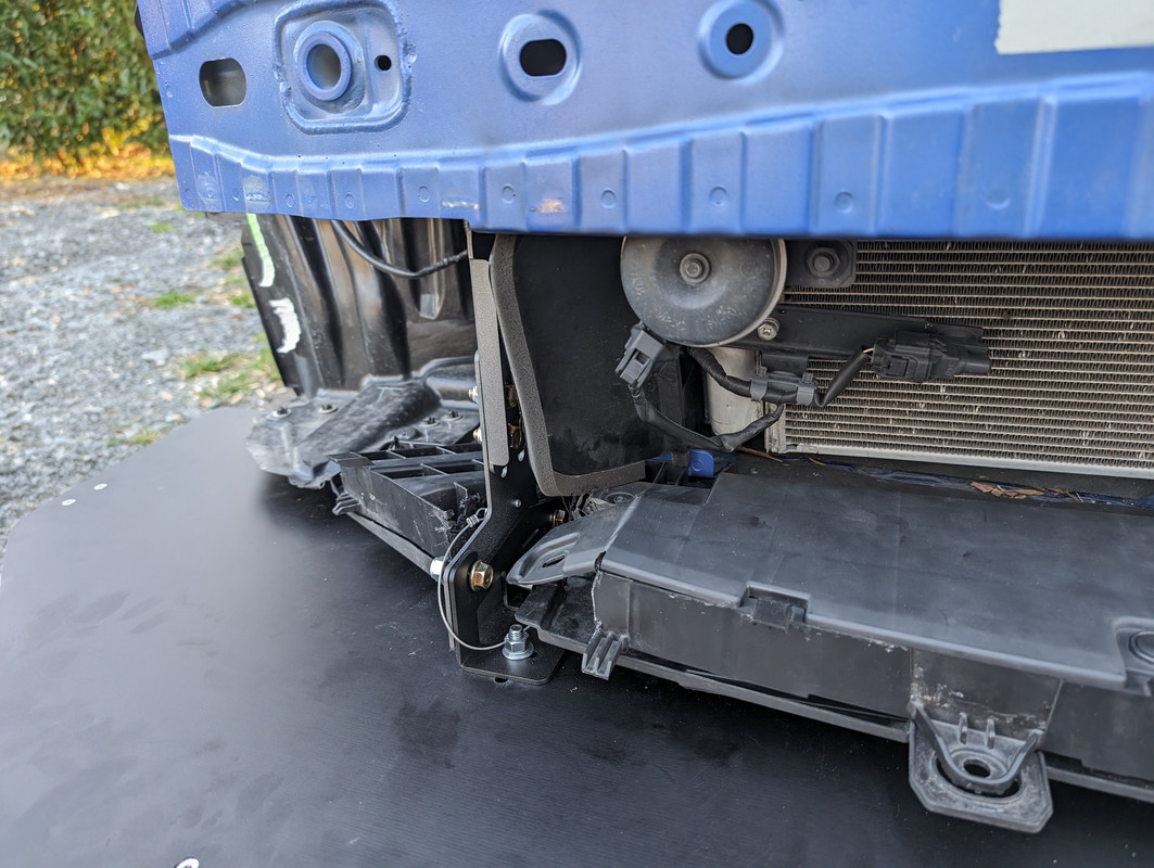

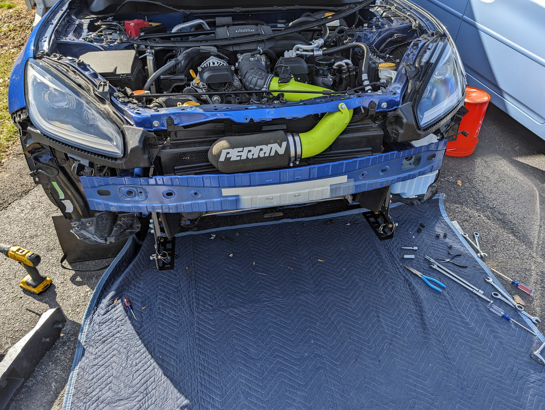

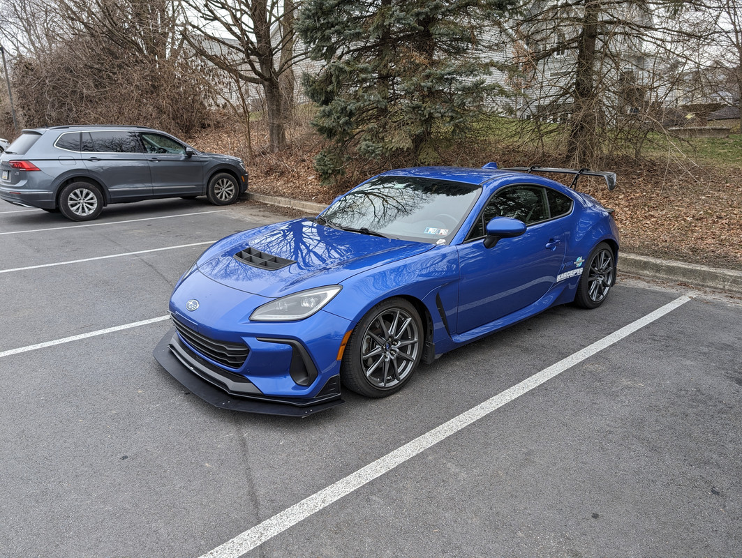

Installed the Racebred splitter last night/today. I made it really hard on myself by wanting to keep the stock undertrays so I could drive the car without the splitter installed, I succeeded though it's a lot harder to install/remove the splitter now (still pretty quick). The silliest part is that I'll probably still mostly drive the car with the splitter on anyway, it doesn't really scrape on any of my normal roads.

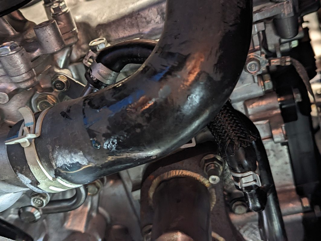

Old 02-27-2024, 08:12 PM   #114
Bates
Bates's Avatar
Join Date: Jun 2010
Location: Bloomfield, NJ
Member #16741
2012 Nissan Juke & 1987 Nissan 300ZX GLL
Originally Posted by DocWalt View Post
Ooo, hope it's simple! Coolant leaks are the way of life on older Japanese cars lol
FWD is either brutal understeer or snap oversteer

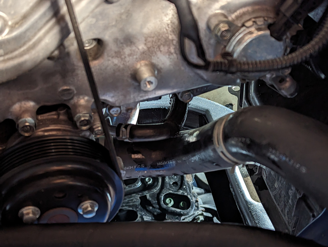

I can see some seepage around the end of the hose on the water pump housing inlet. I didn't notice anything else wet so I think that is it. I'll deal with a coolant leak over oil.

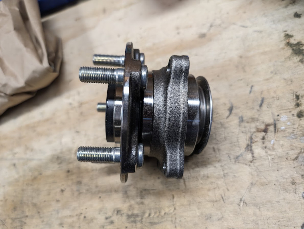

First gen front hubs bolt right into a second gen and work perfectly fine. I replaced mine with a Timken which is *much* chunkier. Time will tell if it holds up better.
https://youtu.be/Budys1P_EcQ
For funsies, I replaced the other side wheel bearing bearing with an SKF since that side was also trashed. Looks the same as OEM.
Now we race to see which brand needs to be replaced first, haha.

In the E30 world we have been seeing quality issues with the SKF stuff as of late. Lacking grease, bearing dust shields damaged/missing, etc. Interested to see how those wear.
Is there a “right side hits more pot holes or sees more load” myth that you find to be relevant? Surely that’ll matter less on your car since you’re turning all the ways lol
Is there a right side hits more pot holes or sees more load myth that you find to be relevant? Surely thatll matter less on your car since youre turning all the ways lol
Yeah and people have been complaining about Timken for similar reasons too, annoying.
No clue, both sides felt pretty bad and made a lot of noise. I assume the right side would normally go bad first, it did on my wife's Prius.

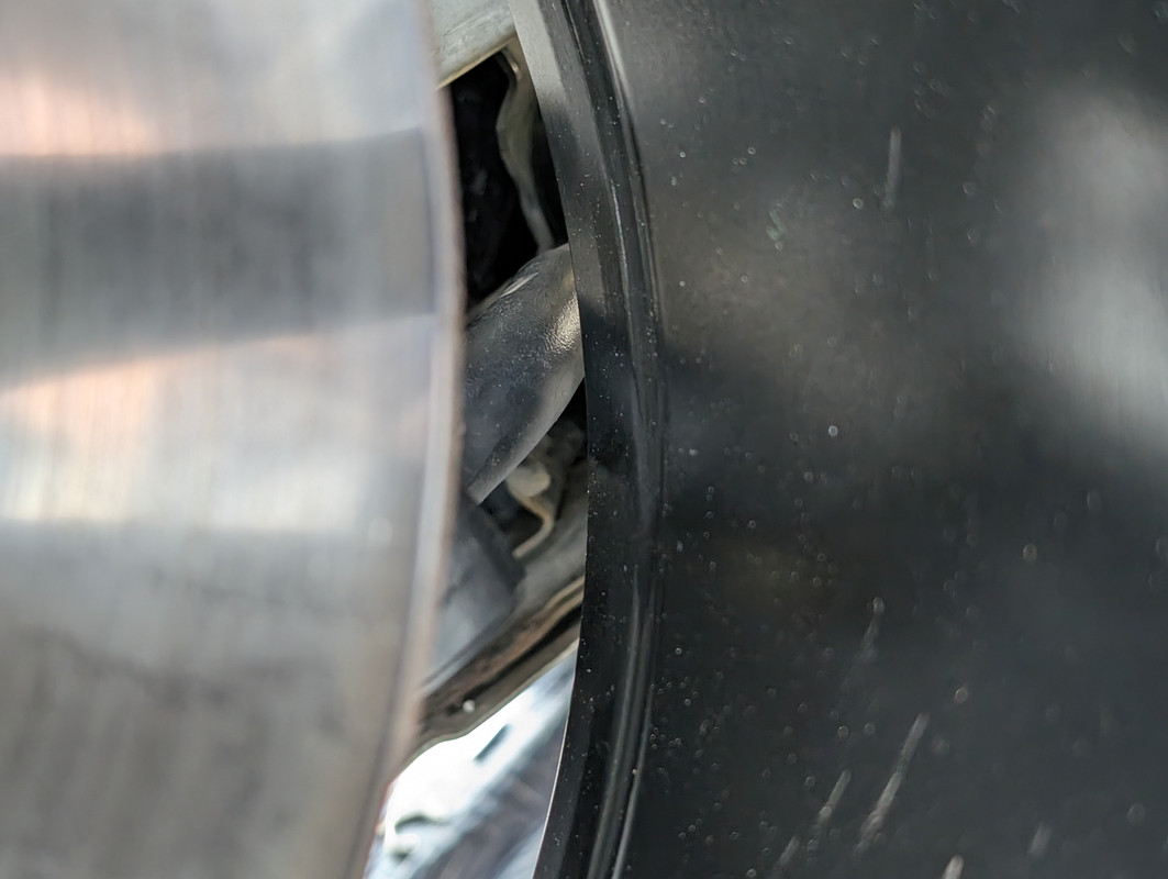

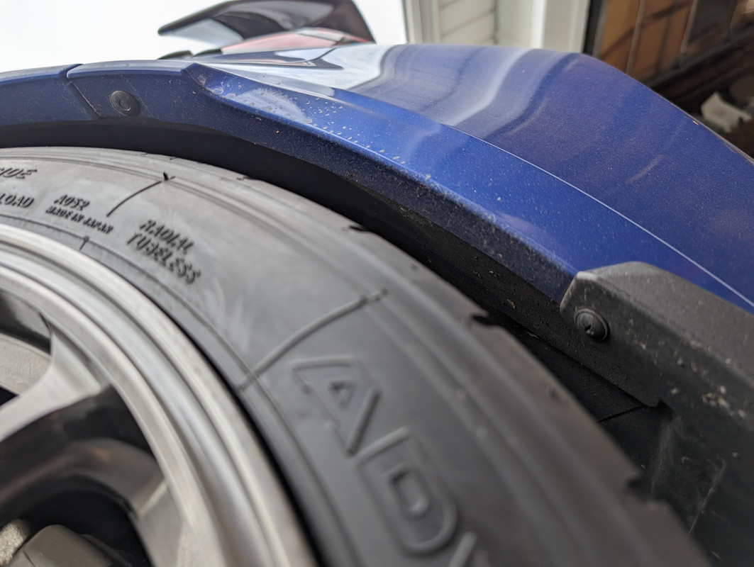

Old 04-16-2024, 09:40 AM   #118
DocWalt
DocWalt's Avatar
Join Date: Feb 2009
Member #10805
'92 GTI, '19 MX-5

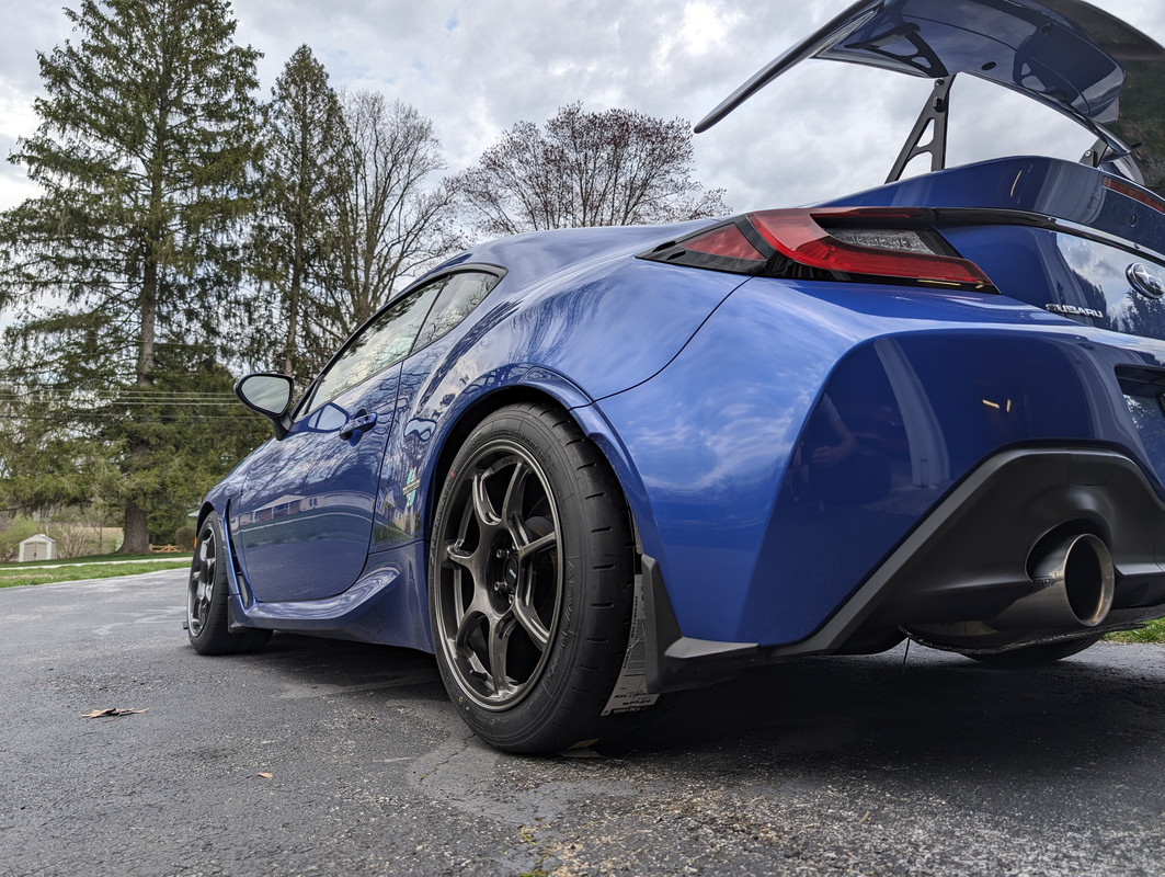

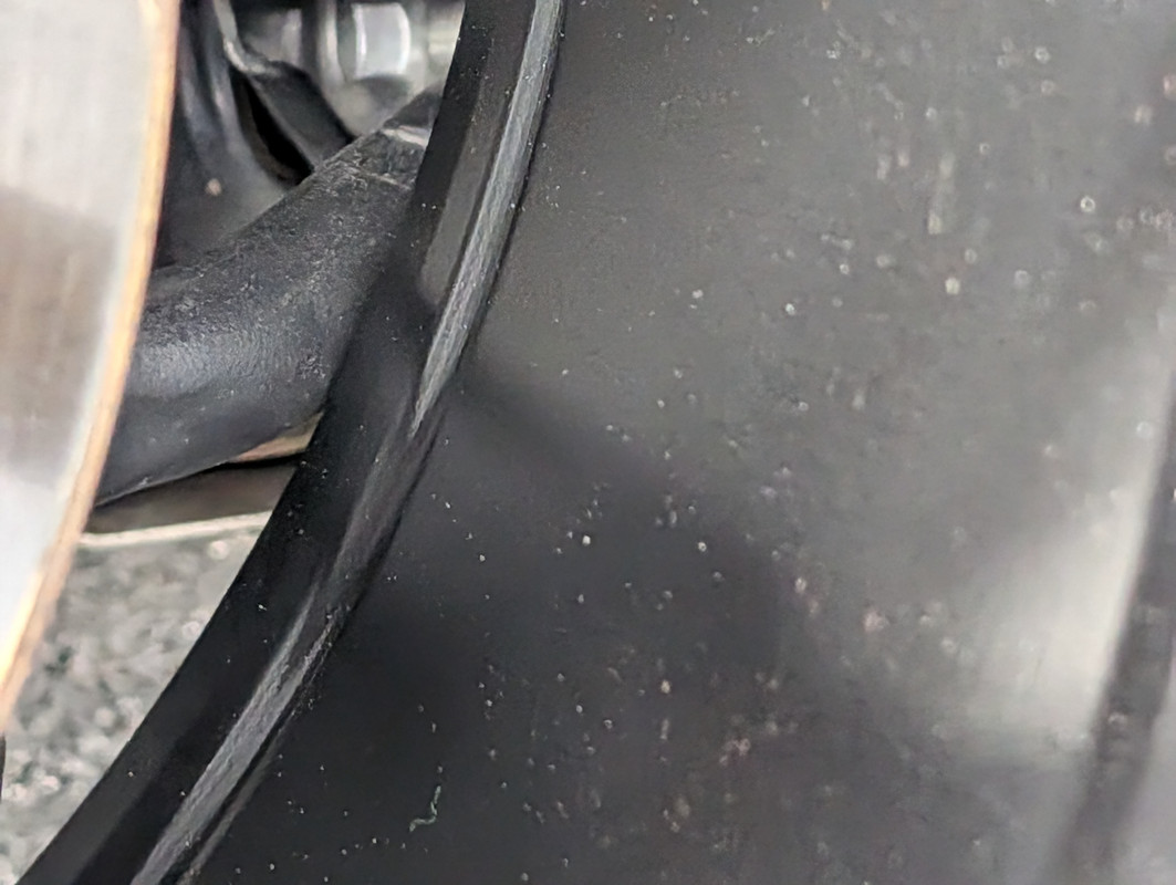

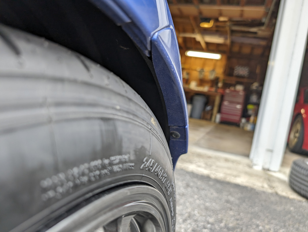

Got my 17x10 ET48 Konig Ultragrams from Vision Speedworks a while back, finally got tires on (245/40R17 Yokohama A052) and test fit yesterday with my normal 13mm front spacers and no rear spacers. They look great and the fitment is on point. The clearances in places are... snug. The clearance at full lock to the tie rod is nearly non-existent at ride height, in bump it would touch. I ordered some steering rack limiters to make sure it doesn't touch.
Rear clearance to the fender tab is VERY close when the suspension compresses, but it does clear. Ideally I'd have a RUCA to pull the top of the wheel in, but here we are haha.
The front clearances are a bit easier, especially with the spacers. That said, the tie rod is VERY close.

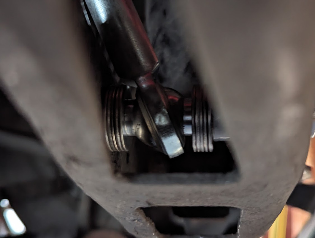

Over the weekend my steering rack limiters were delivered, I only needed one clip per side and now I can safely run the Konig wheels
Car is still dirty from autocross, but danggggg
