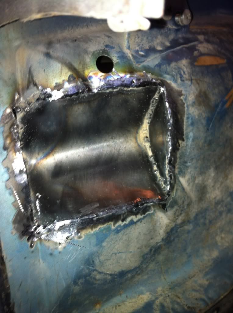

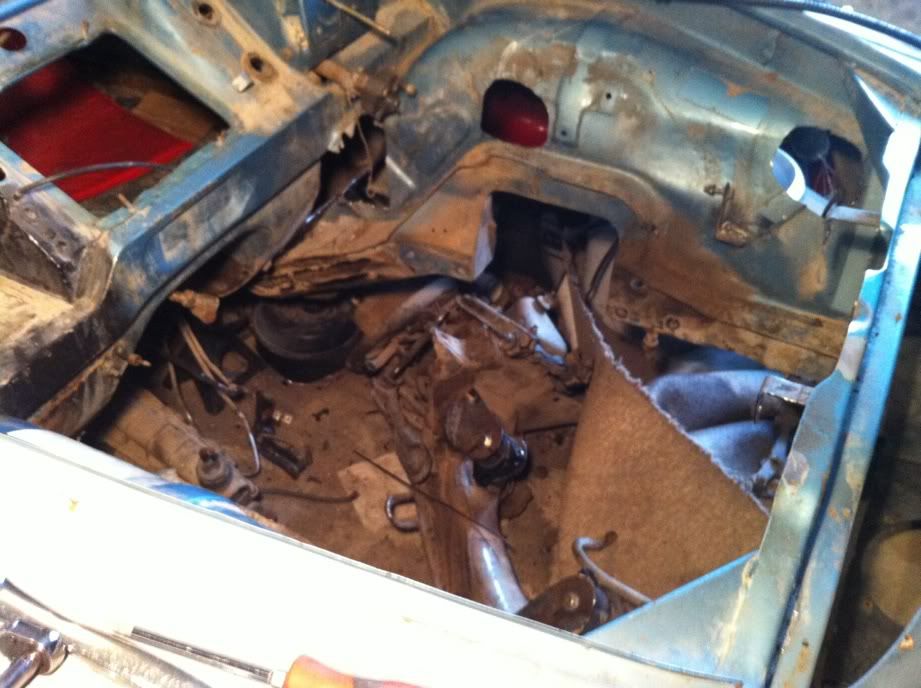

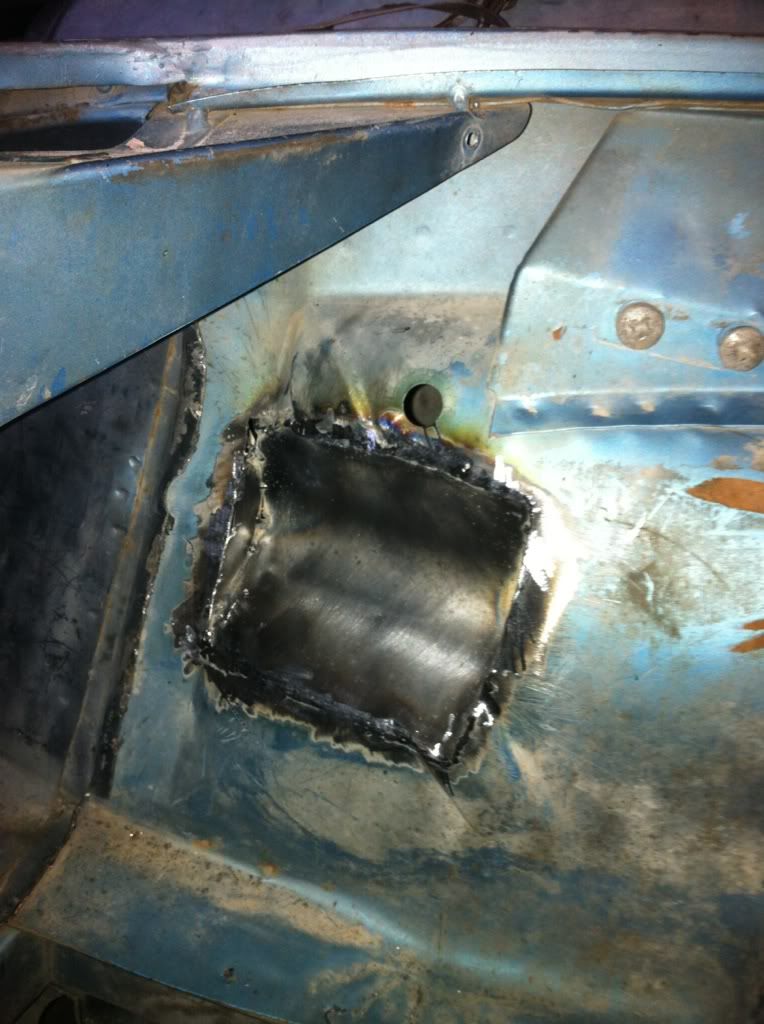

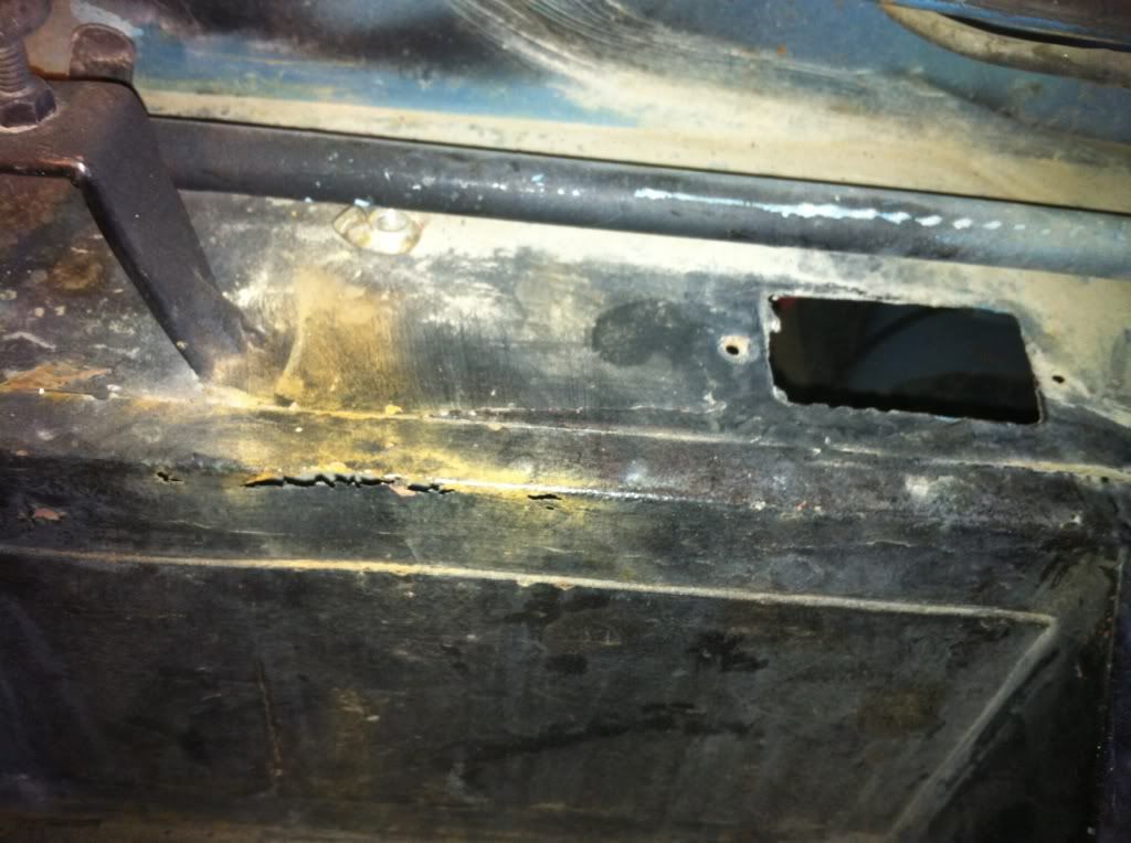

thanks for all the positive comments guys. today i began to "shave" the bay and fix a few spots that were slightly rusty, i plan to smooth out some panel seems and other now useless body holes, but i won't be making it all one seamless panel, as nice as it could look it will just add way too much filler to the bay, and i really would prefer to not have body filler cracking on me after a year, this car will be daily driven in nice weather. i removed all the lines and steering box so i can prep and get paint on every square inch. then cut out the only rust spot and welded in a new patch, my goal is to do one or two spots every day i work on it, bay should be ready for paint by next sunday, or so i hope, wanted to get more done today but nascar has been distracting me. pics
"before shots"
rust and patch
welds are a little sub par, solid, but not pretty. doesn't help that my new metal is slightly thinner then the old

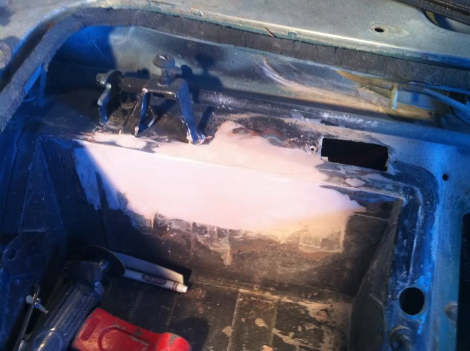

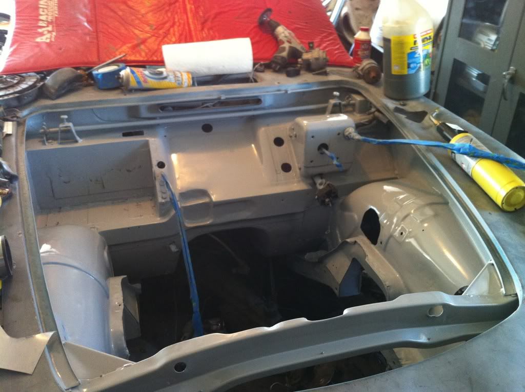

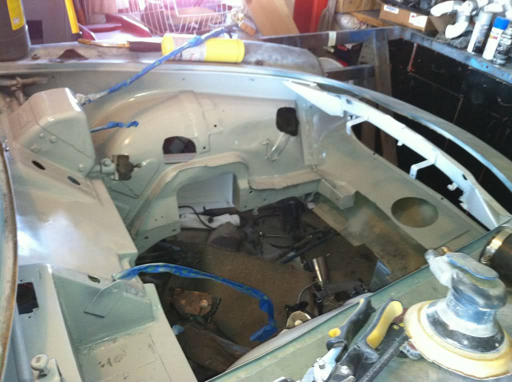

end of my work for today. lil bit of mud, lil bit of paint, make it something it really ain't was the modo of today haha
had to cut clearance for the ignition coil wire port that comes off the distributer cap. cut it out made my patch welded it up, bondo is drying, takes for ever in these cold temps also smoothed out yesterdays patch
pics
mid day edit. the daytona 500 is on rain delay so i went back out and decided to put the first coat of filler on, looks decent, and it fits perfectly

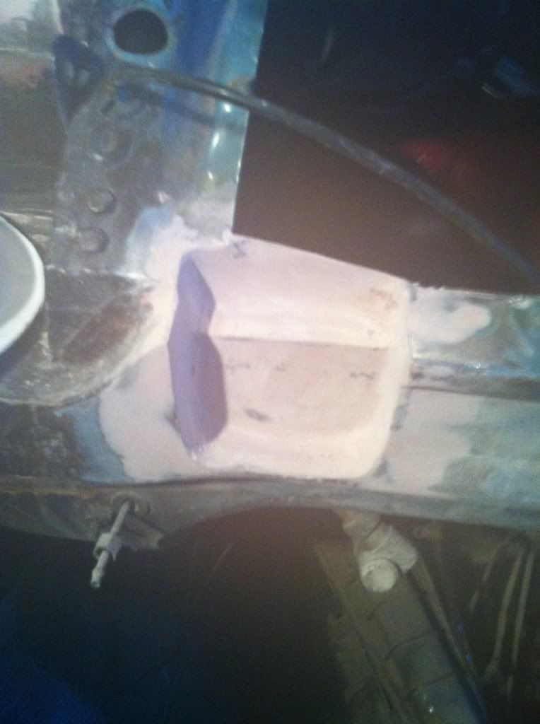

small update, closed up where the heater core and blower motor enclosure went. the car will still have heat. but I'm gonna simplify it, the factory box is not only too big to fit, but ugly as sin as well

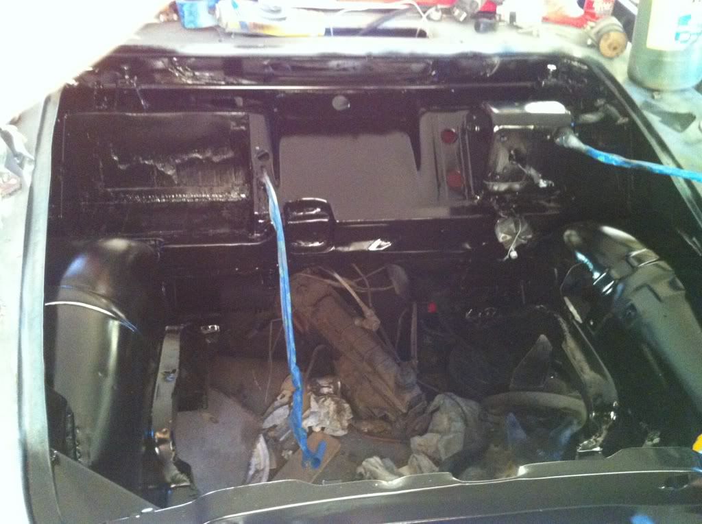

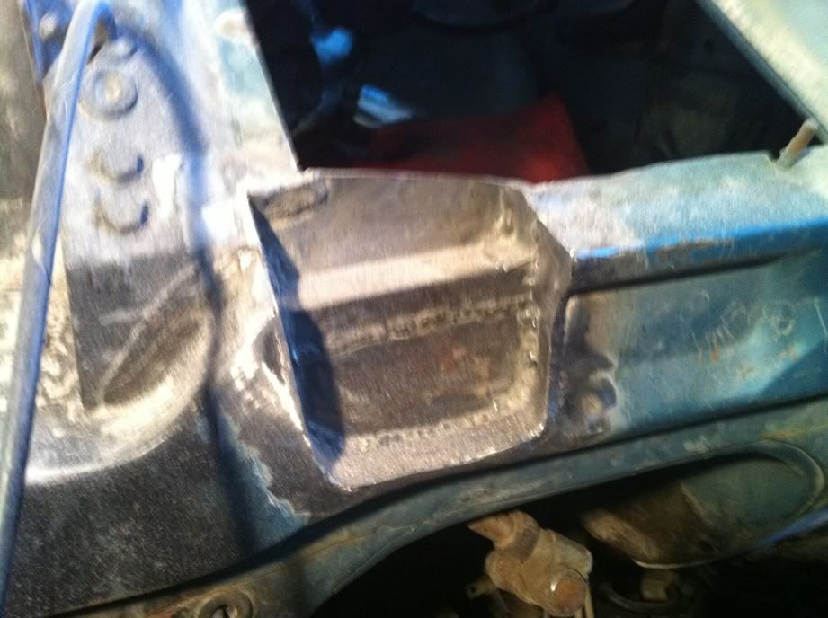

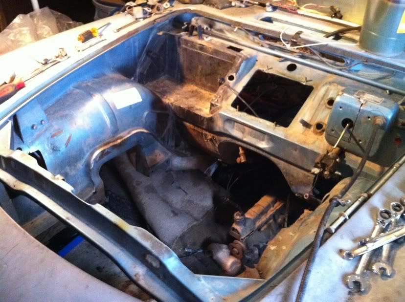

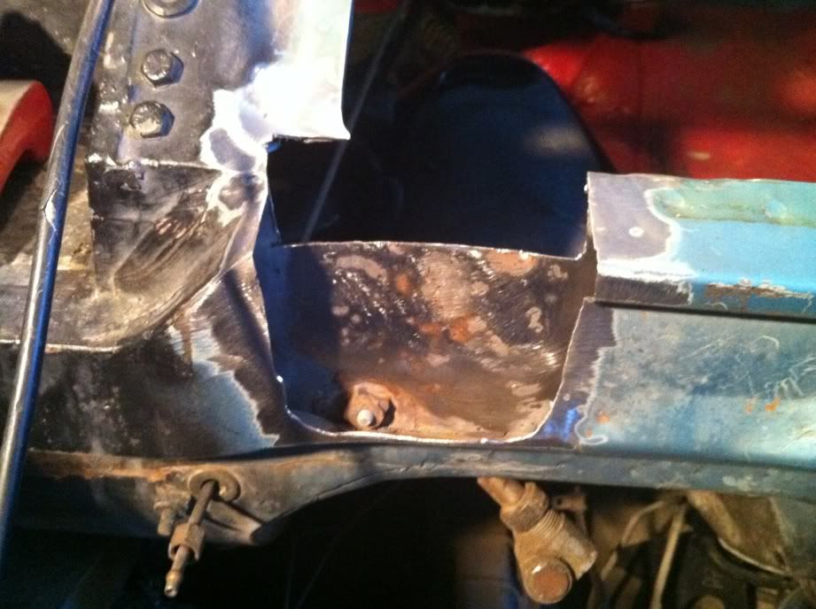

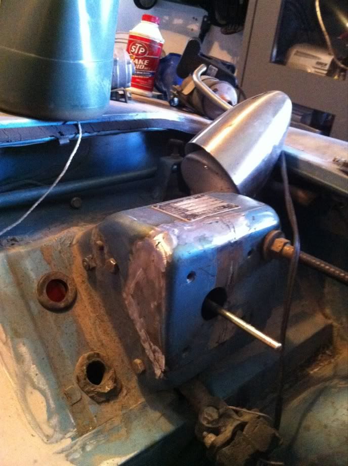

finished all the metal work this weekend,spending the rest of the day sanding and cleaning the bay, planning on having this motor back in by next sunday since I'm off school off work!
metal finish ;)
patched big hole in the floor that i cut when messing with the pedal assembly, really wish i didn't looking back, but its all fixed, getting the spring mechanism all back together was a pain but the pedals spring and the master cylinder hits full stop now, awesome!
inter cooler piping recession

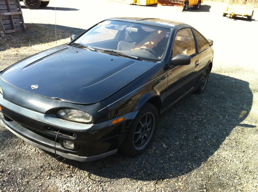

and another small update, I'm purchasing another project, i missed my nx so much that I'm buying this gem for 500$
car has blown sr20det with ported head, je pistons, eagle rods, and bc3 cams, all those goodies are in good shape, the rings are just shot and block needs to be bored, I'm gonna part the goodies out and put a stock motor back in and some coils =]

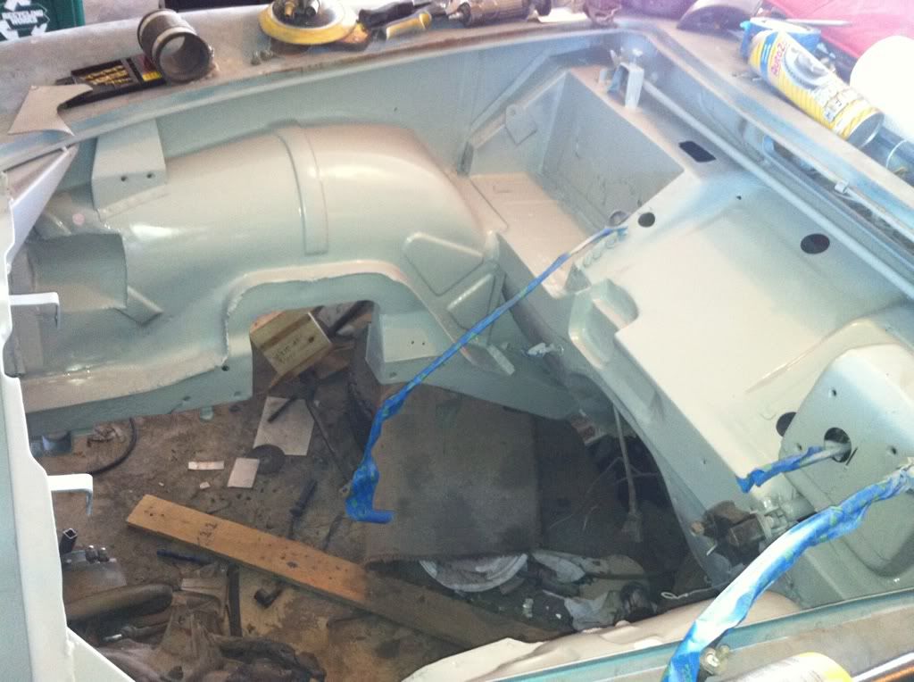

final paint, hot off the press
before
after

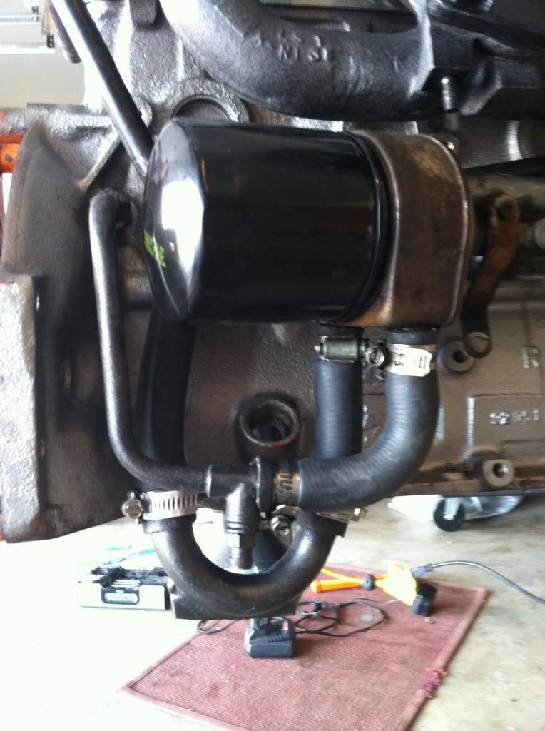

today i spent the day running all the turbo hoses and a few other miscellaneous stuff, ate up a lot of time because of missing crush washers and a few other small things i had to source. a butt load of parts should be here any minute, includes a bunch of front end suspension parts and the rest of the engine parts i need before i can drop this bad boy in, hopefully this weekend, pics from today vvvvv
all nice and finished

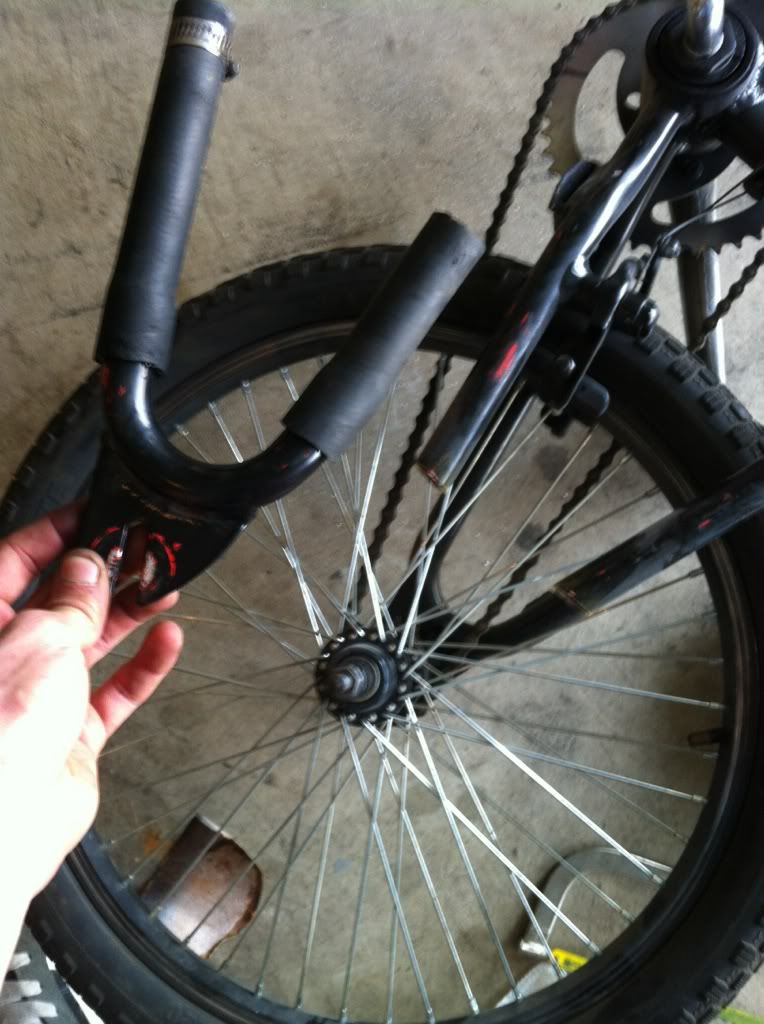

needed to make my own radiator hose because its no longer available,and i couldn't get any generic hose bends from the parts store to fit so i did some improvising
yes, that is exactly what it looks like
and if i didn't tell you, you'd never know =p

poor bike was sacrificed, and we wouldn't know if you didn't tell us haha.

Nooooo you ruined the bike!
I wish I had half the skills you have, can't wait to see when it's all finished!
thanks, I'm looking forward to seeing it finished too, and anyone can do just about all of this, don't be afraid to just dig in, you'll figure it out sooner or later, just make sure you have someone to have your back if you really screw things up =p. but we all do it so don't be afraid to just try
it still rides like a dream =]

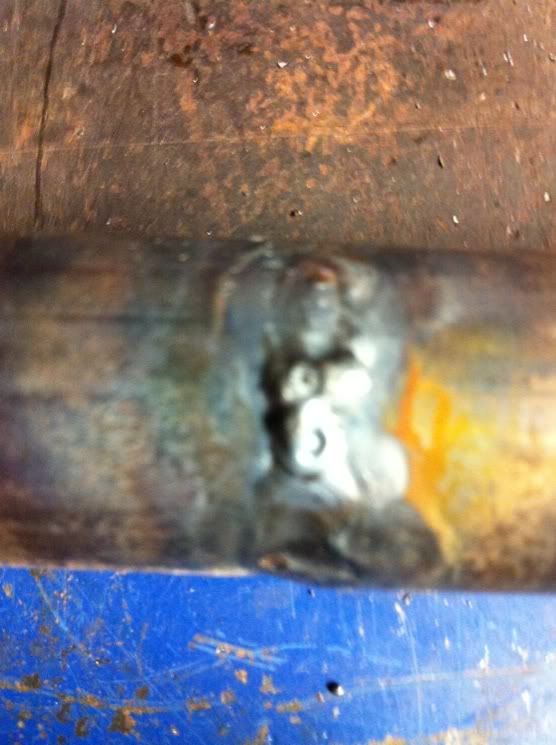

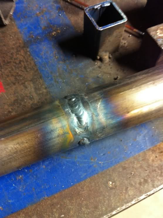

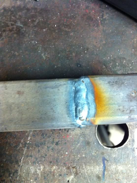

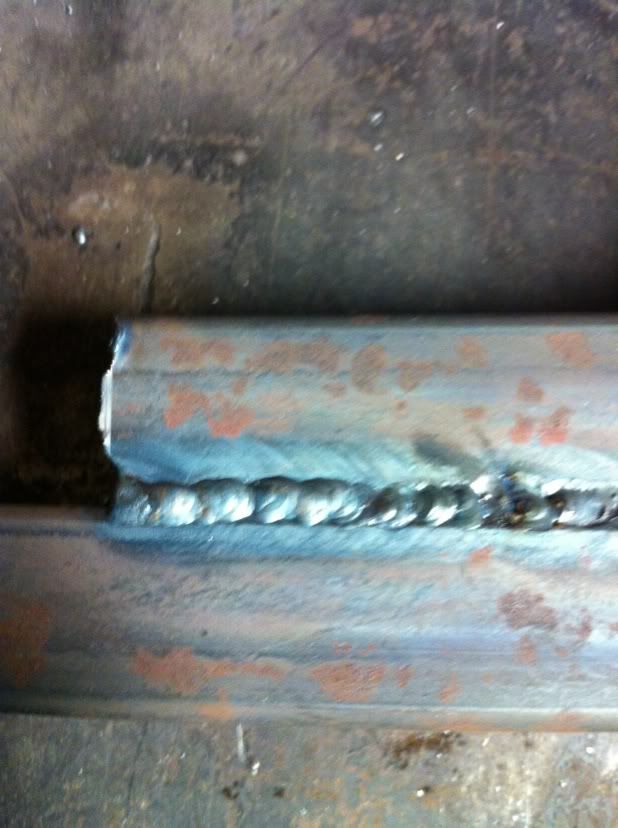

and today i finally got some training from a friend to get a jump on my new summer internship: TIG welding
heres how i started out on
round tube
square tube
big gap square tube
round to flat
and heres how i was doing at the end of the night, pretty decent i think, but nowhere near perfect, but I'm excited to keep learning
round tube
square tube
getting good at flat stuff, round tubing needs a tad bit more of work, getting that "stack of dimes" look is really difficult haha

Round tube is by far the hardest to learn. What size filler are you trying to use? Looks like it's way too big and you're having to use a ****ton of heat to get it to go in.
For thin stuff, .035-.045 filler is gold. You'll get the hang of it, just keep practicing!

i was using the thin wire and big wire, the big wire was easier to handle, but the thin wire obviously was easier to melt, the last few welds were with the thin wire, I'm thinking maybe i add too much filler, he told me i need to get my mind out of the mig state of mind and not build the welds up so much.he had me welding with the pedal at full "throttle" it was pretty thick steel too, he builds race cars, so that was all left over rub rail and axel mount tubing, can't wait to keep practicing though, i think I'm gonna try and pick a tig welder up once i start working again so i can just practice, the place I'm going to be working is not gonna have me TIG to start I'm sure, but i think it helps me understand how well things need to fit and so i can maybe tack it together
