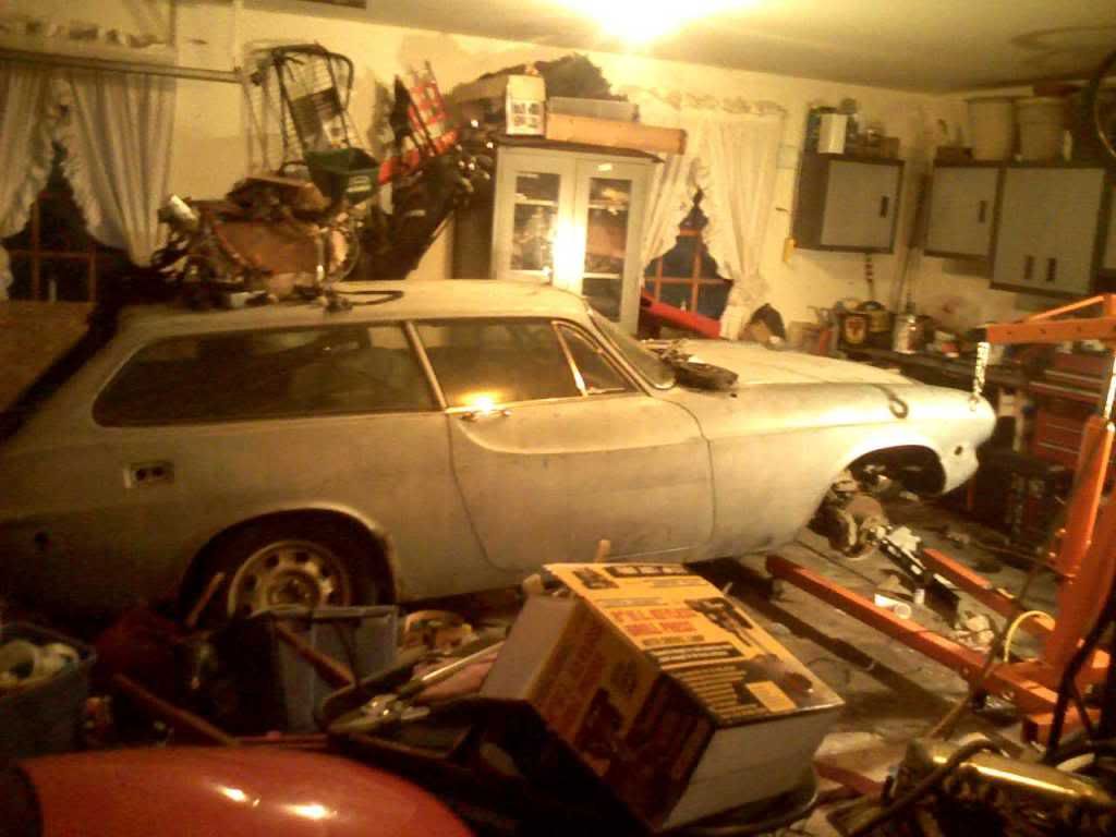

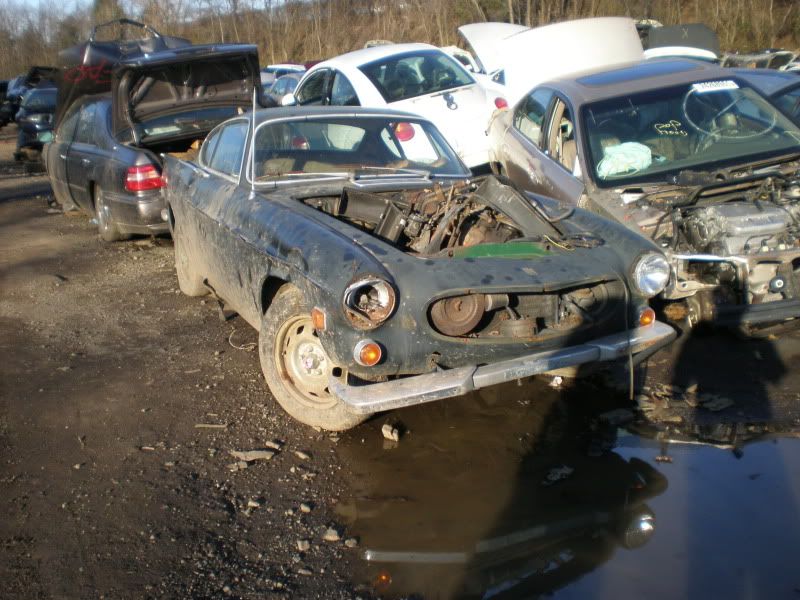

Originally Posted by Ender81 View Post
On Broadway about a mile down from PJ's on the left. It's parked outside on one of the side roads that shoots off at an angle. If I had any extra garage space I would have checked it out.
my grandfather saw it too, its pretty nice!

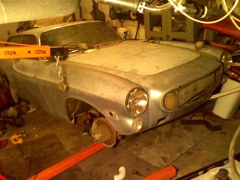

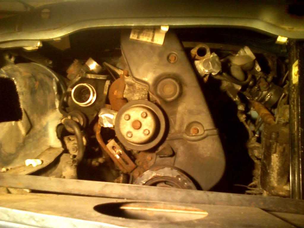

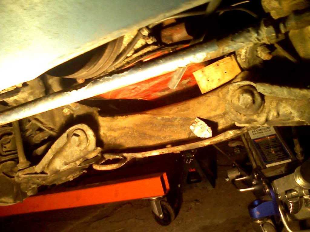

wow its been too long, i need to get my butt in gear..... regardless i finally had a few hours to tinker with the car. I've been struggling with getting the engine to fit and the intake to clear the steering shaft. I'm not sure why i didn't just do this in the first place and the first thing that comes to mind K.I.S.S.- keep it simple STUPID! in this case I'm the one who was a little on the stupid side, why i thought i needed to modify the intake to make it fit when all i had to do is raise the engine and trans 2 inches ill never know, the important thing is i figured it out the easy way and saved myself about 1000$ ill have to make new mounts and redo a few other things which is no big deal. enough with the blabbering. on with pics
how it sits, looks almost the same
LOOK AT THAT! IT CLEARS! finally!
just a look from the front
how i raised it, keeping it simple....stupid
got the hood on to make sure it still fit correctly, finally got to see it in full body form
and the whole car in its "little" corner today finally got me back into it and motivated

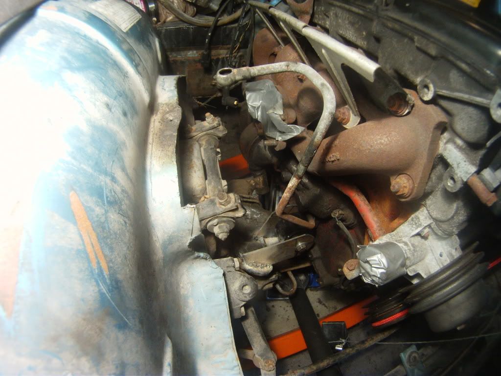

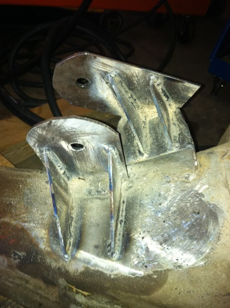

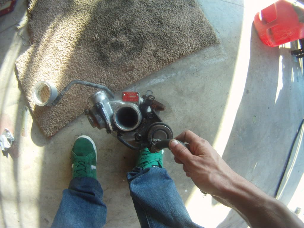

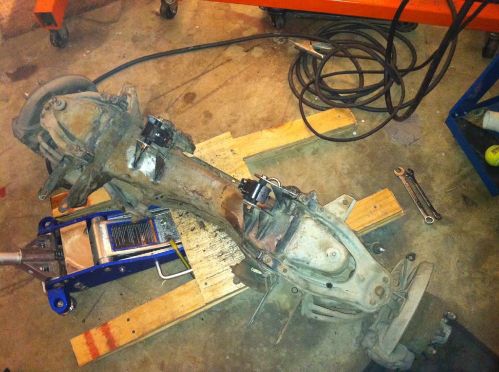

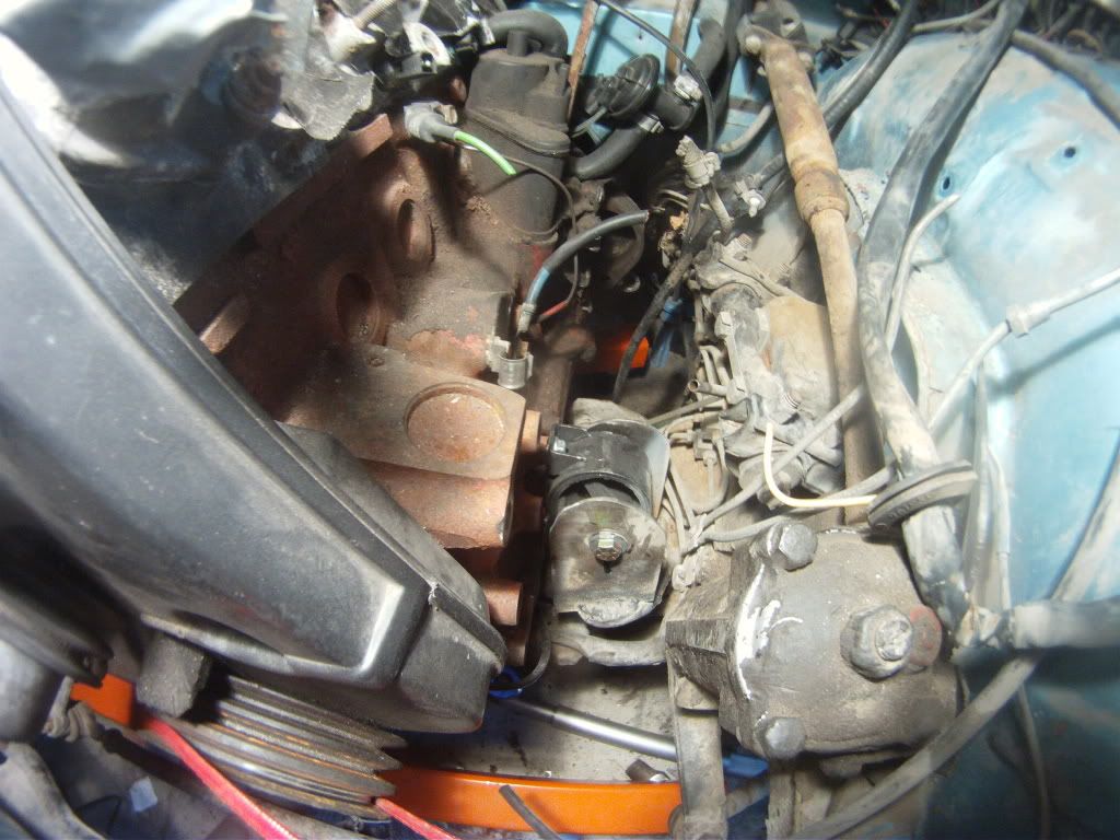

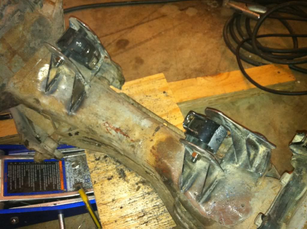

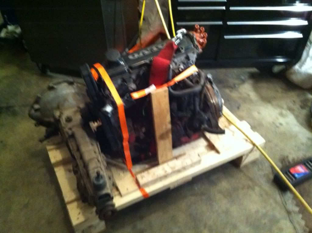

wow its been almost a month since I've been able to work on this, with working 30hrs a week and school for 20+ I've had almost no time to even look at this thing, but now my engine, and chassis/suspension class ended, i only have brake systems class til 10am, and don't work to 2:30 most days, and this past week I've been going for my PA state inspection license, so i had the whole week off, so from 10:30am to 5pm I've been busting my butt. any way.............
ENGINE MOUNTS ARE DONE!!!!!!!!! well kind of, i only have a flux core welder and although the welds are strong and support the engine i still will be taking the car back to the body shop in which i worked to weld in supports as well as pass over and weld the back side of what i have done. but its in there good and should absorb the vibrations since they are rubber insert mounts. still need re tweak the factory trans mount since the trans is slightly angled downward, not much maybe a few degrees but it should be taken up in the driveshaft since its 2 pieces, time will tell, I've been researching mega squirt and thats the route i think I'm going to go with, its cheap and it will get me the most power out of the stock engine for the cheapest. i want 200whp, and right now this engine does about 168 stock on 7psi, so I'm hoping to turn the boost up to about 12 or 14, the turbo is capable and it should put me where i want to be. anyways on with the pictures,
driver side
passenger side

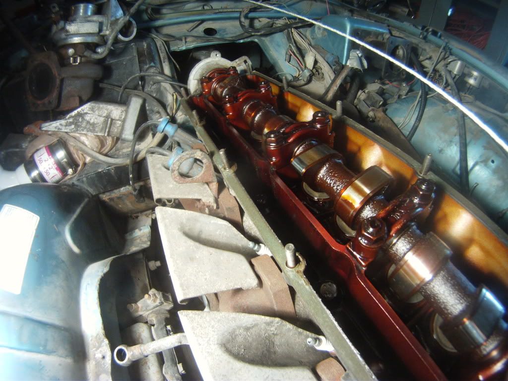

i also took my valve cover off to start inspecting the engine for rebuilding it, it appears i may not need to, the cam and the followers are in like new condition, i still am going to at least pull the head to look at the cylinders and valves since i still have no idea how many miles are on this engine, but it appears that it either had low miles, or had recent head work done, or was just REALLY well taken care of, the donor car was beat up on the right rear qp that could have been from an accident *crosses fingers* but also could be from the easy pull guys ****ing it up with the forklift. any way heres what the valve train looks like
and had the turbo off to weld the mounts, it too seems to be in great shape, i wanna drop it off at fuel injection and have them look at it, if its no good I'm gonna put a 30R on it ;)
baby turbo

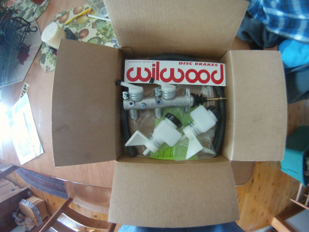

new parts on the way, just dropped waaaay too much money,I'm just gonna keep telling myself its my birthday gift to myself
first up was a mishimoto performance radiator, its 2.5 inch thick normally for a honda civic si, i figure with the optional fan shroud kit ill buy for it later it will be more then enough to cool the engine
next i needed to change my brakes to manual because the booster no longer fits i went with dual wilwood 3/4 bore master cylinders and a jegs 7.0:1 ratio brake pedal, the stock master cylinder was 7/8 bore with a 4:1 pedal ratio, the new setup should be more then sufficient to slow the car even at fairly high speeds

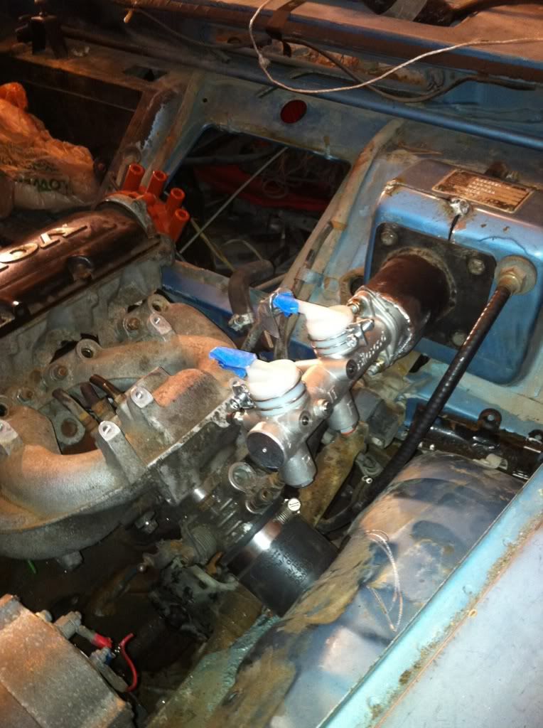

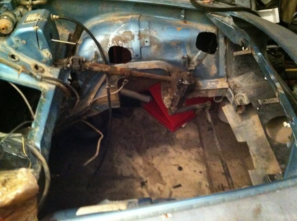

update time yay! have been spending quite a good deal of time planning things out and trying to get things to fit, cut a big ol hole in the floor to try and get my master cylinders in but turns out it just won't work, one would be in the wheel well and the other in the engine bay, but so far down that any type of brake fluid related nonsense would suck! one thing i hate more then anything is poorly designed car parts, and if i can help it, anything i make will be simple. so i bought this:
remote dual piston master cylinder, uses reservoirs that are connected to the master cylinder with a hose, so the MC can be down in the problem area while the topping off the fluid area can be easy to access. and was at the junk yard the other day for my dd and dads car so i picked this up
factory alternator, my engine was robbed of its from someone else, once the brakes and alternator get mounted ill be finished tabbing the engine bay up and i can begin to shave the bay and get it all nice and painted and work on the engine running!!!! =] my goal is to have it drivable to the sonic meet in may!

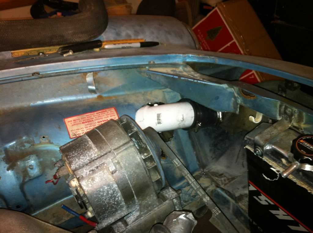

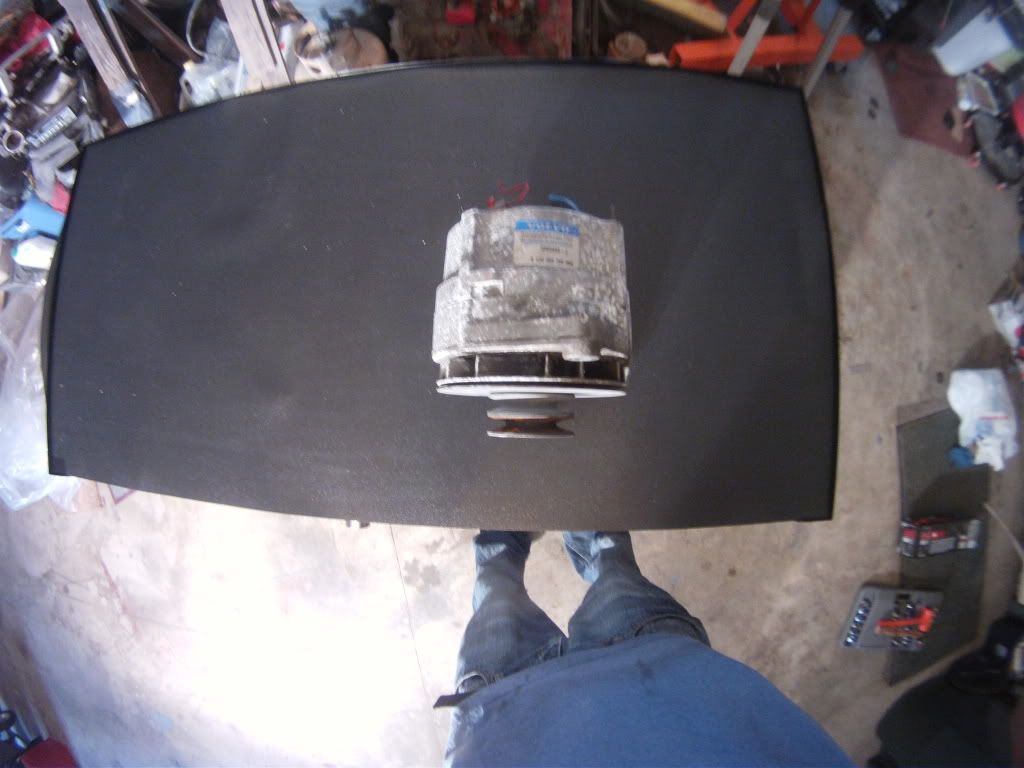

finally got out to the junk yard today to get my missing bracket for the alternator,i think it marks my last trip, waaaay too cold out.
then i mounted it, even got a belt on that i had laying around, just need to make it slightly adjustable to tighten it up

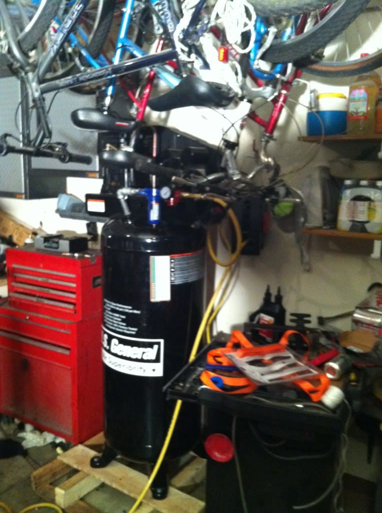

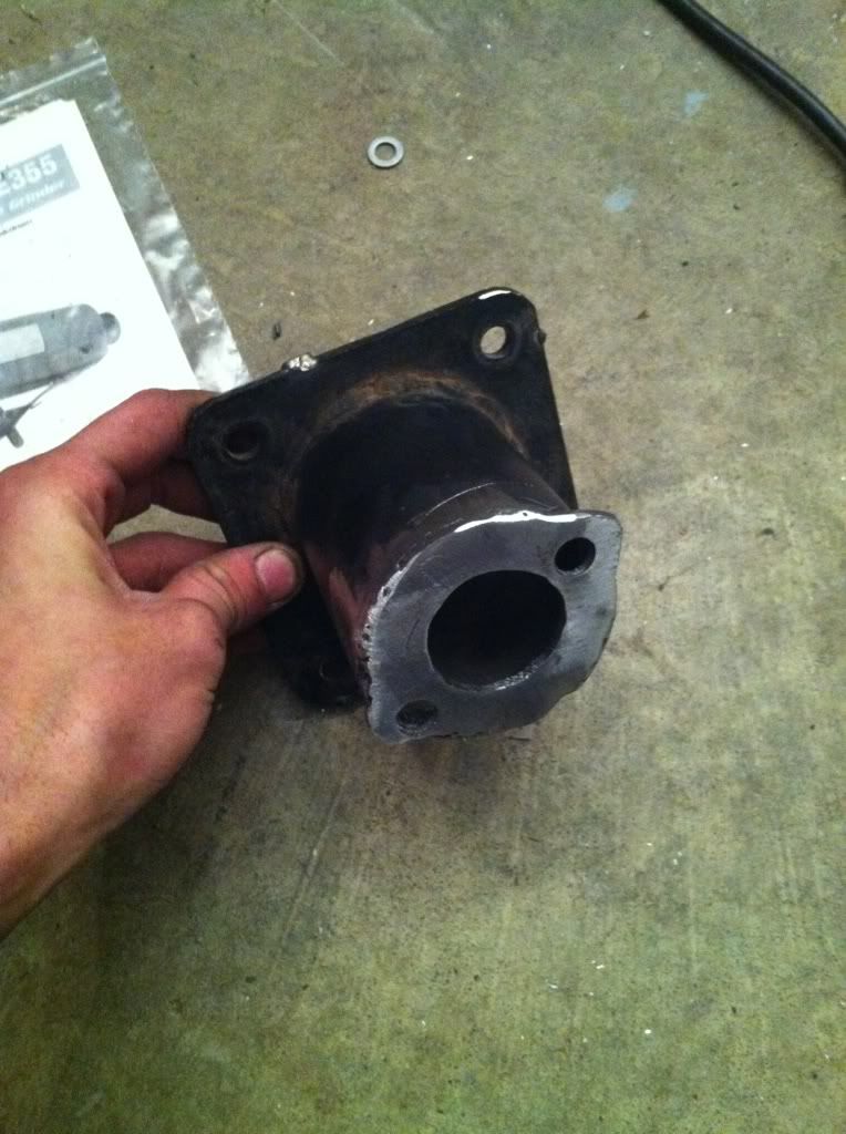

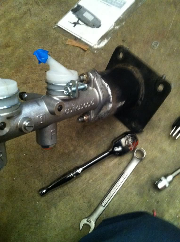

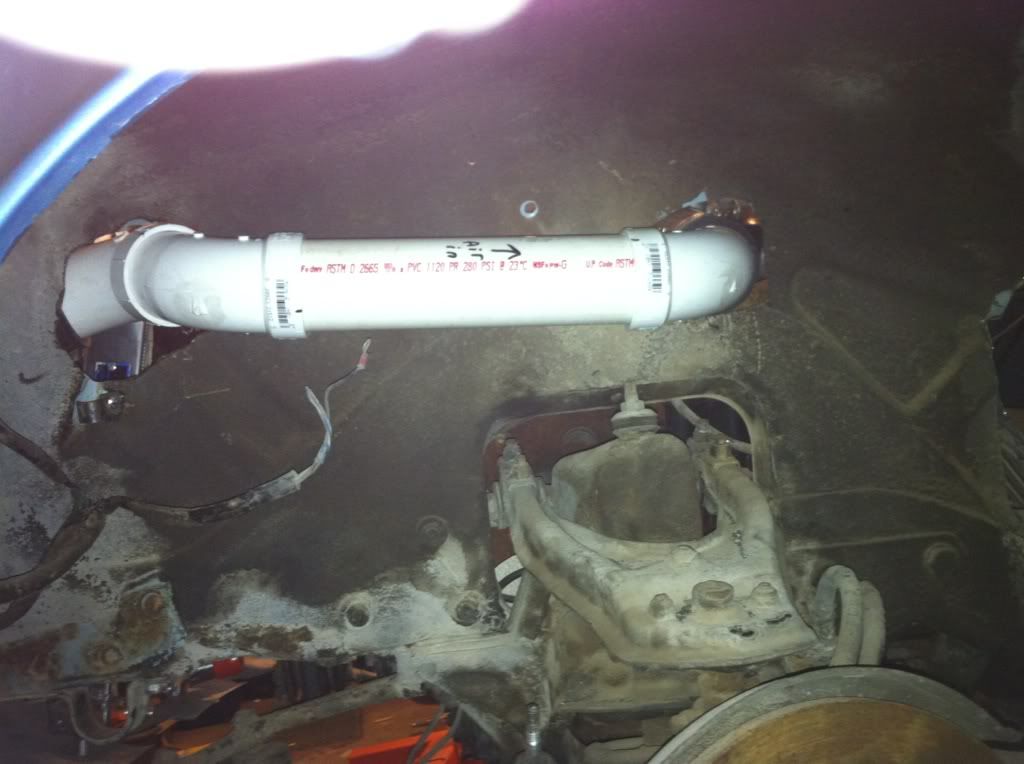

big update, mock up is complete! the girlfriend was with her friends tonight so i made use of my time after work, now on my next day off i can get the engine out and rebuild it and paint everything up real nice. yesterday i spent my day wiring up our new compressor. yes its from harbor freight, but our old one lasted 2.5 years and worked great, this was a free replacement/upgrade under warranty. 60 gallon, 3.5hp.
then i took advantage of having use of my air tools again and smoothed out the flange for the master cylinder and welded it to the spacer
fits perfectly on first try
and mounts up as planned exactly how i wanted and works flawlessly

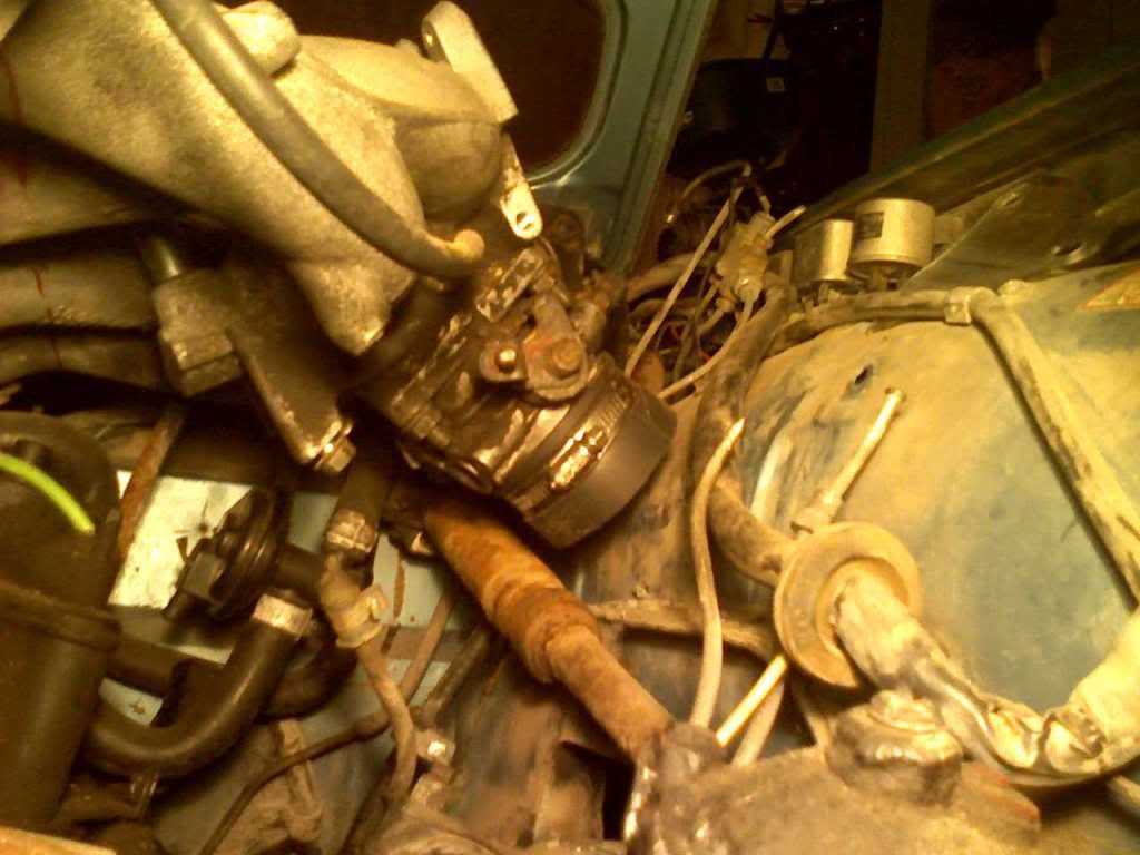

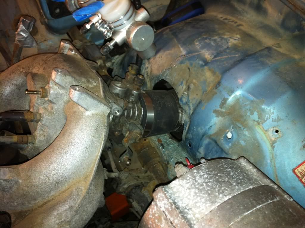

that was one of 2 big things needed to finnish mock up, the last thing was cold side intercooler piping i had debated about pounding in an area so to speak and keeping the piping in the engine bay, but i figured it might not be a bad idea to run it through the wheel well, so thats what i went with, i think it actually turned out really nice. ( i will close the holes up to make it more flush, i just was guesstimating with my die grinder.
pic of it running throughout the well
leaving the inter cooler and exiting the bay
entering the intake
and thats it, i just have to make sure the alternator is adjustable for belt tension and look everything over real good and begin on the fun stuff. getting yet even closer to having it running, its a great goal to reach, so exciting, thanks for reading
