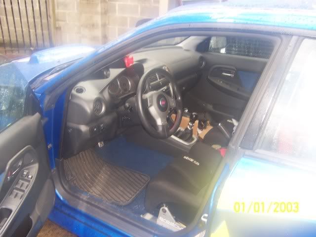

Have a VERY rare set of wheels from then UK coming. Hopefully will be here in a few weeks. Here's a pic of the interior right now. All the money I had went to these wheels, so i'll be looking out for another set of either 99-01 RS seats or some 02-03 WRX seats since their both fairly cheap. Here's a pic of the interior right now as it sits.

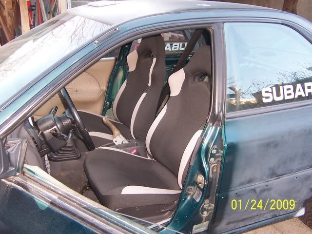

As a handful of people know i've be hot on the trail for a setof JDM seats for about a year now. As I was doing a session on eBay I came across a set of what I believe are Ver.4 WRX seats. Got a smokin' deal on them from JDM-hot in California. Highly recommend them, shipping was super fast too.

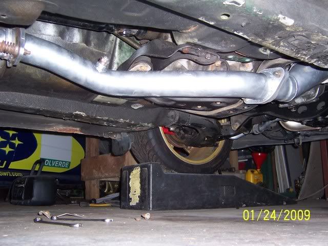

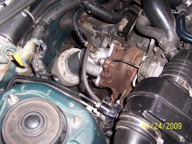

The past few days the weather hasn't been TOO bad I decided i'd go mess with the car. The Prodrive downpipe had what looked like to be an EGT bung so instead of getting an 02bung welded in I drilled and tapped the EGT bung to an 02bung size. Then took off the JDM one piece and put on the Prodrive. Was a very nice addition to the car, it's quite at idle but with WOT it has a very nice rumble to it.
Along the way I bought a Prodrive rear diff protector for the car as well, that went on yesterday. It is by no means as strong or purpose built as the OEM one but it's a very nice show piece.
