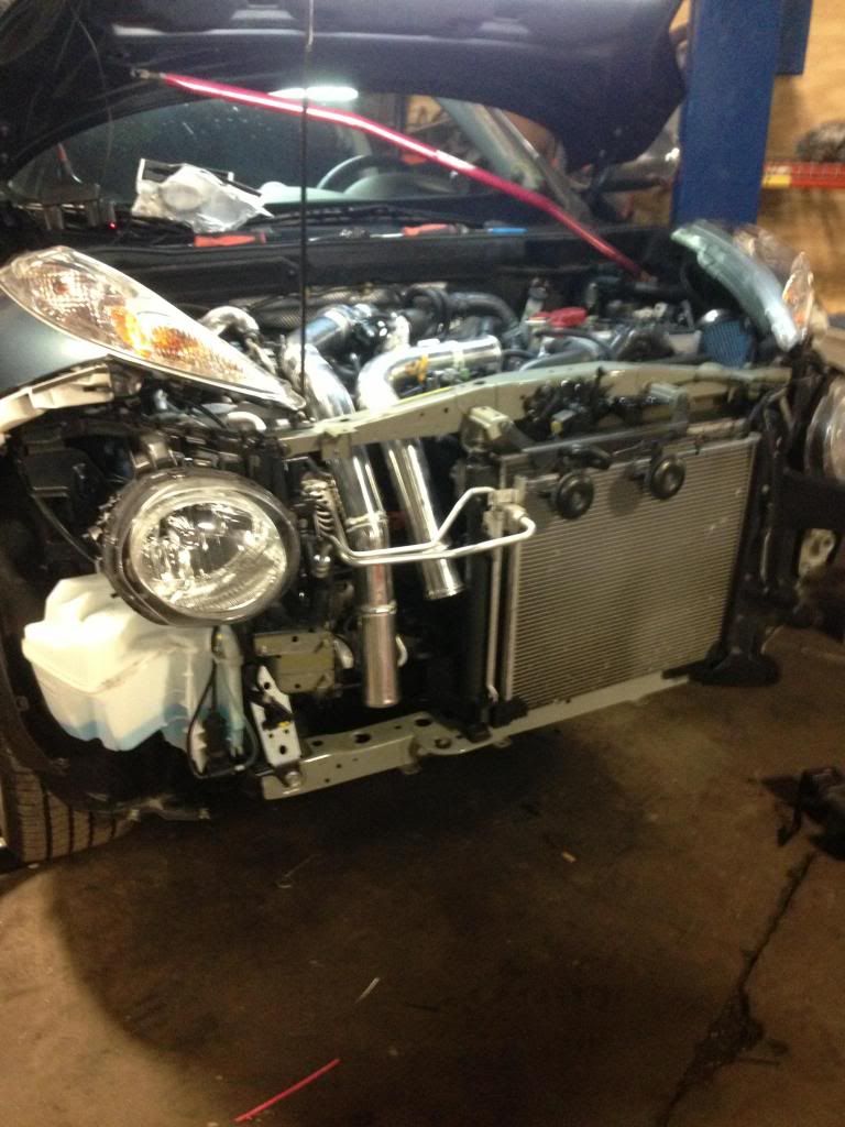

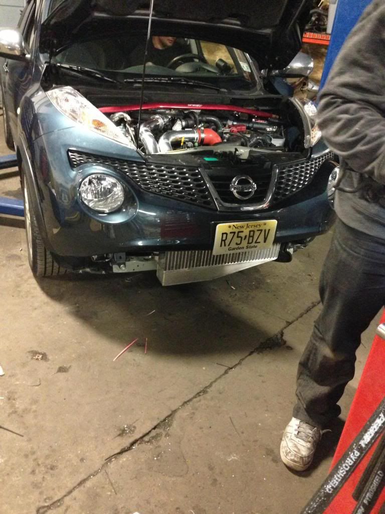

Well after another very long night at PSI PRO, and a problematic boost leak, the Juke finally seems to be running better with it's new custom front mount.

I appreciate and respect you making big strides on modding the Juke-- it is definitely unique. That being said, I think that custom front mount looks hideous.

Trust me you are not the first to say that. I have actually gotten a lot of negative feedback on the overall look of the FMIC so far.
It is such a uniquely designed front mount and so much went into making it and mounting it (the mounting brackets are absolutely nuts, I forgot to get a picture of them though), that I had a feeling I would be sacrificing something somewhere to get it to work right, and the sacrifice came at the expense of my lower front fascia.
While I am not 100% pleased with the overall look of it, it had to be done this way for protection issues. Will it stay like this forever? Not at all. I plan on coating the bottom part of the IC that's sticking out black so it blends a bit more. For right now, it works just fine for me. Everything that I want covered is covered.
I'm sure 90% of people will hate the way it looks, but I think that same 90% will go "WTF?" first when they see it, though I don't think they will all share the same respect for the effort and money I am putting into this car like you do WRXD. So thank you.
Right now, you could call the IC project "Function over Form", but the engine bay looks fantastic with all the new piping and the vanjen clamp. The way I see it, I could have gone a cheaper route and just pieced some pipes together with a a normal FMIC, used a ton of couplers and clamps and been done with it. I took the extra steps to make this unique vehicle more unique with a one off setup that is in my opinion, quite impressive.
I know everyone who worked on this project at PSI PRO are proud of it, even if it was for a FWD Juke. I also know that if I ever bring this vehicle back to PSI PRO and say to Travis "I have a new custom project I Want you guys to do" he may seriously throw my ass out, lol. Thankfully, this is the last big one off project I will be doing for a long while. The turbo upgrade will be bolt on, and clutch while custom will still just be a clutch job, and the brake upgrade will be more or less bolt on with some dust shield trimming.
The really hard parts are over (until an engine build comes lol), I am getting to that point where I can really sit back and enjoy the car, it has a lot more power then a Juke (with a stock engine) should, it handles great, it sound great, and it is so much fun to drive now.

Add a Lip to cover the bottom of the core and it wouldnt look nearly as bad.
But I'd be one of those people to say **** yeah keep on modding that thing...Who cares what it looks like.

Bummed i didnt get to make it by saturday to check it out, but i think by blacking out the bottom of the fmic and/or adding a lip would look awesome. Post up a better engine bay shot now that its done!

Yea, at some point in the near future I will clean it up and make it look more presentable, but for right now I can deal with it. Once the weather clears up I'll snap and post up a good shot of the engine bay.
