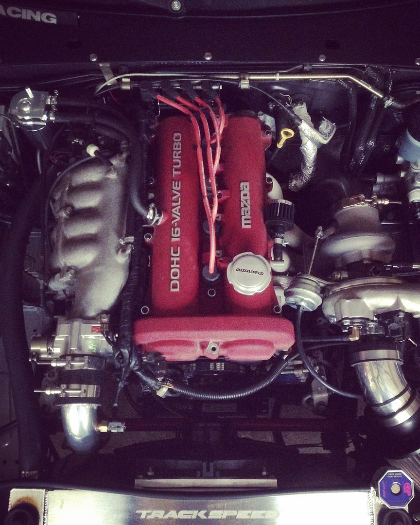

So picked it up from the tuner. Feels good except the spark issues. Basically part of it is the COP system itself not being designed for high boost, but another is that we are running it in wasted spark mode. If we wired it sequential we could get a few more PSi but I don't like being at the limit of anything. I want to hopefully create a GM based setup over the winter. Basically it breaks up the spark. Others have reported this issue so the FAB9 setup will be for sale. It would be great for someone with a stock turbo but at this point its not cutting it for me. You can hear it in the speedo video below. Besides that the car pulls hard and feels fantastic! I'll take it back once I get the new coil setup and it should have no issues.
https://youtu.be/46MeP98gEMk
http://youtu.be/QTileixY38Y
311/285 on 17psi <---last tune
328/308 on 20psi <---current tune

That didn't last long. There was a price drop on the coil overs so I got them ordered yesterday with their standard rates of 700lbs front and 400lbs rear. That comes to roughly 12.5kg front and 7.5kg rear. Seems super stiff but everyone that gets them says they ride amazingly and handle the same. Also got the new ignition system which will use GM LS3 D510c coil packs mounted to the firewall, those bearings, hubs, and studs as well.
Looks like I'll have a bunch of stuff to put on in the coming weeks
Details on coilovers are here: http://949racing.com/xida-coilover-miata.aspx
Details on coil packs are here: https://www.flyinmiata.com/big-spark-kit.html

So a few more new things.
New GM Ignition system is being installed Saturday

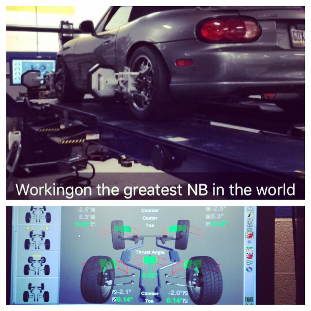

Coilover wise, with the 10" wheel it might be tough to get the ride height I want. I am aiming for 949Racing's Race Alignment
SuperMiata Race Alignment
The Race Alignment is intended to win national championships. YRMV
Best suited for high grip tires such as Hoosier DOT, Toyo RR, etc
<=12.0"
3.75~ 4.5" front pinch weld height. Xida's tend to work best for competition use with front pinch weld height close to 4.2".
Front camber: -3.5° (or as close as you can get to it)
Caster: >+4.5° or max available once you reach camber targets
Front total toe: 0
Rear camber : -3.0°
Rear total toe: +1/16~1/8"
The lower I can go the closer I can get to those camber settings. Going too low will cause issues with the 15x10. That's a tightrope I'll have to walk next year since the wheels won't be available until Mid-January, so realistically probably February or March

Ignition is in
Nice and neat just like I wanted. Runs great. Took it for a sprint to ~140 and it didn't miss a beat!

So last minute I swapped the NB louvres for the NC ones, just have not installed yet. Alignment is done
Few issues to deal with however. When my friend was doing the alignment, he was able to get close to -3.5* front camber on one side, but only -2.5 on the other due to a bent tie rod. He said he recommends replacing both, and said the inners might be a good idea too. At that rate, he said it might be easier to pull the rack (and also de-power it properly), and add poly bushings to it as well. How does one tie rod turn into a steering job luckily he can take care of it all.
Also have a bit of rust forming on the bottoms of the rear rocker panels so that will need to get fixed somehow, probably a cut and patch job.
Installing my old coilovers on my friend's car this week. The new ones ride amazingly considering they have almost double the spring rate up front vs the old. On the softer damper settings, it legitimately rides like a BMW. On the firmer settings, it has a firm ride, but not stiff like the TEINs did. Really a great setup. Handling is superb, from what I can tell in this 50 degree weather with my slick tires haha
