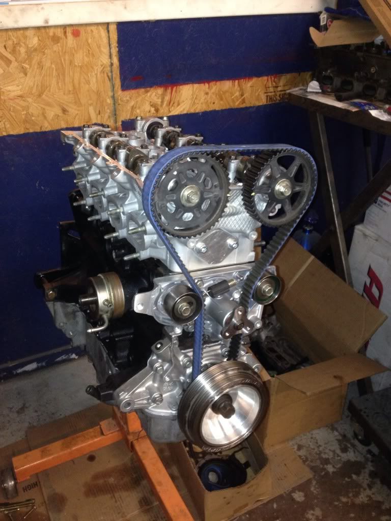

Moving along. Did a leakdown test too and got 96% with some oil down the hole. Motor hasn't even been started yet :-)

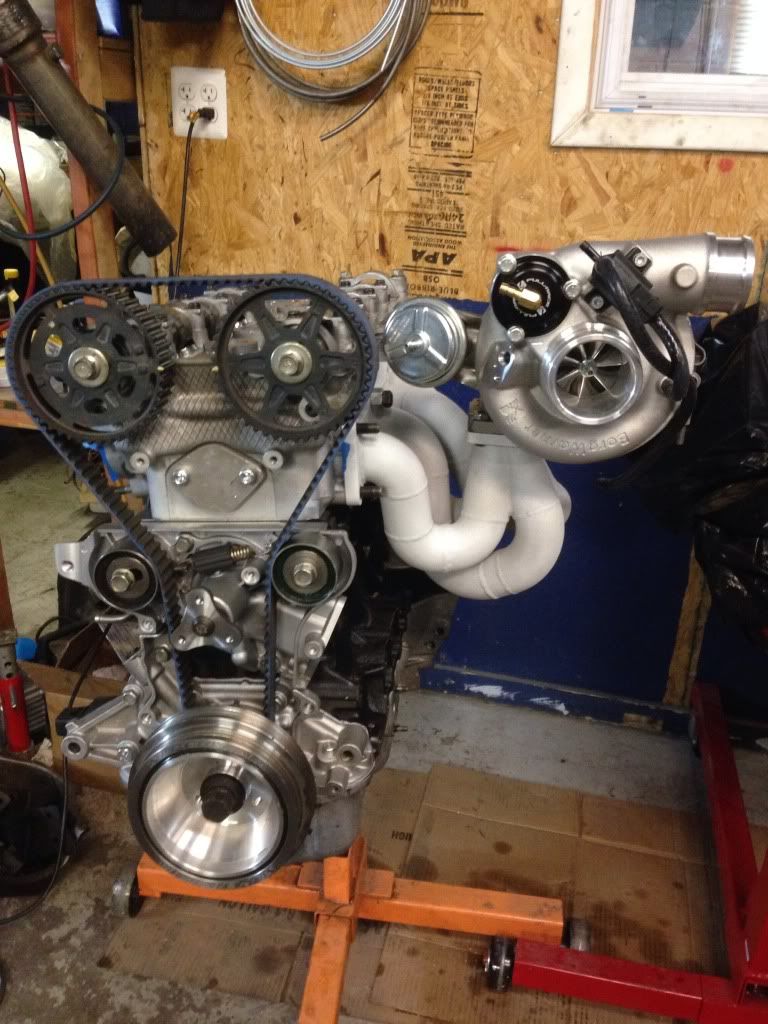

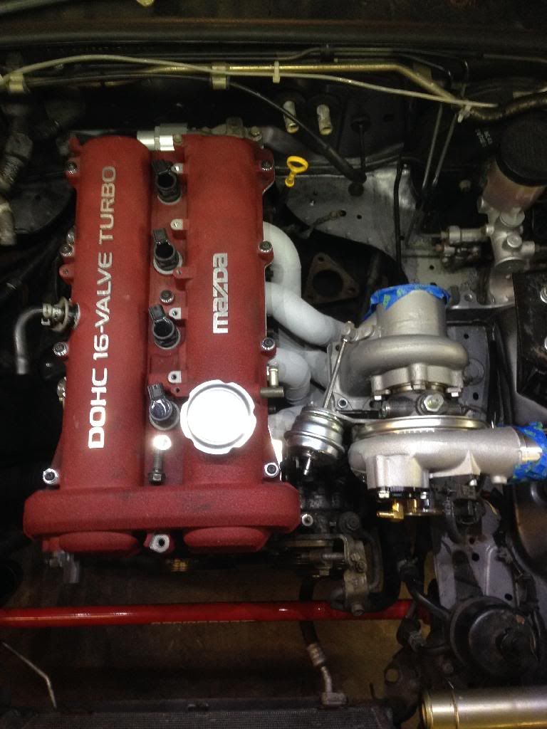

Finally got this mocked up. I love it. The turbo just hangs out there

Worked on trying to set my valve clearance. Looks like I'll need to buy 8 shims or so. After some shuffling I got my intake side very nicely in spec but exhaust is all over. One measures as high as .016. I had an intake at .002 initially but managed to get it to .007
Still haven't made oil lines and such, probably going to do that with motor dropped in car. I don't want to make lines and then realize they're in the way of something.

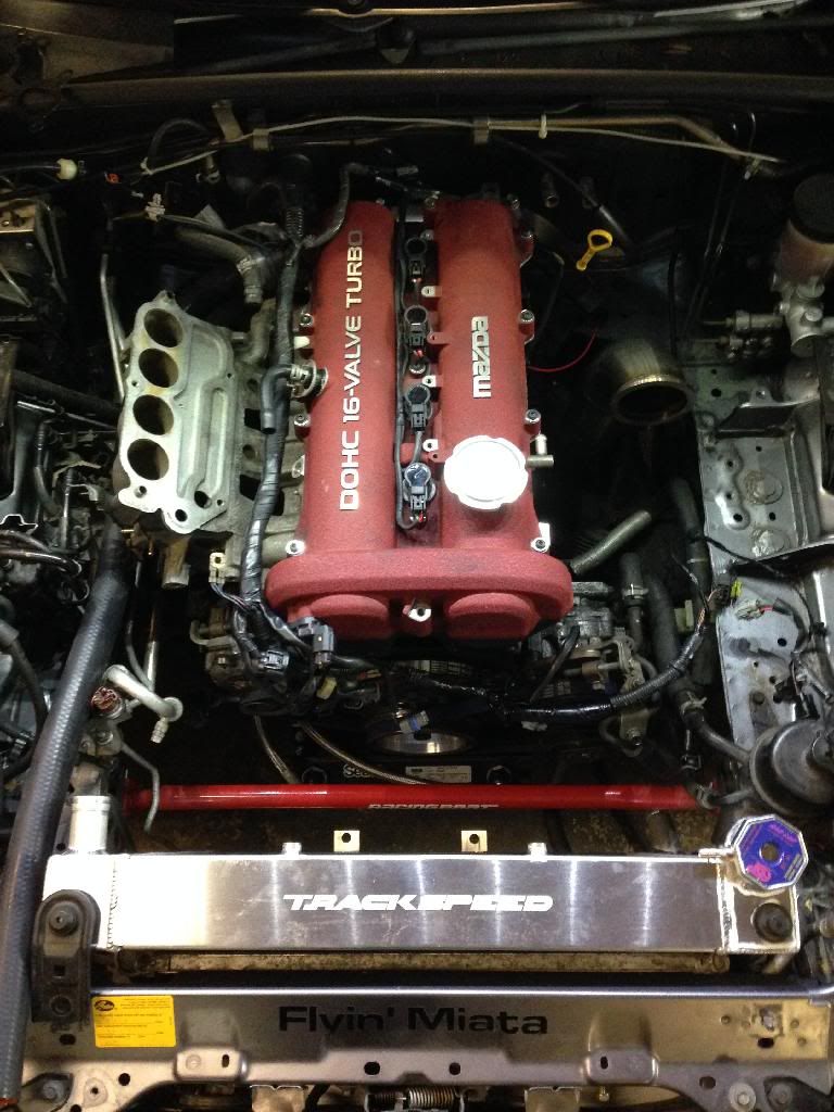

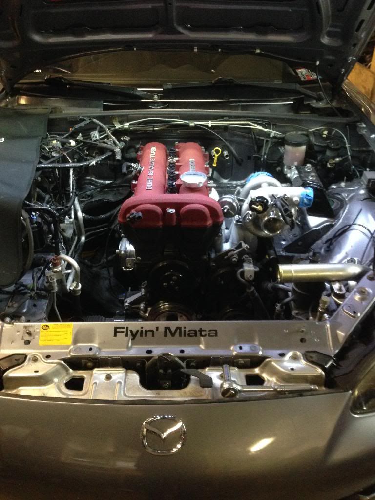

I can have a happy new year since we finally got motor in car today
Also got some blingy valve cover bolts since mine were somehow lost.* Also showing the fab9 cop kit

Looking good pop, love the choice of the BW. down pipe clearance looks a little tight?
Just a little between the steering column and the trans, but it makes a pretty quick dip down right out of the turbo. We mocked it up with the new downpipe yesterday and just need to adjust some of the exhaust hangers out back and it will line up.
We'll have the whole system dropped to do the diff so perfect timing.

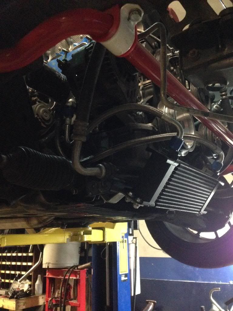

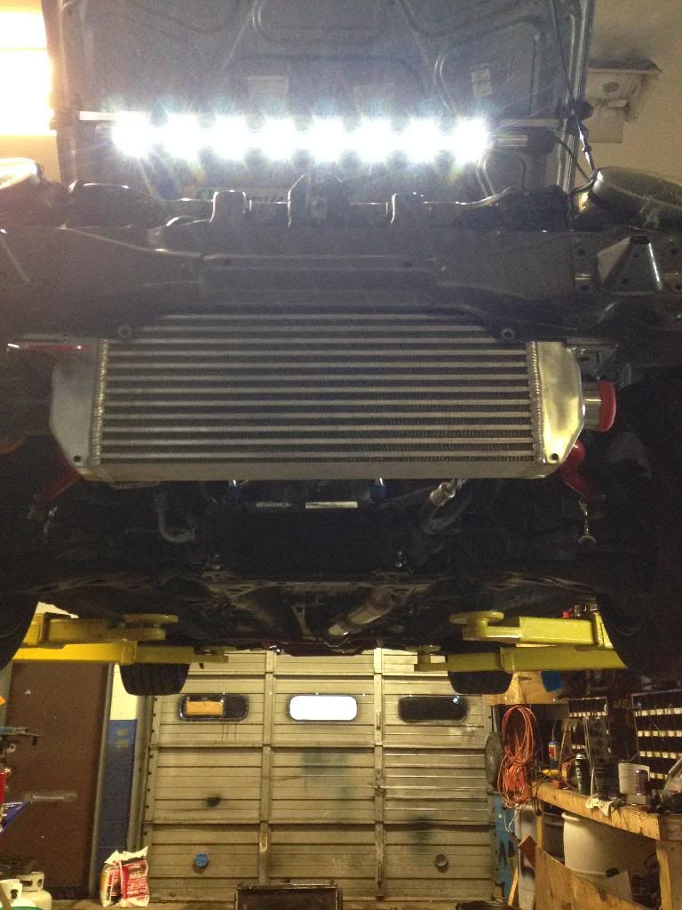

Old 01-04-2014, 09:48 PM   #4256
Intercooler
Oil cooler
