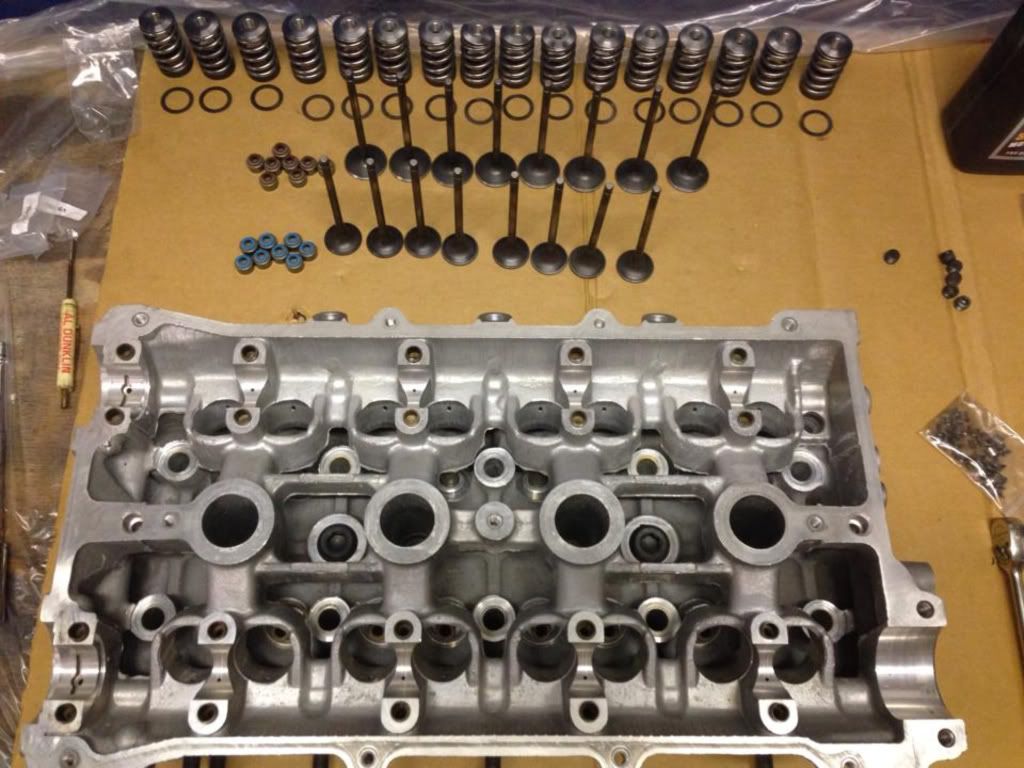

Got that put together yesterday. Not too hard except for putting in the little keepers. Lots of grease to hold them in place.

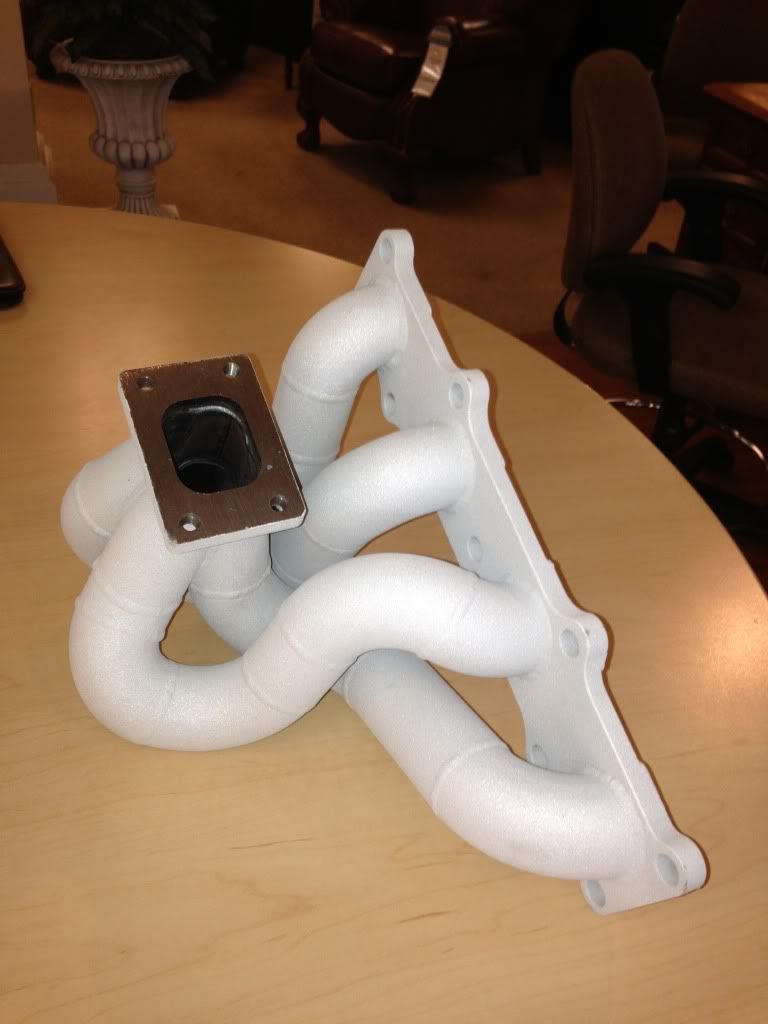

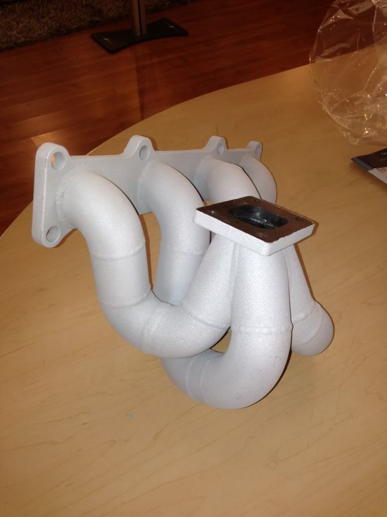

FINALLY got the head finished the other day. Quite an involved process overall, easily twice as much work to assemble it vs the block. You can also see we made a blockoff plate for the front of the head for the coolant reroute. Will give lots more room for the 3" Radiator
The manifold had butterly flaps from factory. These are useless with the Megasquirt installed and are a restriction so out they came and JBWeld in their place.
Almost ready to make a longblock and start mounting manifolds and creating feed lines for the EFR. Still have to install the massive radiator also.
I'm beyond excited to mount the head on the block, put the manifold on, mock up turbo, and see how its all going to look together. I decided to keep the Manifold Swaintech white and not go over it with anything else.
