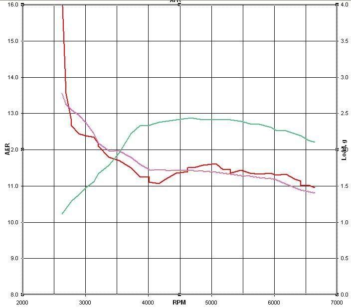

Heres a visual example of how a wideband helps you tune... This is from when I first installed my 16g. I was working on an issue where i was getting odd readings richer early on, then leaner than what my fuel table called for.... I would have NEVER known the severity until I had wideband, because the stock 02 sensor peaks at about 11.5:1
