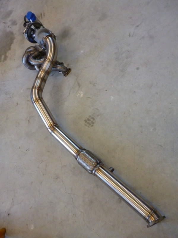

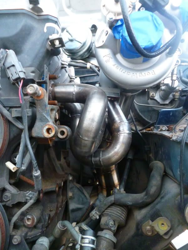

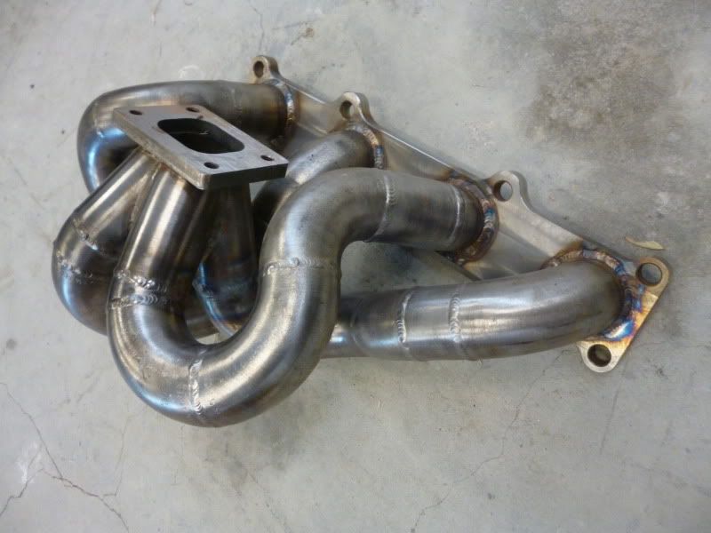

Manifold to be done next week, then off to Swaintech.

Next orders of business
Turbo: manifold to be done in a week or two, turbo is on hand and will need to build oil and coolant lines and FMIC pipes. Need 8.5mm Magnecor wires too. Inconel studs? Other suggestions?
Cooling: Tossing around a 76mm TrackSpeedEngineering Dual Row Crossflow unit, pretty much guaranteed not to have problems from there
Handling: Racing Beat 1.125mm hollow front sway, stock rear sway, Racing Beat endlinks all around
Brakes: Raybestos Advanced rotors (cheapness), SS Lines, Hawk HPS pads waiting to go on
Maintenance: Need a shorter alternator belt because my tensioner is all the way out and it squeaks.
Also need to buy an engine under-tray and reinstall cause mine has been missing for a while and I'm sure it helps cooling somehow. Depending on finances, this might all get done in one shot with the turbo install, I'd certainly like to get the Radiator in while fabricating pipes so there's no issues with it fitting after the fact.
So far about 350 miles on the motor. Need to add cranking fuel to get cold starts better (if I prime the pump 5-10 times it fires up quick, otherwise cranks forever). Runs great otherwise, fluids are looking great, even MPG is decent now that we tuned the map better. I'll post some tables here later.
