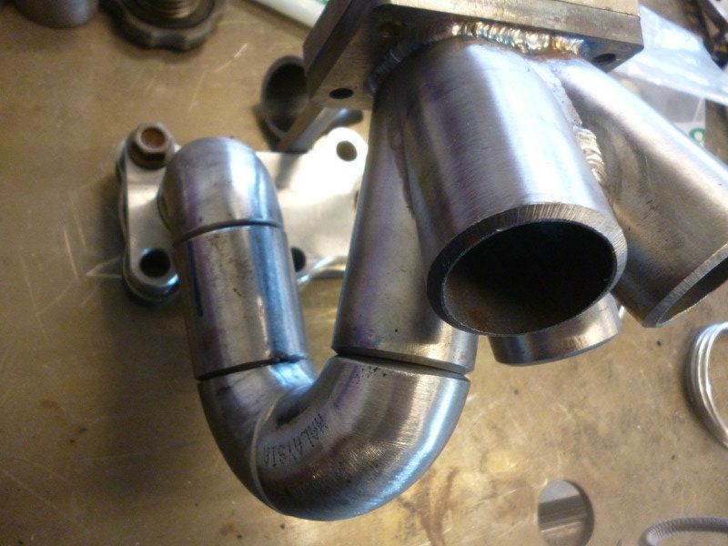

Its not just some bo bo vendor using cheap metal to save money, there is a lot that goes into this stuff that the maker knows. As far as malaysia, steel of one grade is the same as steel of that same grade no matter where it comes from, or it would be a different grade, no?

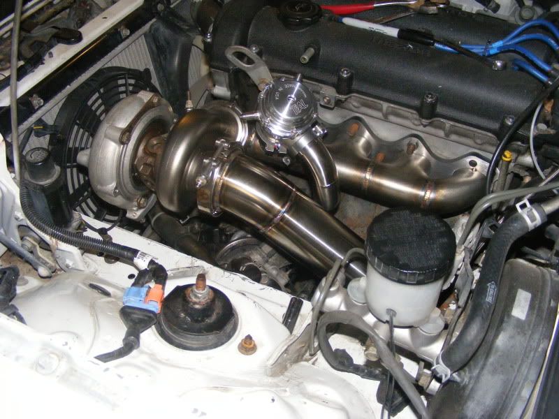

That's about what a local shop would charge. It's an odd turbo to place in the bay so it would take some time to fabricate a manifold. He's already made a handful so he can do it quicker. Also his equal length manifold should provide more top end power, and clears AC and PS, not saying a local couldn't make it but I trust him based on what I read.
Spock's Miata manifold
He also happens to have a Miata himself, and I hear much of the work is done on the car to ensure fit every time. Also, if any of the welds break, he will repair them at no charge. There's really no pre-made solutions like I could find for a standard size t25 turbo, basically EFR needs custom work all around it so things can be pricey.
