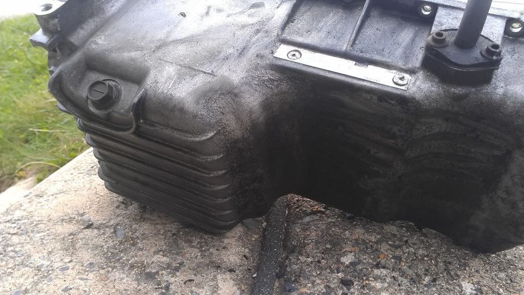

Also a pretty funny thing I found out. It turns out the vin on the oil pan doesnt match the car so the engine has already been swapped once before, so sometime before 35k miles. Its highly unlikely that someone just changed the pan, there'd be little reason for it
If the car was low enough and the oil pan got smashed, then it would need to be replaced. I have a friend who smashed an oil pan on his Eclipse and his 240, it's not that uncommon, happens more then you think especially with really low cars.
I thought of that too, but the car was bone stock, stock height, etc.

On the oil pan subject, I made the mistake of forgetting to distribute pressure on the pan when jacking my motor up on my mr2 back in the day and it pushed the pan in pretty good and I had to replace it.
Could have been something as simple as that

Heres the pan
I'm also wondering what to do for oil and coolant lines for this new turbo. Should I convert everything hooked to it to AN fittings? The oil drain on the EFR is a -10AN standard so I'm getting my pan prepped for that line. I'll be running ~20psi

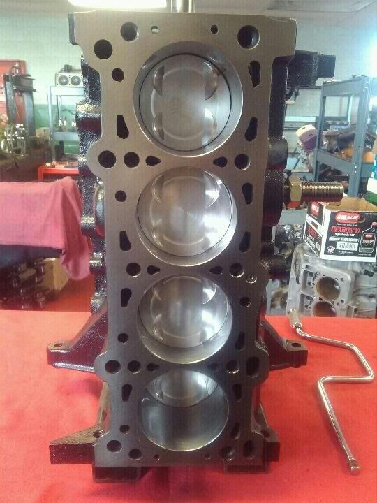

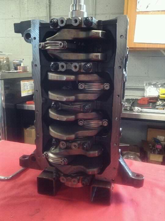

A few snaps from the machine shop, last time I'll be seeing this stuff

Shop started engine assembly. I think what I'll do is as soon as I get the funds needed, I'll start piecing the kit together. ExtremePSI has the Precision 600HP intercooler which I might just get now, as well as a pipe kit, and start piecing it together. Then I'll get the turbo and work on the oil and coolant lines, at least fitting the AN stuff together and getting my conversion fittings (also ExtremePSI). Someone also suggested taking the stock PCV (since Im going with a better one) and sticking it in the line that goes from the catchcan to the oil pan. This way, oil can drain down, but never come back up into the catchcan and intake. Thoughts?
